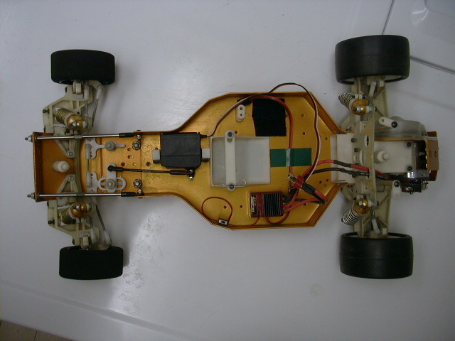

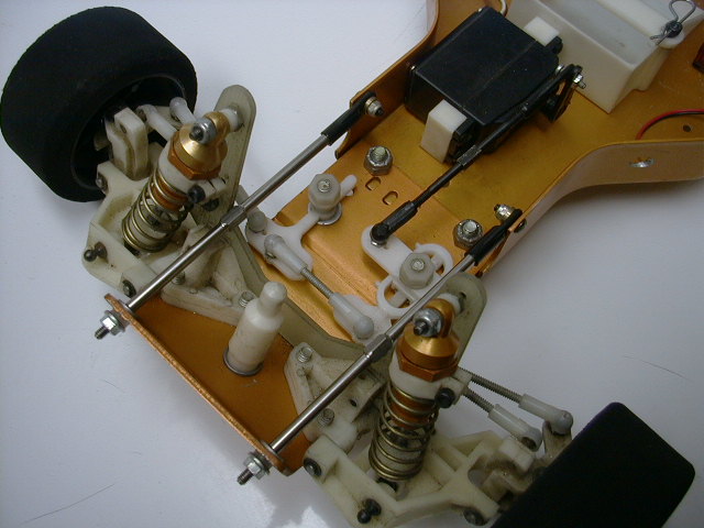

I made one last year and have a couple of things that may help.
1. you should have the body that you want to use, to get the fit right. check the wheels at full cocked left/right, mine rubs some if the body isn't just right when the shocks are compress.
2. slide front nose plate back into buggy for correct wheel base, mark chassis for cut. I used a drumel with cut-off wheel then sanding drum to smooth it out.
3. you may want to leave the original holes for the nose brace tubes, and cut the front off the tubes and retap them. other wise the nose tube line up with the cruve in the side of chassis. See pic below should of done this on mine.
4. you may want to cut the hole front off not just the sides as I did. The hump on bottom of nose plate causes the nose to stick-up more. Again see pictures below I should of done this to mine.
Good luck! and if you need more pic, just send a PM.

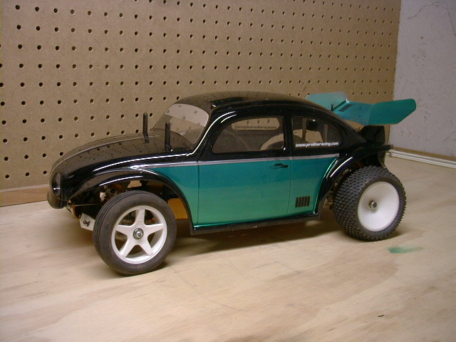

Re: baja bug
Proline Baja. I don't know how to create link but it's discussed in the buggy forum under the thread called "extended chassis."greazy wrote:ARF
what body is that ?
