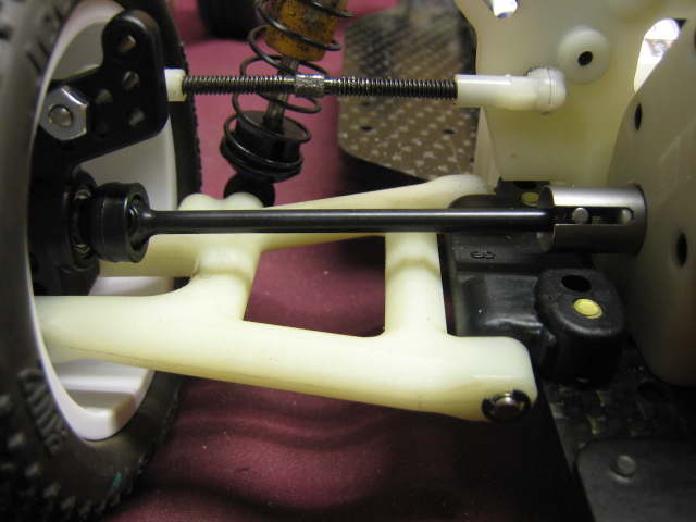

Regarding those Losi a-2038 rear hub carriers Doc J33p had 4 up for sale a week ago. Why don't you check with him they might still be available:

A & L made CF chassis stiffeners bitd which is probably where the idea originated, they are very difficult to find and expensive so it looks like a simple L shaped piece of material maybe aluminum or CF which might be available at McMasters Carr or some place like that. If you can tie it into the front battery mount midway then it really does the job.

Aluminium tubing covered in black shrink sleaveRedScampi wrote:What are the chassis stiffeners made from?
I tried to look at the page to see if I could buy them. But I don't have access?a01butal wrote:Regarding those Losi a-2038 rear hub carriers Doc J33p had 4 up for sale a week ago. Why don't you check with him they might still be available:

Through the help of a01butal. I have located some Losi hubs. That should have my CVA problems fixed.

did you have to trim your rear turnbuckles with those losi hubs???? Maybe I'll get him to hook me up with a pair too?chris72983 wrote:He did, thanks for the help.a01butal wrote:I sent Doc a pm so maybe he will contact you.
oh, and can you us the same bearing with those?

for the record, there's nothing wrong with the rpm carriers. i just like the 2038 hubs because there a ton of camber placement options. if i remember correctly, when david and paul built theirs, they had to drill a hole higher in the bulkhead to get the suspension to work the way they wanted to. you won't have to do that with the losi hubs.

I prefer the losi hubs too, but if I cant find any I may have to go with the rpm hubs. Do you happen to know the part number for the rpm hubs?

it looks like 70272. that's just for the carriers.

I just decided to use the Losi hubs, so that I could use the bearings I already have and for the camber links. I just felt they will be a easier fix for my camber and cva problems.scr8p wrote:it looks like 70272. that's just for the carriers.

chris72983 wrote:I made and installed these stiffeners. I didnt realize how much they were need after I cut the chassis lip down that much until I installed them.
scr8p are these the hub carriers?

I used aluminium tubing for the stiffners, and to strip the chassis, I just stuck it in the bead blaster at work and blasted it off.
amx73 wrote:chris72983 wrote:I made and installed these stiffeners. I didnt realize how much they were need after I cut the chassis lip down that much until I installed them.
