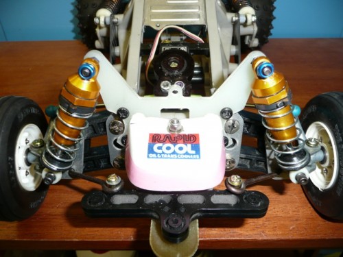

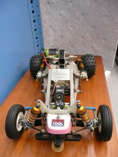

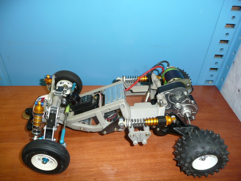

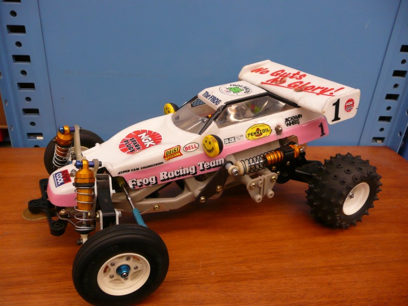

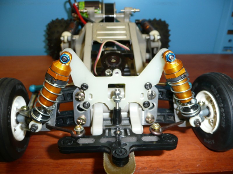

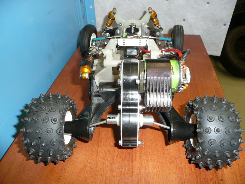

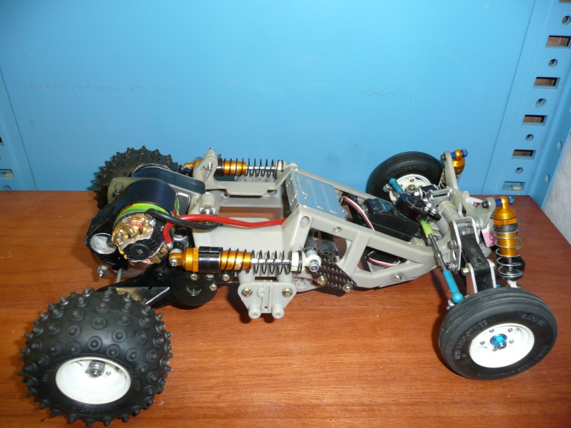

So I tore project Free frog apart to find that most everything was shot.
I had a few bits from it that were still good though. I also had a all new built Frog roller with a working Thorp dif. in it that had about a 1/4 of dust on it. Frogs and Brats are not worth squat now so let the fun begin..
I used some old Rc10 shocks and made some custom stuff. (Kyosho front tower and c.f.
rear shock mounts).Used the free Frog skid plate and Battery lid as these are the 1st things to get trashed anyway.
Stock wheels/tires just for show.
I am looking for those front HPI buggy 5 star front rims if anyone knows a place to get them..Sorry about the crappy body. I did not want to cut a new one in half! Maybe I will swing for a re-pop soon.

I spent last night trying to get rid of the bump steer on this setup.. No matter what I tried it won't stop toeing in. I tested just about every height on the knuckle and servo saver to no avail. I ended up extending the saver arm to drop the links more toward the front of the car. This gave me very slight toe-in fully extend (rebound) and slight toe-in fully compressed.
I think dropping the link on the knuckle would fix this but a I can't do that without running the ballcup under the knuckle. That messes up everything. Hope that was clear..

I raced the Frog at the vonats and I had the stock steering setup with exception of replacing the stock servo saver with a Kimbrouugh.... Geometry stayed the same however. I didn't notice much problem as far as bump steer goes, so don't lose too much sleep on it. My biggest problem was front suspension articulation.... Running the absolute lightest AE spring still made the car feel too stiff in the front. Ended up using 10 wt losi oil to lighten it up further. If the bottom of the shocks could in some way be mounted more inboard on the arms, it would fix this problem..... You will also need to make some kind of sway bar for the rear. That would help dramatically.
The 2.2" rubber on this car gave me LOTS of traction! Lots of steering (probably too much) and it tended to traction roll at the end of the straights.... Probably could have trimmed the knobbies back a bit to help, but I was too busy shooting the shit with all of my vintage bretheren between rounds!! I also learned that the Torque ratio (smallest pinion) was the way to go with a 27T stock racing motor. All in all, a very fun car to race.

Sway bar is in the works.I might put the stock system back on to compare it to what I have now.I think making the links longer and the increased travel is the problem.
I guess if I really wanted ,I could fab up a bellcrank setup but I agree it's probably overkill for a Frog.. I noticed that the front is stiff too. I have asc silver springs on now.Going to try that 10wt oil and see if it helps. I might take a drill to the pistons too.
