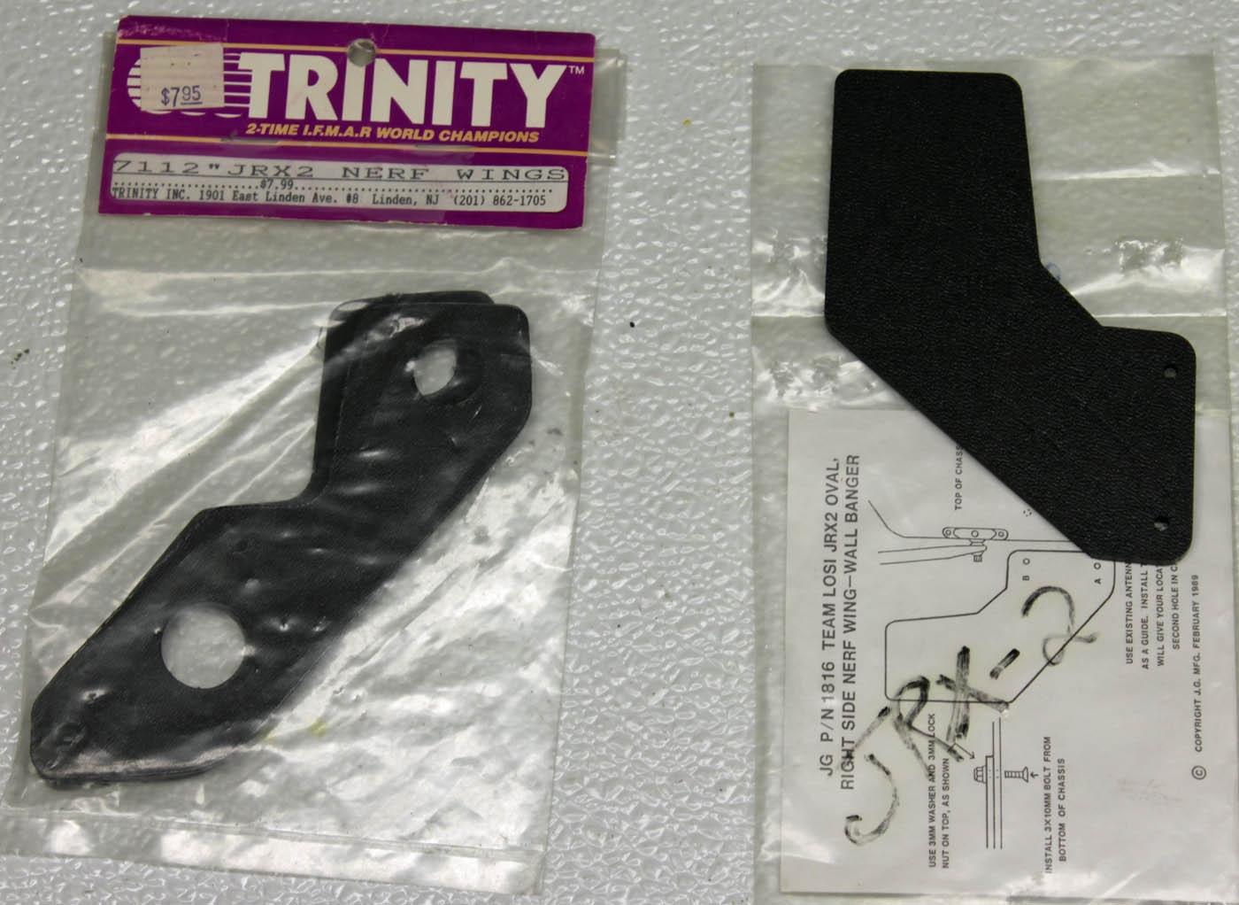

I'm pretty sure they are Trinity # 7112 nerf wings, pictured here on the left. They come in pairs. On the right is the JG "wall banger" nerf meant for the right side of oval cars.RCveteran wrote:That 5 link looks great in action, what are those nerf bar looking things on the side?
Retro, great looking rides. Could you post your setup info on the short wheelbase 5-link car?
