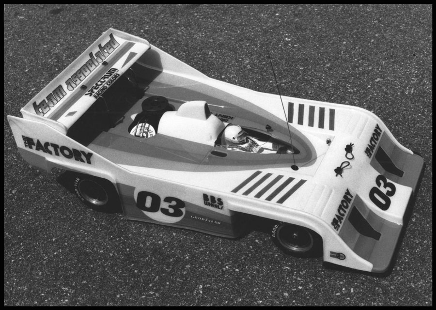

Digging through my cabinet... found a framed photo of one of my favorite paint jobs.
Here's a black & white photo of my 1980 Monterey Invitational TOJ body. I believe this was one of my first yellow/green/blue bodies, like what you see in my avatar. The back of the photo says 2nd Stock, 1st Modified, 3rd Concours. I made most of the decals myself using Letraset letters. "The Factory" was our NorCal race shop with Al Chuck, Butch Berney and Robert Fujioka.

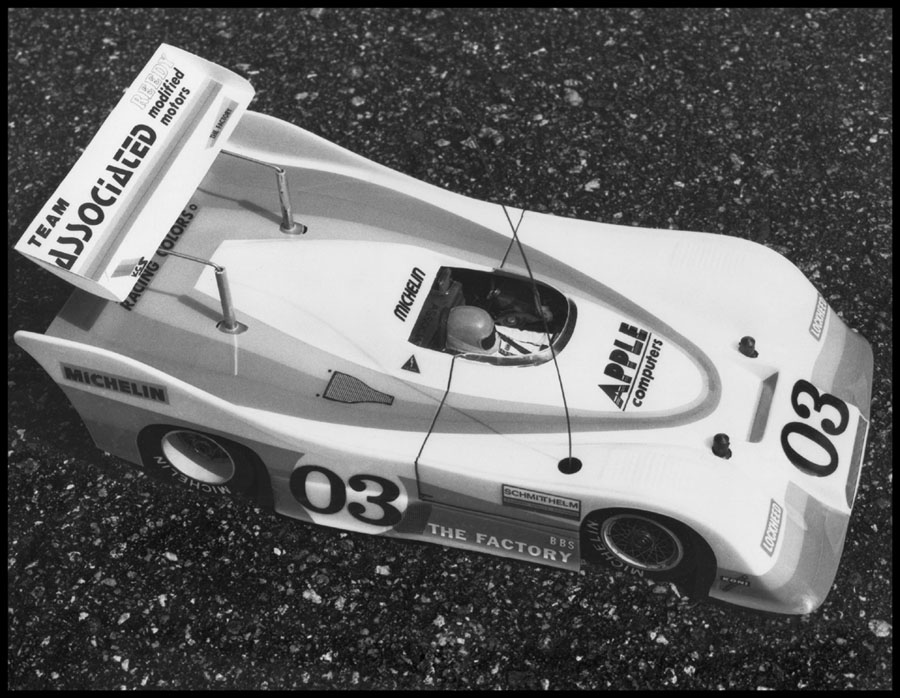

And a 1/8th scale ELFIN body with the same paint job, probably the body I ran at the 1980 McCoy race in Pomona.

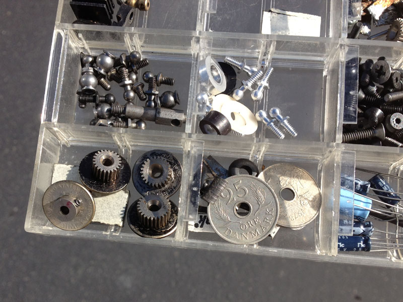

kent, i'd like to know your thoughts on this bud bartos parma 1/12th scale from 1984. please read his description about the pinion gear........
http://cgi.ebay.com/Vintage-1-12-world-champ-Parma-Euro-panther-Buds-BRP_W0QQitemZ370294464628QQcmdZViewItemQQptZRadio_Control_Vehicles?hash=item5637452074
was there anything against this type of modification stated in the rule book in 1984? would it be constituted it as cheating, or looked at as a........ damn, why didn't i think of that type of thing? we're having a discussion on this car in another thread, and i'd figured you'd be the best one to ask.

Yep, that's true about the pinion. I was TQ in stock and ran the same Danish coin on my pinions for that race. I think Bud saw me running them and did the same. My idea for doing that was an evolution of the superlight pinion gears that had just been released. I noticed that in stock the lightweight pinions made the car feel slow, and the heavier steel pinions gave me a lot more punch and faster lap times. Thinking "more is better" I used a reamer to enlarge the hole in the coin and glued it to the pinion. And it worked on those motors. I think it had something to do with the armatures being very lightly packed. That was just about the end of Stock class racing for the pros, so I didn't use the heavy pinions much after that, but I still have them in my pit box
