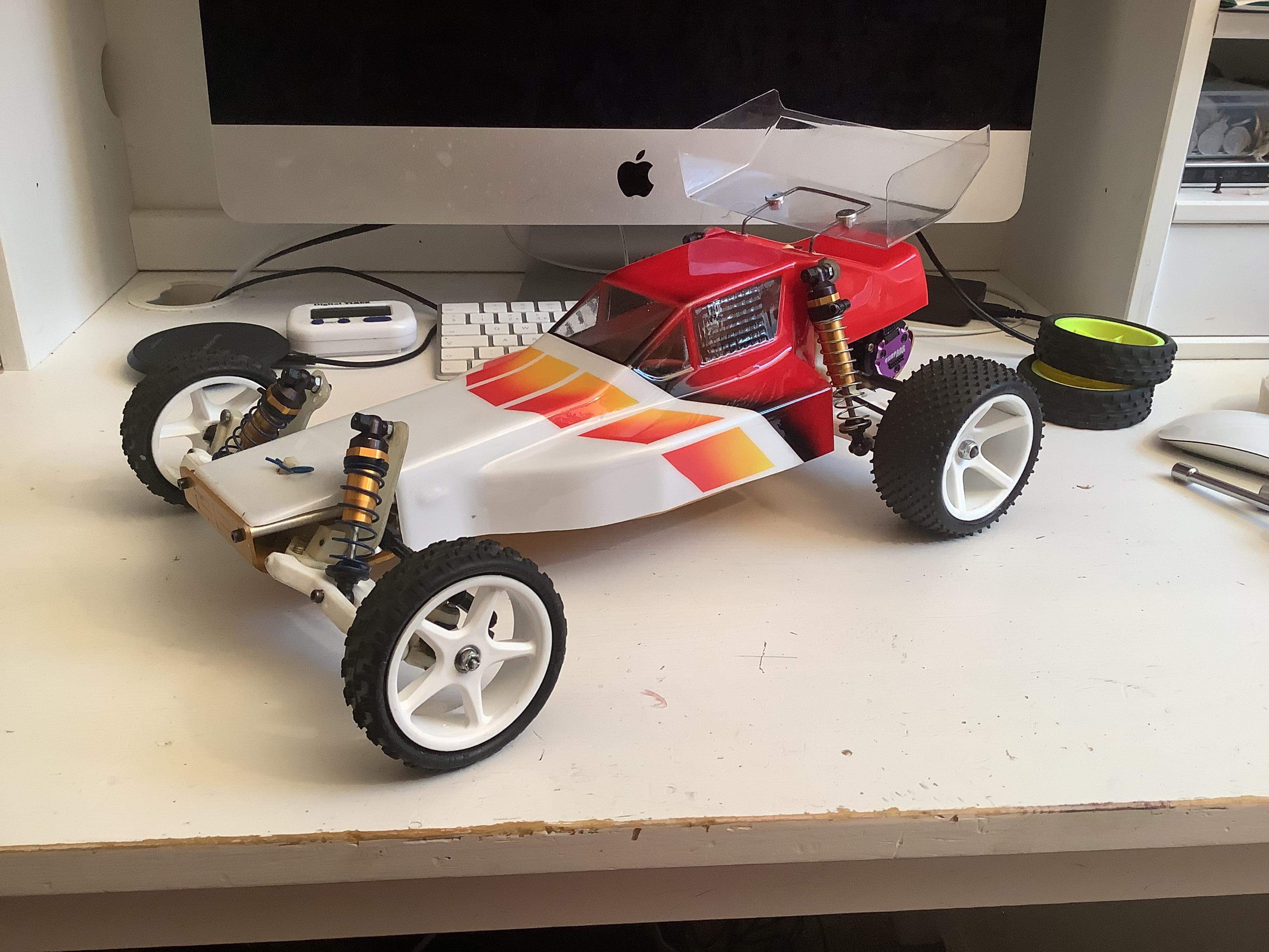

- Posts: 27
- Joined: Fri Aug 01, 2014 12:37 pm
- Been thanked: 7 times
Re: RC10 CE Set Up and Race Discussion
I'm experimenting with long wishbones to see how much effect it makes.
running 35wt front with a blue spring and 30wt rear with a silver spring
