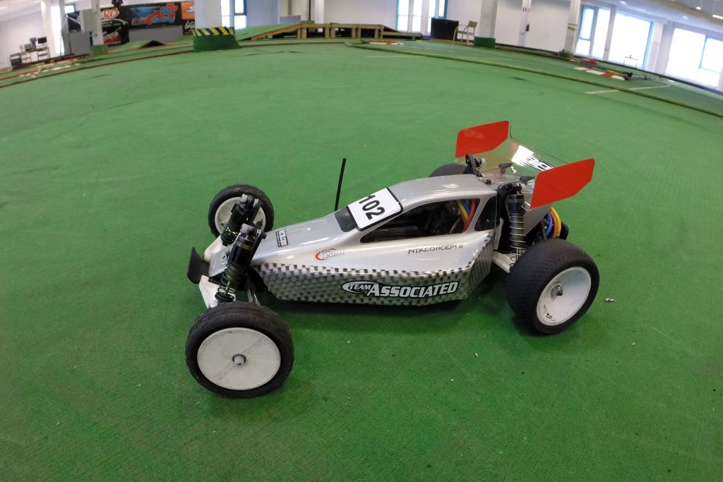

Finally got a chance to test SLS arms.
Too flexy for indoor carpet - as expected. Unpredictable behaviour in jumps and tight corners. Went back to original B2 arms and car was excellent.
Front SLS arms alone were really close to beeing ok - rear arms just flex too much. With a proper geometry and design SLS prototype arms would work fine.
Old FT shocks also in action. Full droop with rear arms seems to work nicely compared to limited down travel with V2 shocks.
Rear shock tower changed to B3 Worlds and body to Deja Vu Tu.

That's a pretty good bit of driving. The track looks interesting and fun.

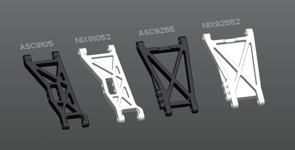

Niki, do you think the arms would be better suited for a medium bite clay track? If you were having problems with the arms on the carpet, I am sure that would also translate to some of the high bite blue grooved tracks we have here.

These white SLS arms pictured below might be good for medium/loose bite tracks. In those I tested basic geometry isn't rigid enough with PA2200 (SLS) material for any kind of track.
Good thing about SLS is the endless possibilities in design because there are so little geometry/production restrictions. All kinds of crazy sandwich- and added carbon fiber sheet structures can easily be made.
For this car project SLS arms were just a side story. Chassis and front/rear bulkheads were the main thing. And those parts work better than I ever expected.
No broken parts and screw holes also hold threads much better than a normal molded part. Must be something to do with the fact that PA2200 material is so viscous.

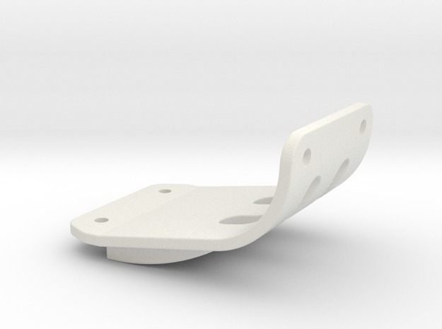

This looks proper don't you think?
It follows original #9240 shape and I added also skid plate ribs to protect chassis rear edge.
Next thing is to update all chassis drawings with mounting holes for this...
-NIki-
