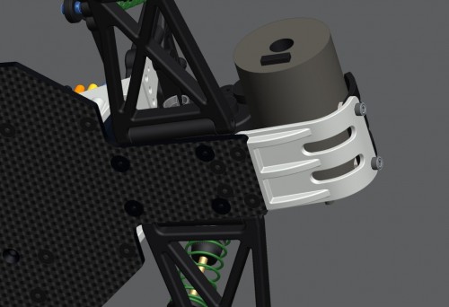

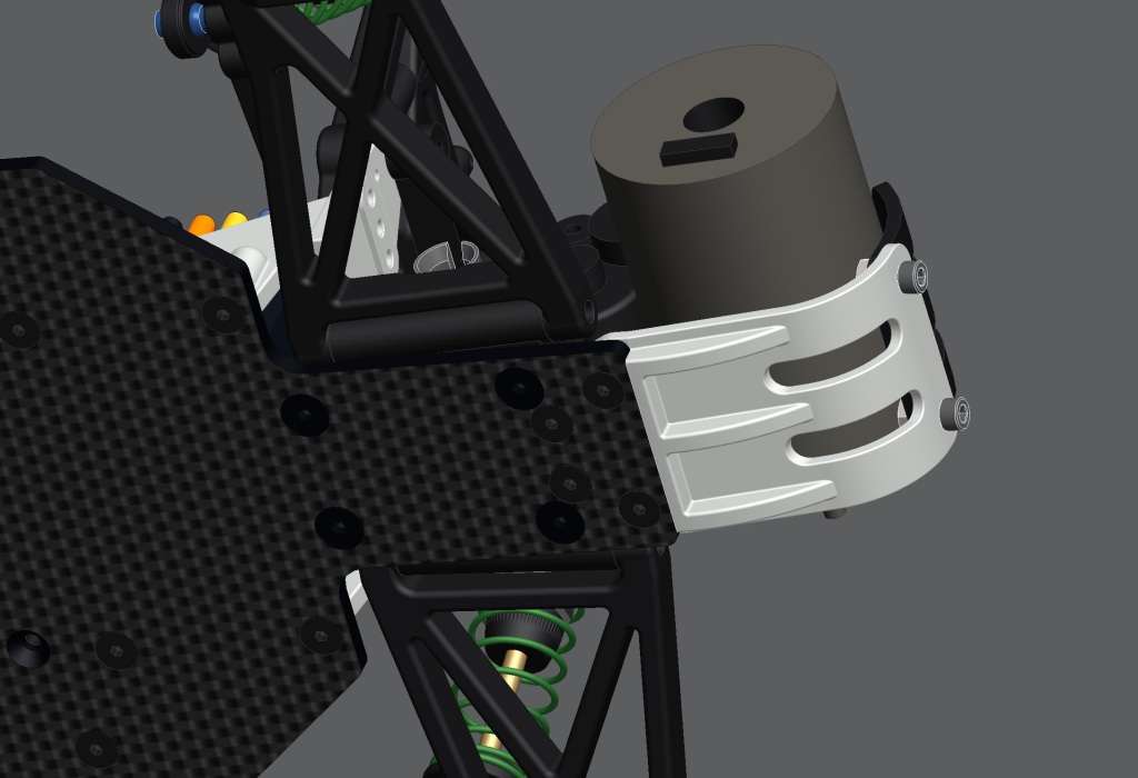

Niki wrote:This looks proper don't you think?
It follows original #9240 shape and I added also skid plate ribs to protect chassis rear edge.
Next thing is to update all chassis drawings with mounting holes for this...
-NIki-
Good job Niki, looks great!
As soon as the updated chassis plate + motor guard is available I will order a complete conversion kit for the b3 :)
Cheers,
Daniel

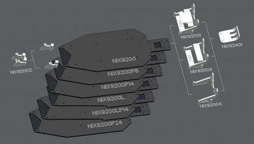

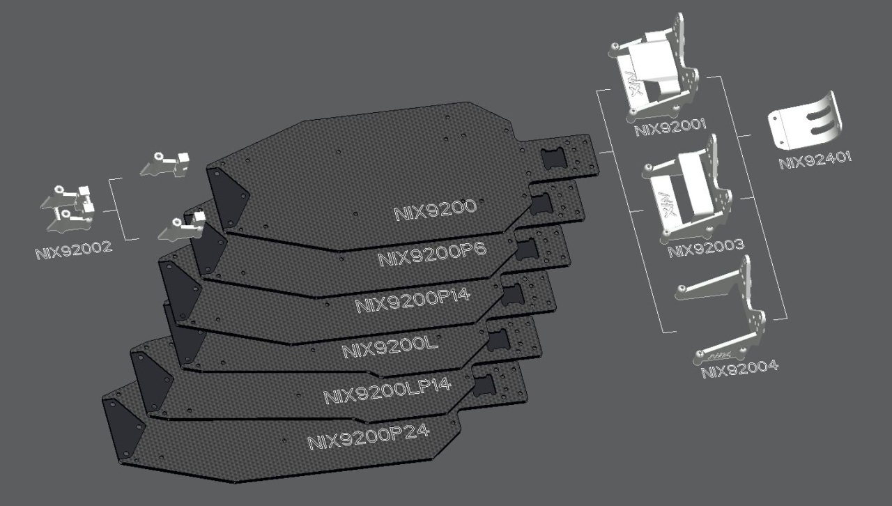

Start page of this topic now updated.
Download PDF and DXF drawings of your chosen chassis and send it to your chosen manufacturer.
SLS parts can be found here:
https://www.shapeways.com/shops/nixconcepts?section=RC10+B2%2FB3%2FT3+Graphite&s=0

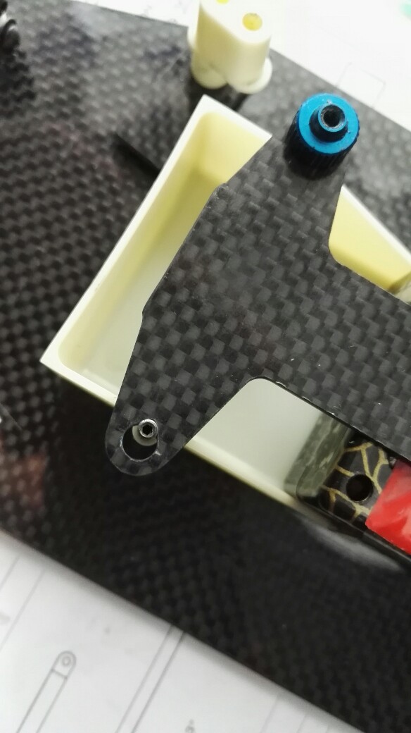

The chassis plate arrived today! Looks great :)

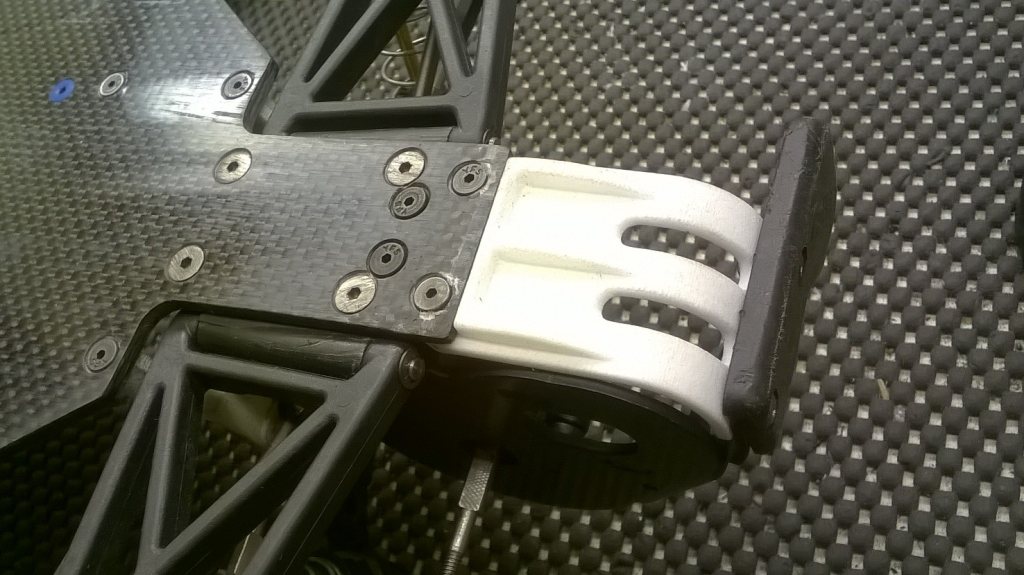

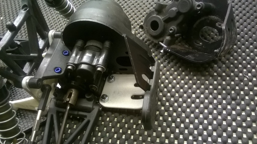

New motor mount brace and standard transmission covers.
My chassis rear end is now modified to match current drawings.

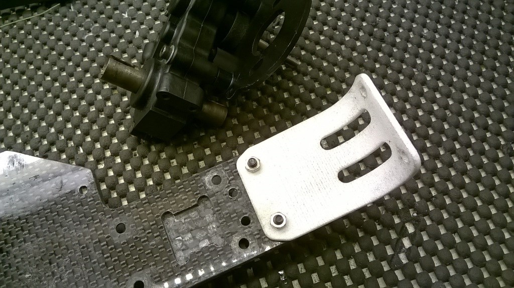

Re: RC10B2 / B3 / T3 Graphite - NIXconcepts
Post by Niki »
It's so much better now...

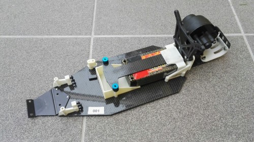

Niki wrote: Sun Dec 22, 2013 5:27 pm For example like this...
or
Hi,
Is there a file for the rc10 graphite shape chassis with extra holes to suit the rear battery cup for shorty pack?
Thanks.
Post by Niki »
Do you want to mount it sideways? I think there is not enough space on narrow chassis. On std. chassis you can mount shorty sideways to B44 craddle.
-Niki-

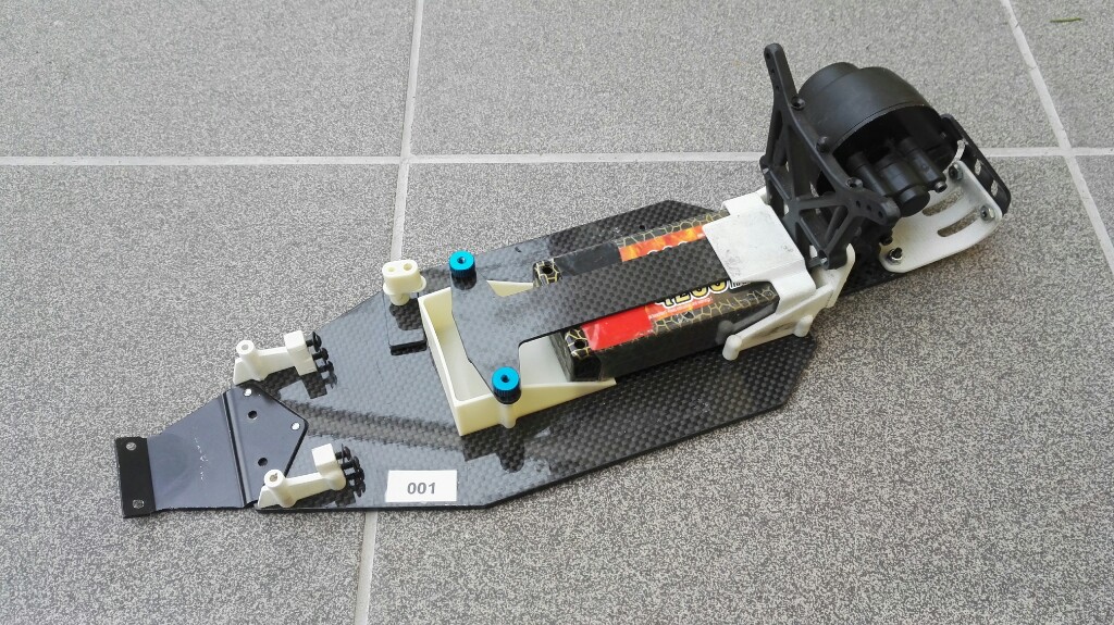

I plan on mounting it length ways. Just not sure if the distance between the front battery cup and rear bulkhead nix92001 is too far to keep the shorty battery secure.

Niki
Posts: 524
Joined: Wed Nov 02, 2011 7:32 am
Location: Finland
Been thanked: 45 times
Post by Niki »
OK. There is no holes to move front battery cup backwards, unfortunately. By using a B4 battery strap, you can still do it like this...
green510
Posts: 158
Joined: Wed Feb 17, 2016 1:10 am
Location: Melbourne, AUS
Post by green510 »
Does the b4 strap have correct spacing across the mounting points or do you slot the holes to suit.
Got a b4 strap similar to whats pictured and holes don't line up to the cups i have which look right.
Thanks for you help too btw :)
Dan.
Team B3, OG Worlds car, B5m.
Plus some other junk :D
Niki
Posts: 524
Location: Finland
Post by Niki »
Small amount of tuning is needed.
