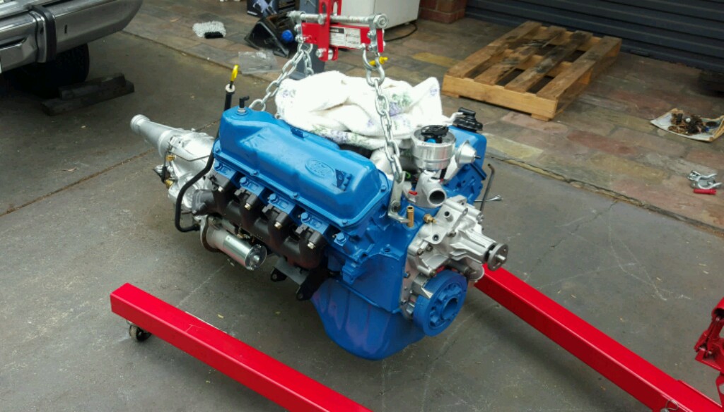

Well it's finally happening after amost a year and a half. The engine is going in tomorrow.
I finished the last piece of the puzzle testing the starting circuit. The radio plays, the lights and horn work, the starter spins, the ignition circuit works, the dash wiring has been repaired. The power booster, master cylinder, power steering box, coupler and steering lines and underhood wiring replaced just to name a few things .

My hooptie will be on the road soon.
The engine is in finally, and it didn't go in easily or smoothly. I also had to pull and move the transmission cross member and remove 30 years of grease, dirt and oil as it was set up for an FMX which has a different mounting location.
It lightly rained on and off so I didn't get as much done as I would have liked, plus I got a late start. Tomorrow I'll try to bolt up the drive shaft, torque converter nuts, splash sheild, exhaust, speedo cable, carb, throttle bracket, kickdown linkage, heater and fuel hoses, transmission lines and some of the accessories if I can.
Not far to go now... I've ordered a new power steering pump and just need to get a VPW trans cooler, overflow tank, make up some battery leads and lengthen the throttle cable.

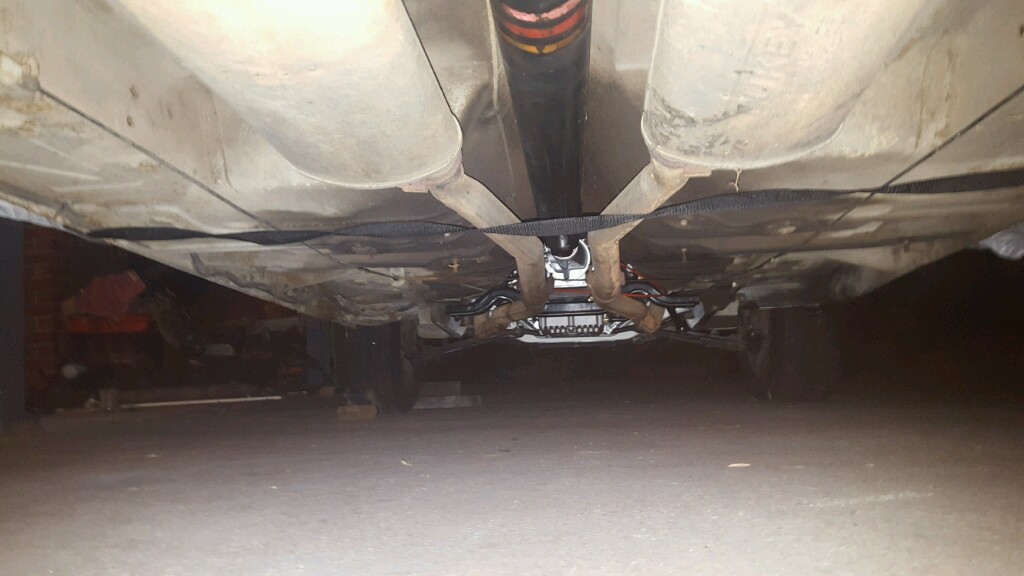

I got most of what was on my list done despite my wife kidnapping me for a few hours to look at cabinets. I also forgot a few bolts for the harmonic balancer pulley and sandwich plate splash sheild, and of course the local parts store was closed :roll: the hose clamps I had were too big too so I need to get some smaller ones tomorrow.
Everything under the car is pretty much buttoned up. I'll post a better update tomorrow but here is a useless pic under the car.

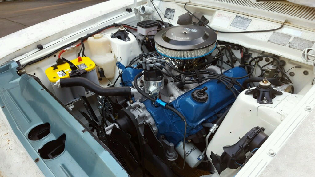

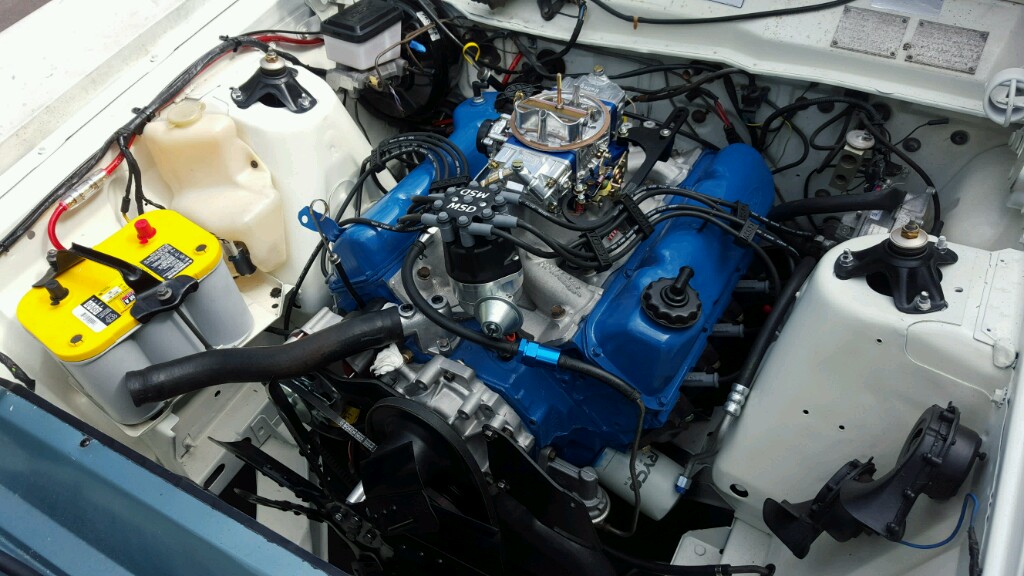

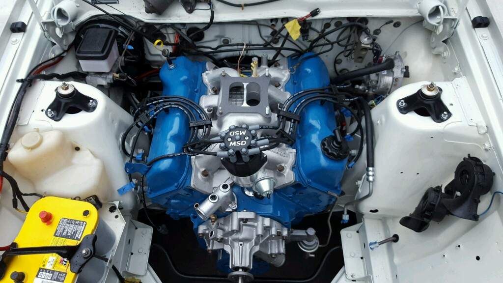

Here's my update.........
Nothing ever goes to plan. My custom stainless kickdown rod didn't fit in the car and I was dreading having to deal with it. It ended up costing me $300+ AUD and I was pretty bummed it didn't work (it fit perfect on the pallet though.) I already ruined a $125 spare from the wreckers trying to re-bend it.
I though well, I've got nothing to lose so I went ahead and bent my $300 rod. I ended up using an old water pump pulley to bend the rod without kinking it, this worked surprisingly well. I also had to modify some of the other bends, but in the end it all worked out well and you couldn't tell that I re-bent it...... phew.......
The engine builders had too short of screws in the water pump for the alternator brackets, so I had to find and clean the proper ones.
I left tape on the shifter cable to protect it from grease and damage when I put it in, the old engine was still in at that stage. I left it for months which was a big mistake. Cleaning the tape goo off was a real PITA.
Although the radiator is fairly new (only been on the car 6 months) I'll take it down to get hot tanked, pressure tested and painted before going back in.
The hood is now bolted on and there is only about 1" clearance from the air cleaner to the hood. Just gotta install the power steering pump, install radiator, clean and install transmission hard lines, set up the B&M shift cable and run vaccuum hoses. About one more days work and it should be ready to start.
