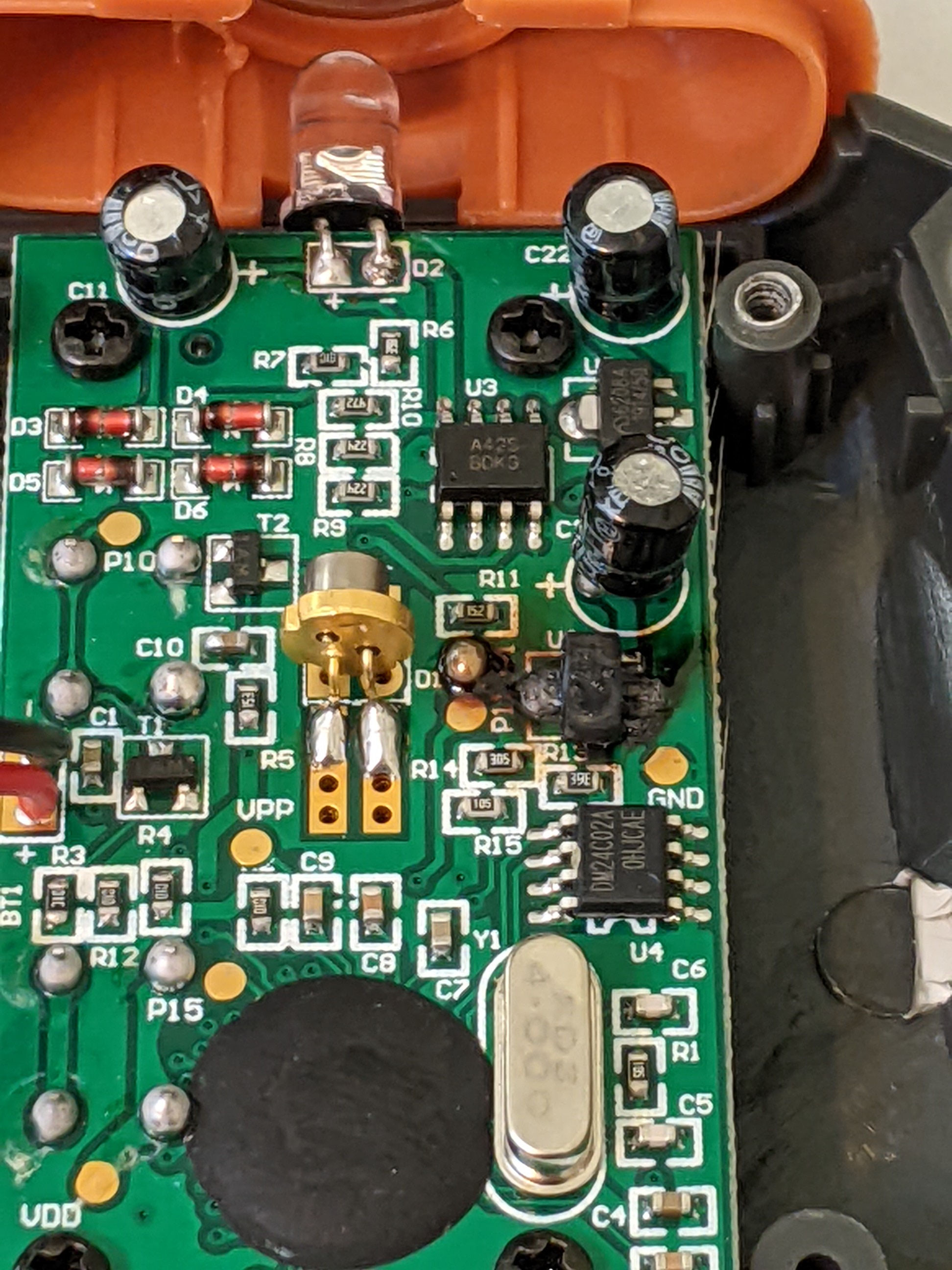

The laser on my DT-2234C+ photo tachometer had gotten too weak to reflect a readable beam back. I discovered that I could hold a separate laser pointer and use that for a signal beam. In the process of tinkering, I applied reverse voltage. That almost immediately let the magic smoke out. Wow that smelled bad. Now back to proper polarity, the laser is nice and bright again but the display readout is dead. Oops.

Re: Thinking about dyno's for brushed motors
Looks like just one component , do you want me to identify the part number on mine so you can repair it ?
Hmmm... that's tempting. I did buy it from the cheapest source I could, but it's a shame to throw things away. If you could ID the part, that would be great.
