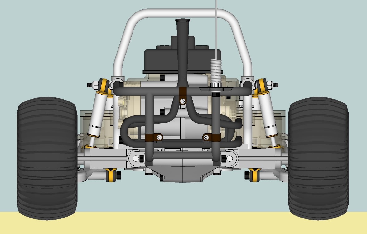

Hmm. Is the change to WB because Manx chassis plate length differs from the stock FRP plate?
Anyway, the roll bar and rear guard fasten directly to the transmission which is standard SRB so I don't understand why there is a problem. How does the Manx roll bar differ from the standard SRB part with regard to pipe joint location?
Anyway, I should be able to design whatever you will need. I just need to understand what changes are needed.
EDIT:
Using the link that's provided on Knight Customs website to a Manx build on SBG message board, I've found this photo.
It looks like they have you cut the stock SRB roll bar.
EDIT:

Yes, shorter chassis pan.
The problem is that cross bar they say to cut out, is what holds up the rear of the Manx body, it also is right where the other half of the pipe joint goes.
I guess the body can rest on the rear cage, and pipe joints, if I use the stock roll bar and cut it down. Will do that, thanks for looking in to that.
Missed that build link there.
https://www.scalebuildersguild.com/forum/threads/srb-based-manx.20713/page-7

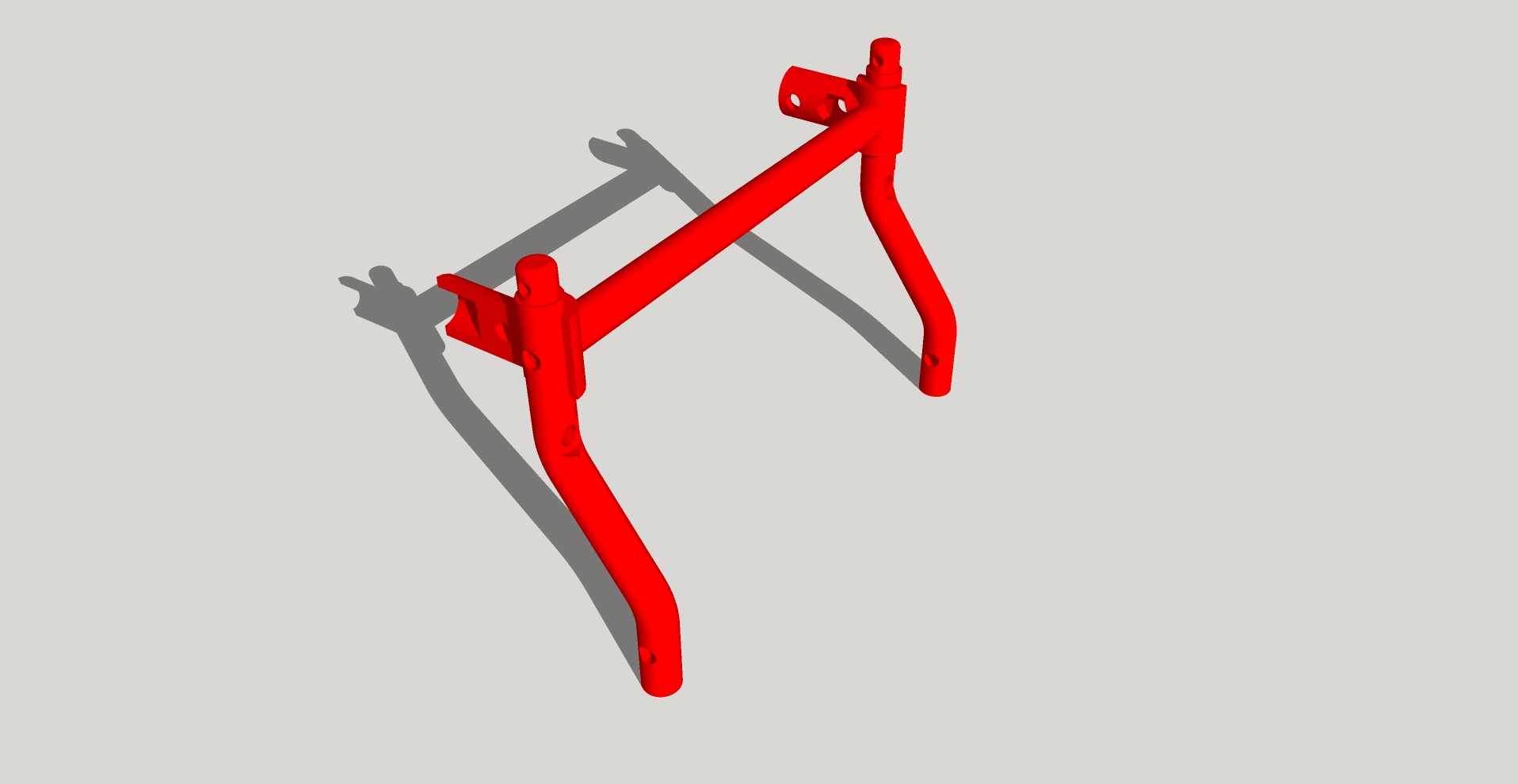

Ah, now I see it -- thanks.
A design flaw, perhaps.
Anyway, I have merged the inner half of the pipe joints with the Manx roll bar and uploaded the stl file to the Beach Buggy Body Set on the Google drive.

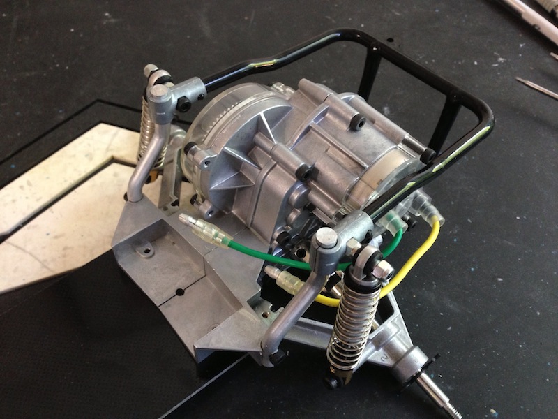

The new rear cross bar and half pipe joints work really well!
But the rear shock stroke length is too short, to allow the chassis to sit level.
The front shocks have a longer stroke, and might be the correct length in order to match the front and rear suspension.
I tired to mount the front shock in the rear, but the eyelets on the front shocks won't line up for the rear. I should have some more silver and black PLA coming today. The white PETG-Tough is nice for strength, but it's not as pretty to look at.

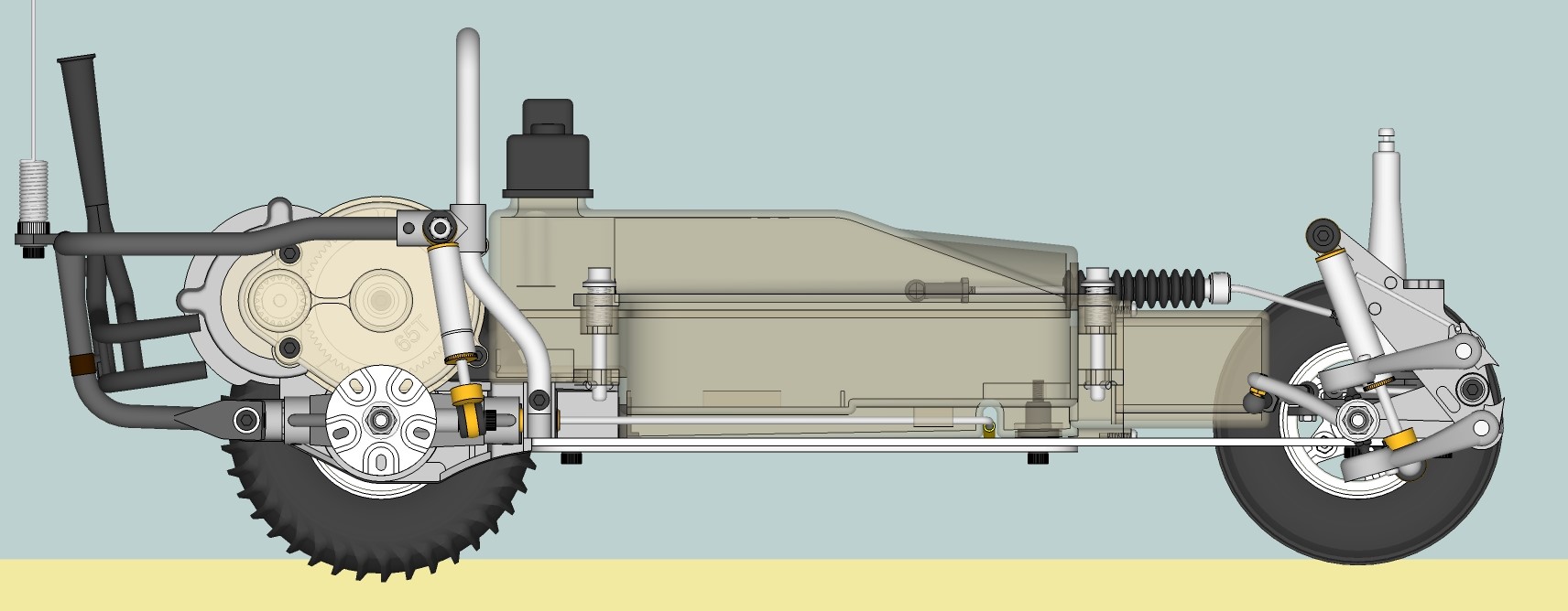

Hmmm. The CAD model sets level so not sure what has happened. Anyway, it's an easy fix. What length does your model need to establish desired ride height?
At least they're not leaking.

Hard to say where the rear should sit, if the rear tires are larger than the front.
I would guess that with the rear shocks attached, the rear arms should be level, or parallel with the chassis. That seems like it might be the place to start. Would it be easier to make the rear shock stroke, the same length as the front? When I hold up the front shock to the rear, that seems pretty close to the right length.

I agree; rear arms should be level. On the CAD model, front shocks are 61.85 while rears are 50.20.
I could make the shocks functional but then you would need springs. Does anyone make spring steel filament?
BTW, how do the fronts look; is length correct?

That looks perfect! I was going to reprint the front pivot axles today in PETG, the PLA probably won't hold up at that angle, I can't tell how the front lines up just yet, but that front shock length looks correct, and level.
The real SRB gets crazy positive camber in the rear, I have to adjust it to make it sit level on the shelf, otherwise it looks like it's on stilts in the rear.
