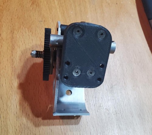

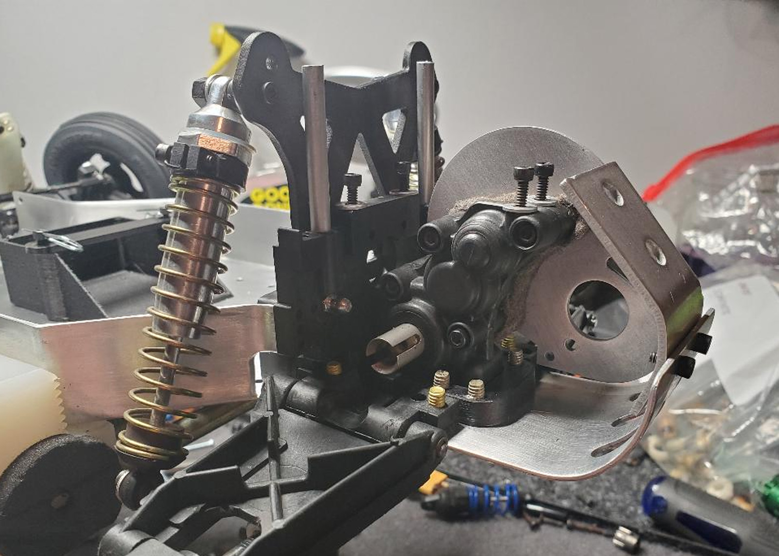

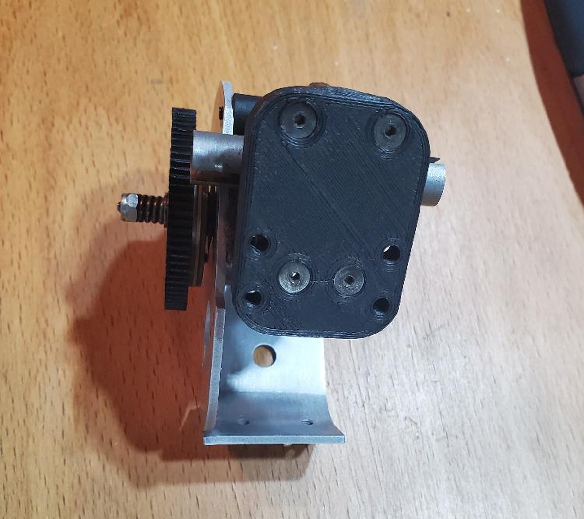

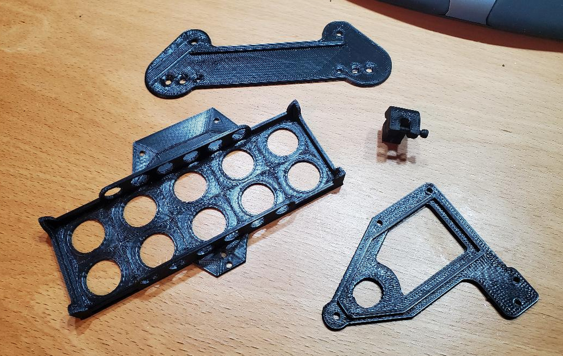

Here are a few parts I have designed and printed for my 10L over the past few weeks. They are made of ABS, which is plenty fine for all of the pieces save the shock mount. If I can get a stock piece that suits my needs, then I will get one, but I tend to want to experiment and do things my own way, and that means making parts that the factory didn't. And when these break, just print a new one.
I have been working with ABS because my six year old printer limited me to PLA and ABS for multiple reasons. Just like Steve71, I now have an Ender 3 V2 that showed up today, and I am hoping to move into the PETG world. With that, I am hoping to build pieces dense enough that I can thread into with 3mm machine screws and the plastic grip and hold, which I was unable to do with ABS.

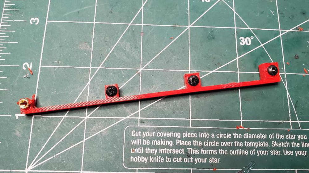

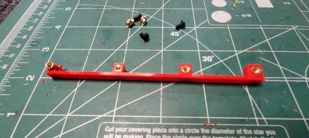

Re: 3D printer for parts

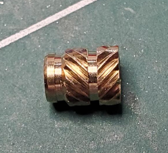

I ran across this youtube video discussing threaded M3 brass inserts, and I just had to do some testing myself.
I am using these https://www.amazon.com/gp/product/B087NBYF65/ref=ppx_yo_dt_b_asin_title_o01_s00?ie=UTF8&psc=1 which are shown in the video as the "mid priced" option. A bag of 100 were $14.
I printed a simple test piece to show four different "surrounds." Each hole is 4mm, and the surrounds are a total of 5mm, 6mm, 7mm, and 8mm. So, 5mm is .5mm wall, 6mm is 1mm wall, etc. The piece is printed in generic PETG.
I heated a soldering iron to 500* (or says my cheap Chinese iron), and inserted an insert into each hole. The .5mm wall was a complete fail, not surprisingly, but all other wall thicknesses took the inserts just fine.
To be honest, all thicknesses held up to more than enough than you would ever need in a RC. I don't have an inch-pound torque wrench, but to be honest, I couldn't get these to twist in the plastic. They are as solid as you would need them to be.
So, if you have enough room for a 6mm wide and 6mm deep block, put an insert in there. You can screw and unscrew a thousand times and not have to worry about how your plastic threads are holding up. And if you break the part, just melt the plastic and recycle the insert.

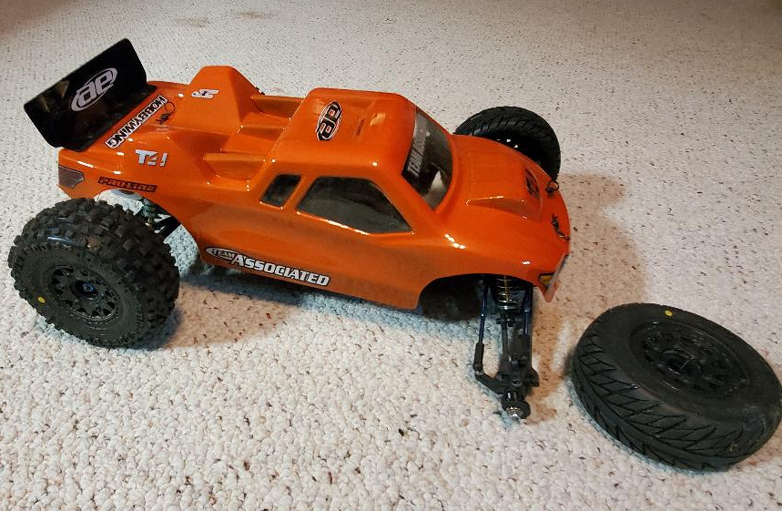

Sometimes using a slightly weaker plastic is a benefit.
Some may call this a failed printed wheel hub adapter. I call it a servo saver! I mean, when you hit a brick wall at 3/4 throttle, something has to give!
