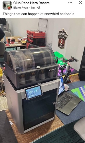

People always try to go cheap on the printer and find out quickly you can only do so much. To make proper, usable, bashable parts you really want an enclosed printer and hard nozzle. The Bambu machines are just amazing and I have replaced my 7 older machines with 2 of them, no regrets at all. They print so much faster and better it is just incredible. I went with the x1c which is spendy but the p1p and P1S are fine machines as well. Again, not cheap- but you plug them in and your going. My other machines were hobbies of their own.

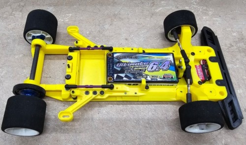

Heres a club race hero car printed in abs on one of my machines. Just an example of what people are doing. These free to download, community supported, printable cars raced snowbirds last month and were very competitive running in the A main in GT12.
We are almost to the point where seeing a printer at the track won't be wierd

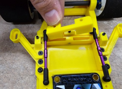

Turnbuckles as chassis braces, who would do such an absurd thing?
Did I design this during my last sleep trial? 🤣
You guys are luring me in
Posts: 12214
Has thanked: 1084 times
Been thanked: 3762 times
Re: If I had a 3D printer…

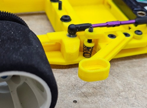

Those are actually part of the "4 link" which uses live hinges at the bottom. System works really well. The part in the middle is a "dipper". You fill the well with syrup and it's a crude but very effective damper. Just try not to leave the car inverted for more than a few seconds lol!

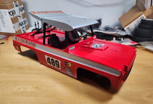

Why print a pan car chassis when you can get one cut by an expert out of G10 or CF??? :D Added accessories sure, but why the pan?
edited: added a little fdm porn
