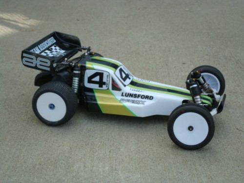

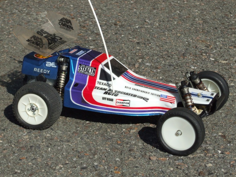

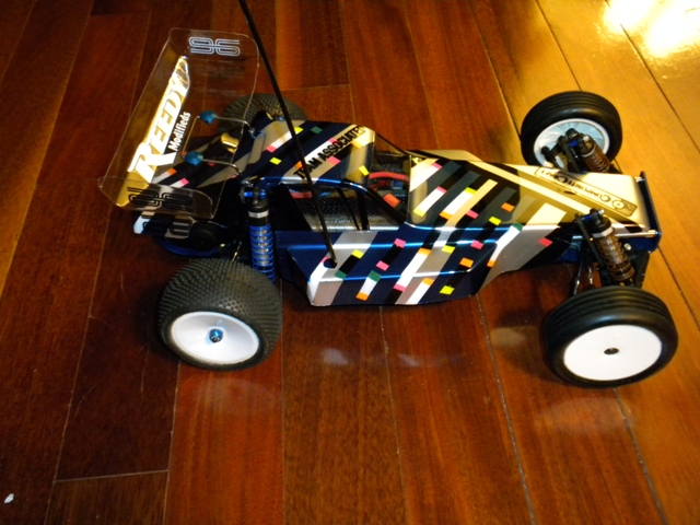

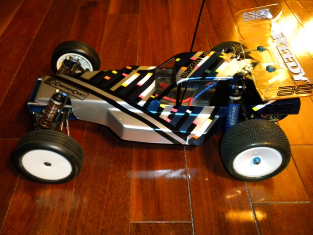

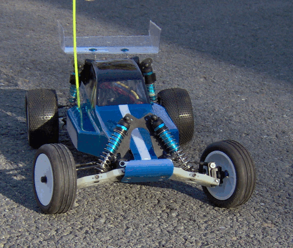

Hopefully I'm not wearing this pic out, but it seems like an appropriate spot for it...
Chassis parts
Truck nose plate
Nose brace tubes
Team car chassis
Graphite braces
RC10 battery cup
Associated bearing steering bellcranks
Protech body
RC10 wide wing
All countersunk holes countersunk more for no protruding screw heads.
Front
Dynotech front suspension arms
Proline B4 front wheel
RPM "Worlds" front shock tower
RC10T front bulkhead
RPM front bumper
RC10 caster block 25 degree
Inline steering blocks
RC10GT extended inline axles
Lunsford Ti turnbuckles
RC10 1.02" shocks, 30wt, brown springs
Rear
Dynotech rear suspension arms
Proline B4 rear wheel
Rear B4 MIP CVD
RC10 hinge blocks 1.5 degree
RPM RC10GT rear hubs
RC12 wing mounts
RC10T rear shock tower
RC10 1.32" shocks, 30wt, green springs
RPM worlds bulkhead
Transmission
2.25:1 Stealth tranny
27t/81t pinion/spur
RPM gear cover
Electronics
Futaba 9550 servo with Kimbrough servo saver
Orion 3600 Lipo race pack
Novak GTB ESC
Trinity Pulse 17.5 BL motor
Nomadio React receiver
AMB transponder
Chassis parts
Truck nose plate
Nose brace tubes
Team car chassis
Graphite braces
RC10 battery cup
Protech body
RC10 wide wing
Front
RPM front bumper
Rear
Rear B4 MIP CVD
RC12 wing mounts
RPM worlds bulkhead
Transmission
27t/81t pinion/spur
RPM gear cover
Electronics
Novak GTB ESC
AMB transponder

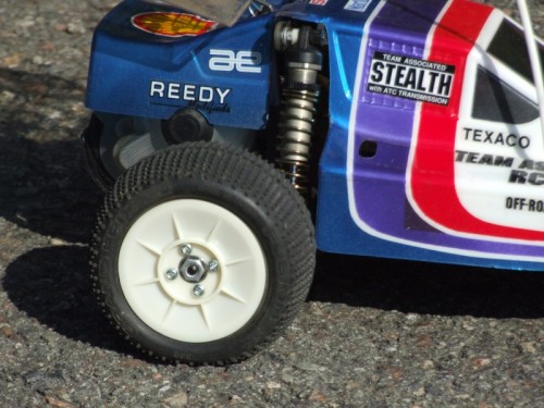

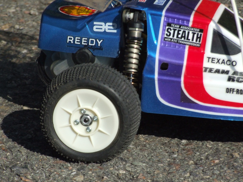

I tried different wheels
[Front]
Fibre Lyte shock strut for .89 shocks
.89 threaded shock bodies
.71 shafts
team car arms
rpm spring cups
B3 wheels
[Rear]
Fibre Lyte 94 worlds shock strut
Dynotech Klein arms
1.18 threaded shock bodies
1.02 shafts
RC10T/T2 hub carriers 0 degree
B4 CVD bones
RC10 CVD axles
Yoke wheel hubs
YZ-10 ribbed wheels
I tried B4 wheels and axles. but this setup allowed me bigger thread.
[Front]
.71 shafts
team car arms
rpm spring cups
B3 wheels
[Rear]
Dynotech Klein arms
1.02 shafts
B4 CVD bones
RC10 CVD axles
Yoke wheel hubs
YZ-10 ribbed wheels

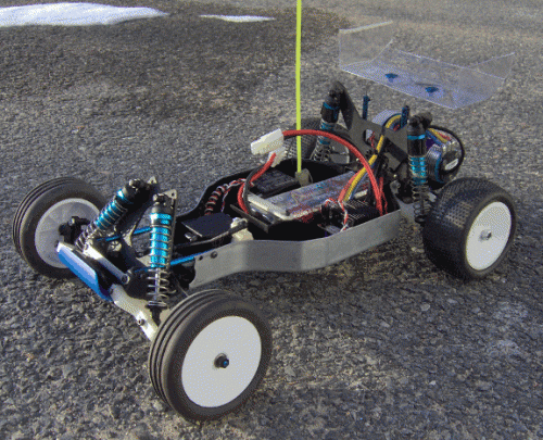

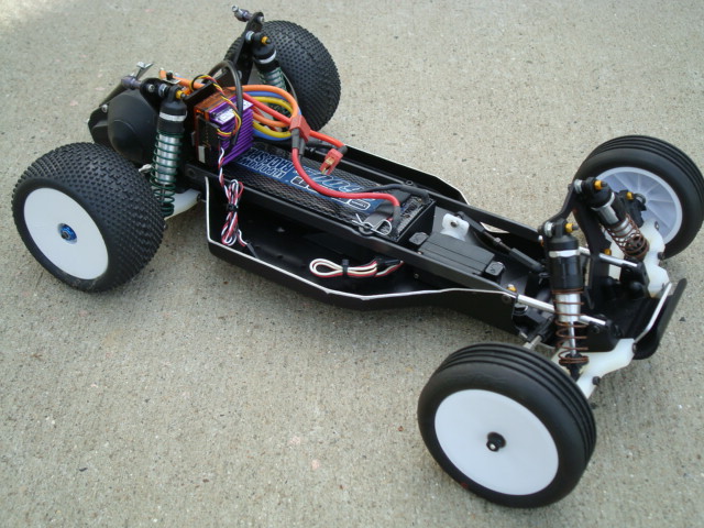

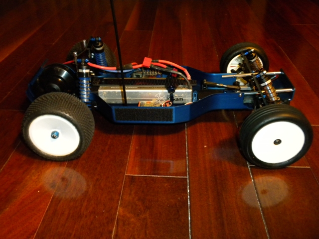

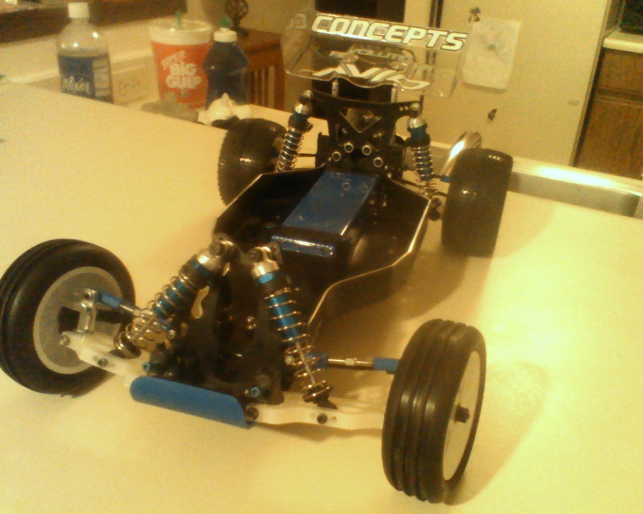

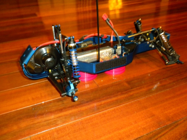

My RC10 RUNNER 01
Chassis parts
Nose brace tubes
Team car chassis w/ cut down sides to ½”
RC10 battery cup
MIP bearing steering bellcranks
Protech body slammer
Kyosho wing
Hot tricks antenna mount
Custom CF battery brace
Associated FT Thumbscrews
Front
RC10 front suspension arms
RC10B3 Wide front wheel
Custom shock tower for 1.02 shocks.
RC10T 1.02" shocks, 35wt, green springs
Custom front bumper
RC10B4 caster block 25 degree
RC10B4 Inline steering blocks
RC10B4 inline axles
Rear
RC10 rear suspension arms
RC10B3 rear wheel
RC10B4 CVD axel w/ Axle Wheel Spacer
RC10B3 CVD dog bones
RC10 RPM hinge blocks 3 deg
RC10T 0 deg hubs
Custom shock tower
RC10 1.32" shocks, 30wt, silver springs
Custom CF tranny brace
Transmission
RC10B4 top Shaft w/ full B4 slipper clutch assembly
RC10B4 molded gear cover
Electronics
Hitec servo with Kimbrough servo saver
Novak 410-HPc ESC
Chassis parts
Nose brace tubes
RC10 battery cup
Kyosho wing
Front
Custom front bumper
RC10B4 inline axles
Rear
RC10B3 rear wheel
RC10T 0 deg hubs
Custom shock tower
Transmission
Electronics
Novak 410-HPc ESC

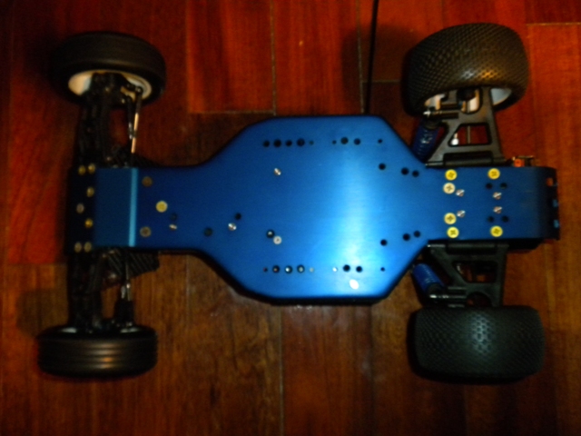

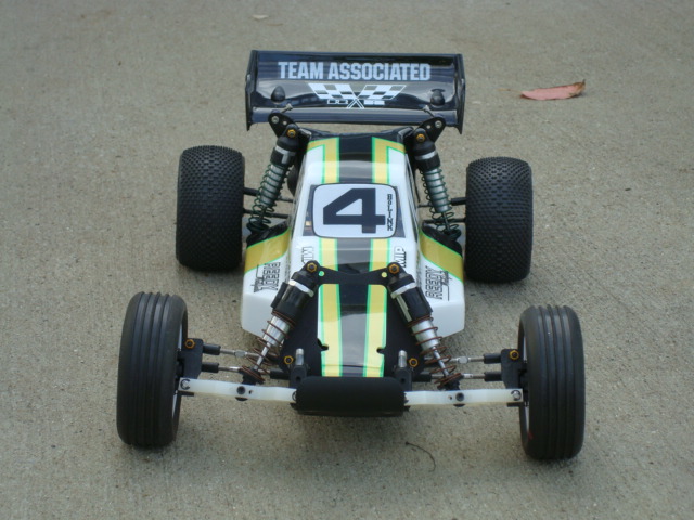

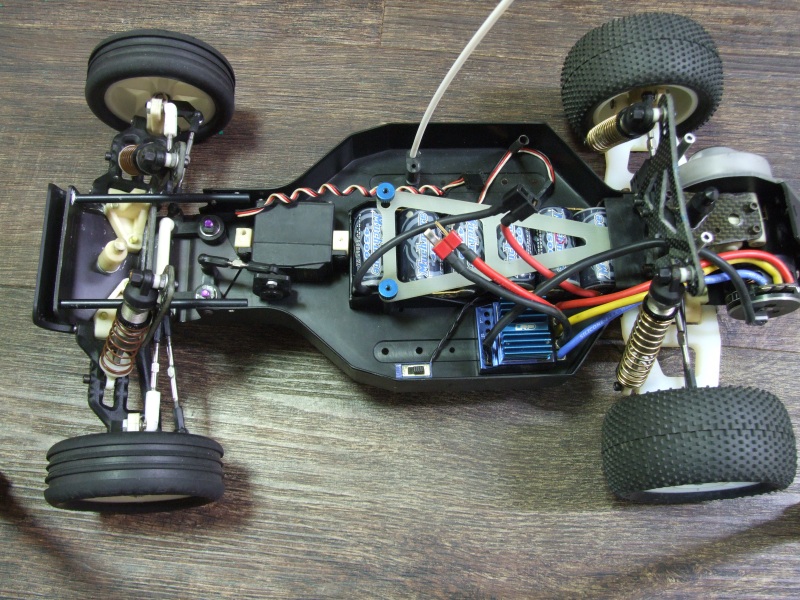

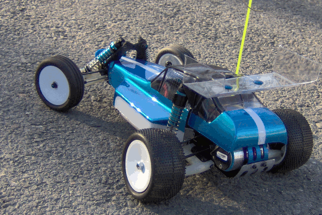

Parts
Front:
2701 Dynotech Racing Klein Front arms
6255 Servo Saver
7305 RC10T Nose Plate(NOS)
7207 RC10T Bulkhead
7222 Wide Front Axle
6221 Inline Steering Block
7315 FT Brace Tubes
7208 Front Bulkhead Brace
70725 RPM Mini Bumper
9588 B4 Front Wheel
3005-02 JConcepts Front(Green Compound)
2157 Dubro Racing Turnbuckles
DTXC2512 RC10T Molded Shock Towers(NOS)
Rear:
2700 Dynotech Racing Klein rear arms
7208 GX Rear Wheel Spacers .125
9590 Holeshot Tire M3 + insert
9756 B44 Rear CVA Kit
70272 RC10T Bearing Carriers
9589 B4 Rear Wheels
Shocks:
RC-10GT Shocks
80420 Two Stage shock pistons
Transmission:
Rc-10 B3 Stealth Transmission(2:40)
Electronics:
Futaba Magnum Junior
ESC Novak Havoc
Novak Brushless SS pro 10.5
Measurements:
Front: 9 1/2"
Rear: 9 5/8"
WheelBase: 11"
Front:
6255 Servo Saver
7207 RC10T Bulkhead
7315 FT Brace Tubes
9588 B4 Front Wheel
Rear:
9589 B4 Rear Wheels
Shocks:
RC-10GT Shocks
Transmission:
Electronics:
ESC Novak Havoc
Measurements:
Front: 9 1/2"
Rear: 9 5/8"
WheelBase: 11"

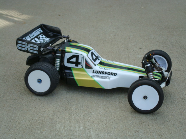

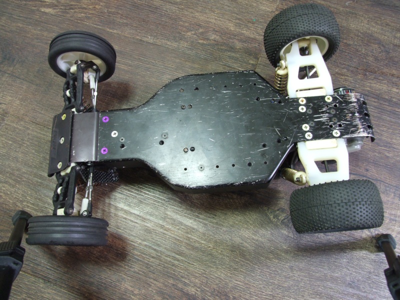

After rebuilding my Composite Craft/Houge car I got the urge to build a replica of the car I ran at the 1988 nationals. The original car had VERY large holes in the chassis (3 on each side of the bottom) that were drilled with a hole saw. If I remember right they were 1" and 1.25". I decided there would be no holes in this one. The original also had Brimod shocks, which I simply can not find.
Front
Associated wide arms (original had Andy's)
B4 caster blocks
B4 steering knuckles
B4 axle
TBG graphite shock tower
Stock shocks
Rear
Andy's arms
Racer's Edge carriers
B44 CVD'S
TBG shock tower
stealth tranny with B4 top shaft
The chassis from the donor car was in pretty good shape before it was re-anodized blue. All the imperfections were covered by the new color.
Front
B4 caster blocks
B4 axle
Stock shocks
Rear
Andy's arms
B44 CVD'S
TBG shock tower
Re: ** What's Old is New Tech Thread **
After I saw Brandon's car I knew I had to convert my 10t
pretty much the same parts list except the rear shock tower
Almost done
Almost done
In the pits...broke again
