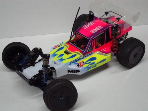

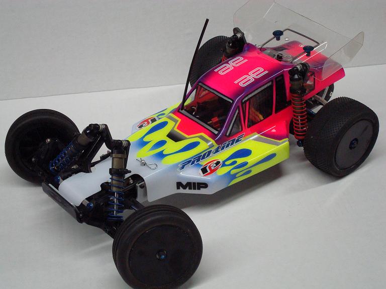

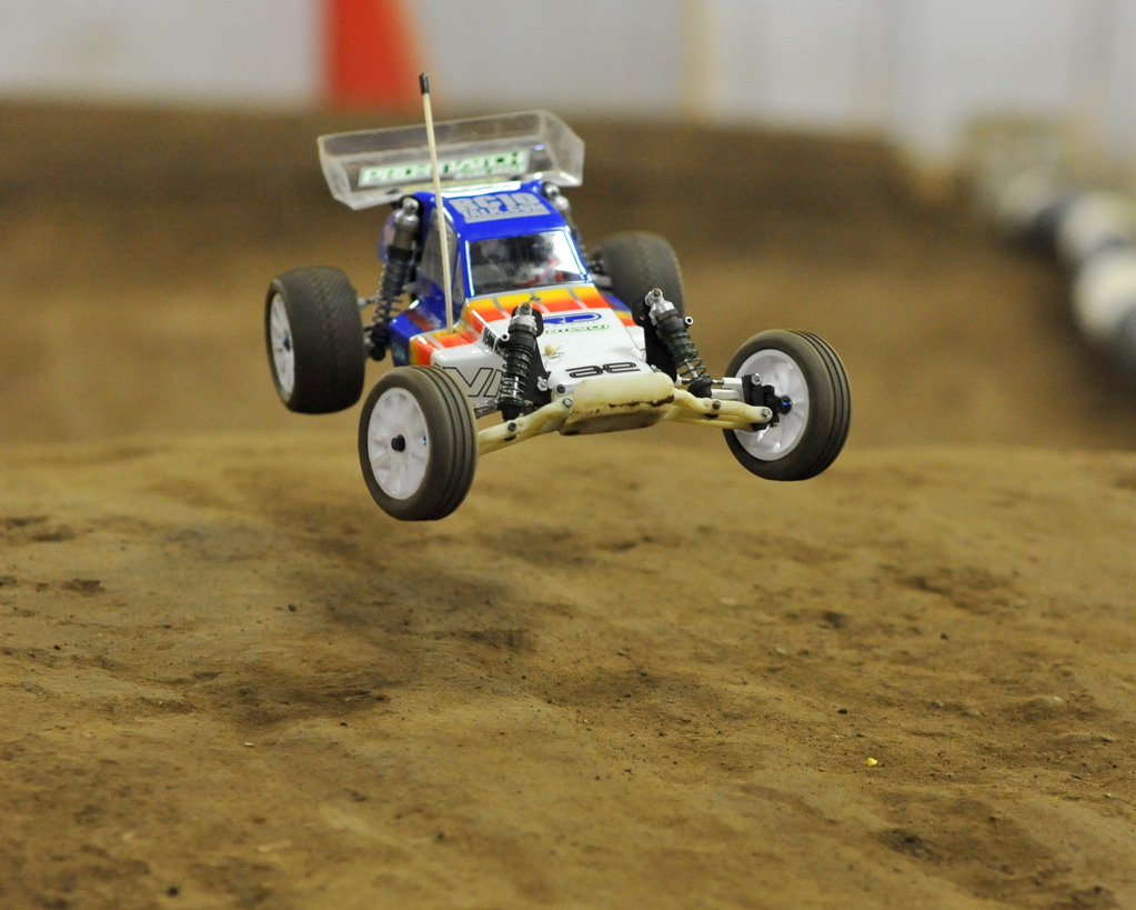

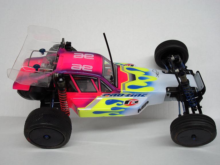

Guess I'll kick it off.
Runner Parts List
Rear
• Dynotech Klein rear arms (RPM worlds arm replica)
• 3 degree Andy’s arm mounts
• RPM RC10GT hub carriers
• 3/16” X 1/2" Avid bearings
• B44 rear CVA kit
• B4 rear axle spacers
• 3/16” axle shims (I forget how many on each side)
• JConcepts Rulux B4 rear wheels
Front
• Dynotech Klein front arms (RPM worlds arm replica)
• RC10T front nose plate and bulkhead
• RC10T2 front shock tower
• B4 caster blocks (drilled to accept 1/8” hinge pins)
• B4 steering blocks
• B4 kingpins
• B4 front axles
• JConcepts Rulux B4 front wheels
Runner
Shelf Queen

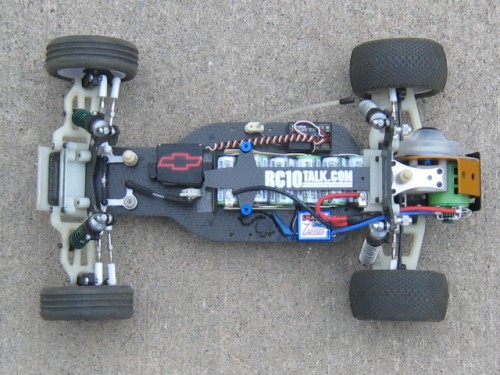

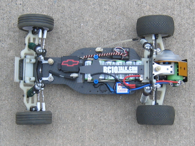

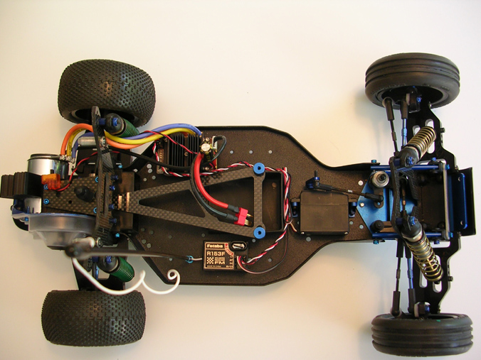

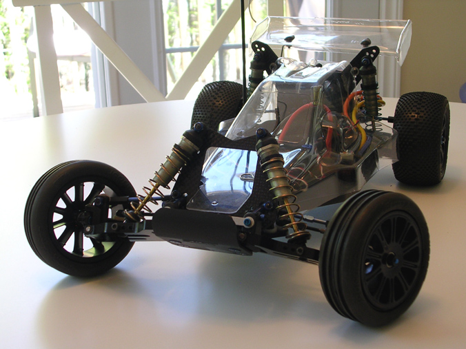

Alright. This is my completed car minus radio and esc. EDIT: Since this post I have added lunsford turnbuckles, carbon fiber front and rear shock towers and a houge steering system.
Parts List
Chassis parts
7305 Truck nose plate
7315 Nose brace tubes
6302 Chassis
Front
2701 Dynotech front suspension arms
3305 Rulux front wheel
8003 RPM "Worlds" front shock tower
7207 Truck front bulkhead
9622 Hinge pins
7774 New GT bumper
9580 B4 Caster block 25 degree
9577 Steering Blocks Inline
9623 FT B4 Front Inline Axles
Rear
2700 Dynotech rear suspension arms
3306 Rulux rear wheel
9756 Rear B44 MIP CVD
9608 Wheel spacer
70272 RPM rear carriers
4 - 3/16 x 1/2 bearings
Transmission
9601 B4 topshaft
9603 B4 slipper pads
9651 Spur gear
9604 Slipper hub x 2
9605 Slipper spring
RPM gear cover cap
Pics:
Another top view:
Rear view:

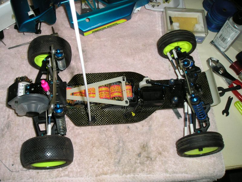

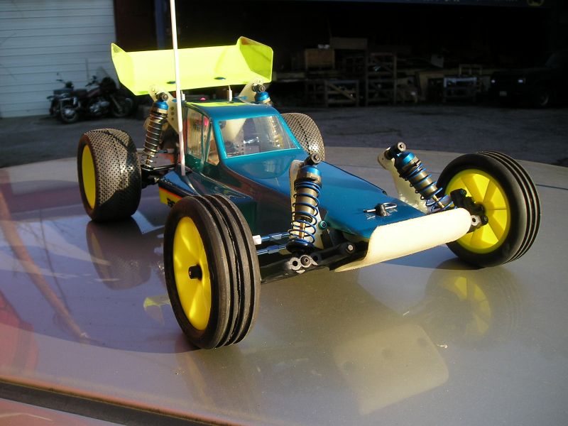

Re: ** What's Old is New Tech Thread **
mine....
chassis:
graphite team car chassis. kickup modified to use narrow bulkhead.
front:
rpm worlds front bulkhead
rpm worlds front arms (dynotech klein arms....... same thing)
andy's pro graphite front tower
rc10 castor blocks
rc10 steering knuckles (6220..... for aluminum axles)
wide gt front axles
b4 jconcepts rulux rims
rear:
stock rear chassis
rpm 10t rear bulkhead
10t rear tower (modified)
1.5 associated arm mounts
rpm worlds arms (dynotech klein arms..... same thing)
losi rear hub carrriers (2038)
b44 rear cvd's
b4 wheel spacer
kranzels .200 wheel spacer (needed to clear outer shock mount on the arm)
trans:
rpm 2.65 stealth conversion
robinson racing lightweight slipper clutch

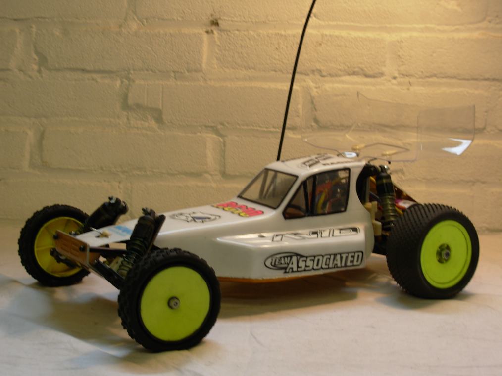

...And mine too minus the paint
Goldpan chassis
Stealth tranny
Kimbrough 81T 48P Spur gear
Associated Precision 21T 48P Pinion gear
Associated B2 body
Front:
RC10gt nose plate
RPM front bumper
GT Nose tubes
RC10T front brace
Worlds front shock tower from Fibre-lyte
RC10t bulkhead
Dynotech Klein arms
RC10 castor blocks
RC10 inline steering blocks (6220... for aluminium axles)
Wide GT front axles
B4 jconcepts rulux rims
JConcepts Groovy 2WD Front Buggy Tire Green
FT T4 Front shocks
REAR:
RC10 worlds bulkhead
RC10t shock tower from Fibre-lyte
RC10 arm mounts
Dynotech Klein arms
FT B44 rear CVA kit
Losi rear hubs
3/16” X 3/8" Avid bearings
FT B4 rear axle spacers
3/16” axle shims
JConcepts Double Dee's Rear Buggy Tire Green 2.2
B4 FT Rear shocks
Hardware: FT RC10 screws
FT 4-40 lock nuts
FT 8-32 lock nuts
FT shock bushings
Hot tricks antenna mount blue
Electronics:
Novak Havoc Sport 8.5 combo with a Novak motor heat sink
Futaba Magnum

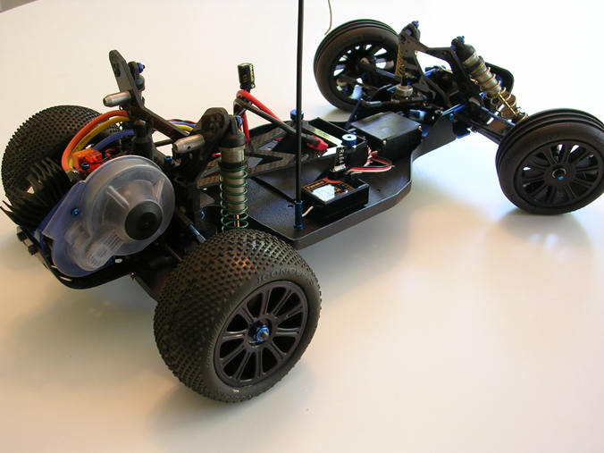

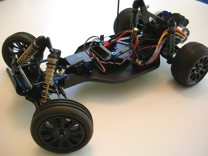

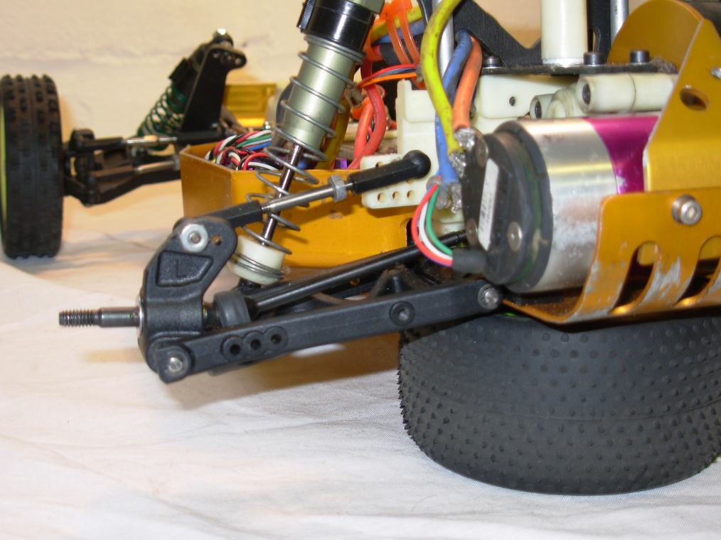

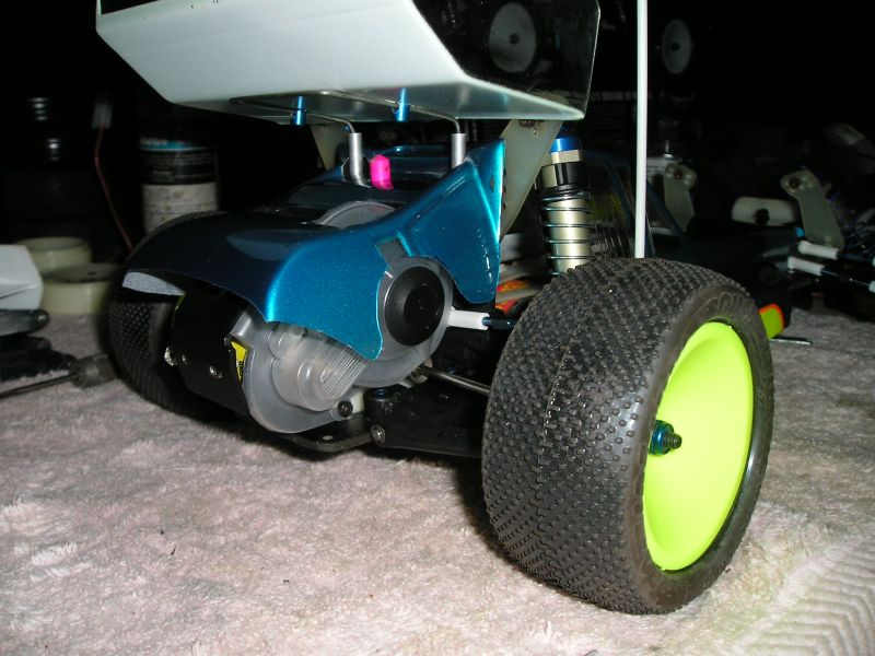

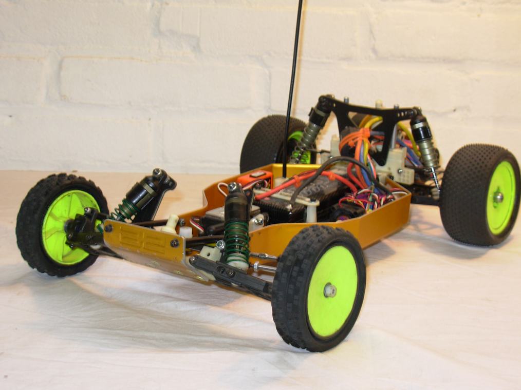

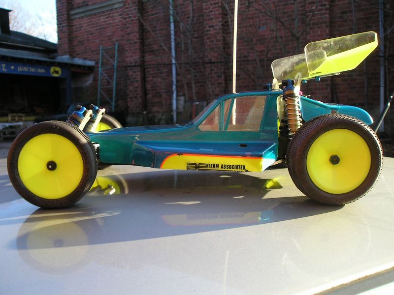

My Mutant thingy
Rear:
- Losi 'CR VLA arms, cut away "long hole"
- Losi XXXT VLA hubs, cut away "short hole"
- B4 axles
- Stealth tranny
- Composite craft shocktower ( I think )
- B4 rear shock
Front:
- Compsite craft shocktower ( I think )
- B4 20 deg hubs, drilled to make hingepin fit
( 20 deg is "-5" on a B4, so its actually a 25 deg on a RC10)
- B4 inline axles
Wanted to use "Hobby shop parts" in the rear for easy availability. It works, but to make it race legal and have usable droop you need to shim it 1,5 mm more to the inside as it would normally be on a B4
- B4 inline axles

Here is mine, it is now retired because I'm now running a stock Team Car and this one needs a lot of parts to be replaced.
Ingredients for the rear end:
- RPM or Dynotech "World" rear arms (long)
- stock wide chassis
- stock arm mounts
- RC10T hub carriers
- B4 hub bearings
- B4 inner hub spacers (do not forget these, otherwise the wheels will bind when bolted)
- B4 CVD's
- B4 outer axle spacers
- B4 rims
I use the "World" RPM front end with B2/3 rims
I even win a 6 hour enduro race with this car and a team of friends

I'll toss mine out there, even though it's not a '91 World's clone...
Chassis:
Graphite Team Car
Front:
RPM Team Car arms
Stock mounts
Stock tower
World's bellcranks
FT turnbuckles, JC ends
.71 Team shocks, MIP shafts
25º caster
Stock width alloy axles
B3 wheels
Rear:
RPM Team Car arms
3º rear mounts (T2 type)
0º carriers (Truck type)
10T shock tower
1.32 Team shocks, 1.02 MIP shafts
B3 wheels
RPM 2.65 Stealth transmission, B3 slipper
MIP B2 shiny CVD's
