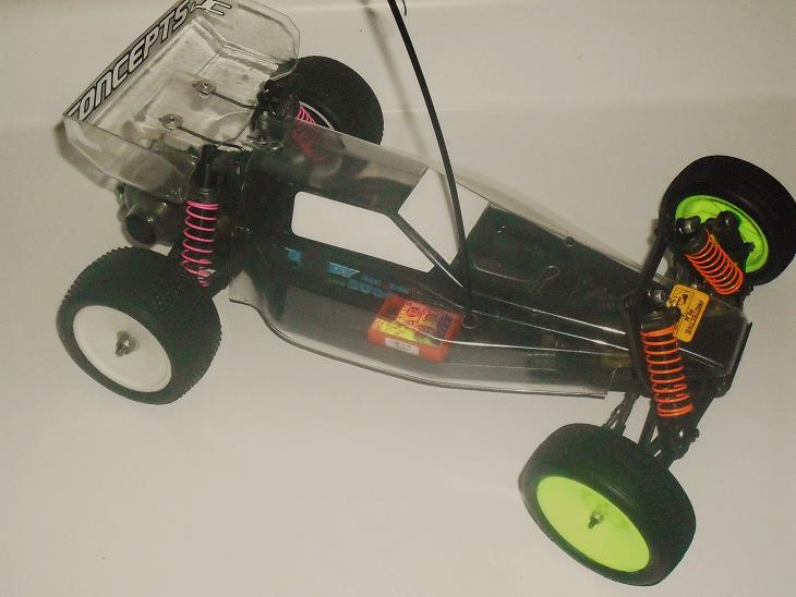

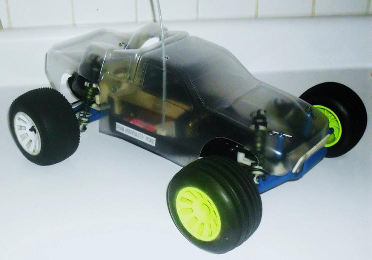

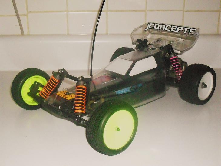

Here's 2/3 of Team Tecnica --
RC10T:
Reedy 5000mah 35C lipo pack
Novak GTB/Novak 17.5 BL motor
Novak Synthesized Receiver
Hitec Servo (might change)
Associated Quick Change Conversion
JC Rulux Wheels
JC Double Dees Rear Wheels
Proline M3 Edge Front wheels
RPM A-arms and body mounts
RC10T2 Body
Shocks/Springs: Team Shocks/35wt oil all four corners/Green Springs all around (might switch to Front Silver springs) Losi XX:
Reedy 5000mah 35C lipo pack -- Had to shave down chassis a bit to fit the Lipo
LRP Sphere ESC/Novak 17.5 BL motor
Airtronics Servo
NOvak Synthesized Receiver
Losi Front Wheels (Tires may Vary)
Kyosho Rear Wheels (Tires may Vary)
JC XXXcr Wing
Shocks/Springs: XXcr Shocks/Losi 35wt oil front -- Losi 30wt oil rear/Losi Orange Springs Front -- Losi Yellow Springs Rear(not pictured)
I also modified the slipper plate to accept a 72T spur gear and 29 pinion gear.

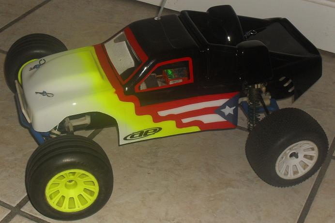

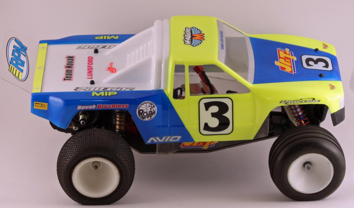

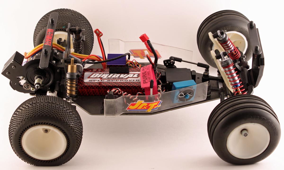

Here is #2 of 3, The JRX-T
Same basic ride as last year with a new lid, mcallister toyota. Gone are the old tekin esc, brushed motor and nimh, replaced with a GTB/ss, 17.5 and SMC lipo.
The trans has been freshly upgraded with a slipper clutch and a metal ball bearing diff gear.
Servo is a futaba 9404, and there is a spektrum mini RX under all the wires.
Rear tires as pictured are the j-conepts double-dees I ran last year. I've got a new pair of hole-shots on hpi 5-star white wheels.
rear shocks are hardcoated 1.2 bodies with 1.0 shafts,which seems to be a good fit for the tall towers with the rpm arms, I know the colors don't match each other, but those are the only 2 I had.

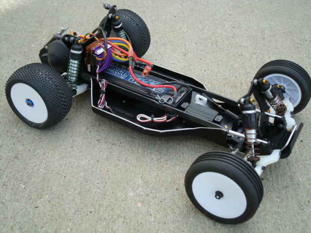

If I could make it, here would be your competition:
LXT with RPM chassis brace, 2.19 XX Retro tranny, Jammin' servo mount. Eletronics open, anything from brushless 17.5 to brushed 27T. Andy's XXT Soda Dodge Ram body.

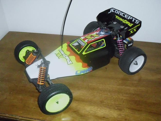

http://www.rc10talk.com/viewtopic.php?f=27&t=11090 : Pictures of my XX all nice and painted, ready to tear it up...

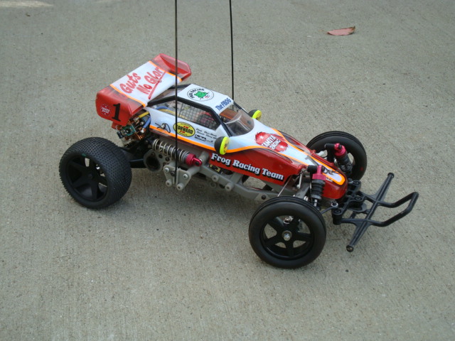

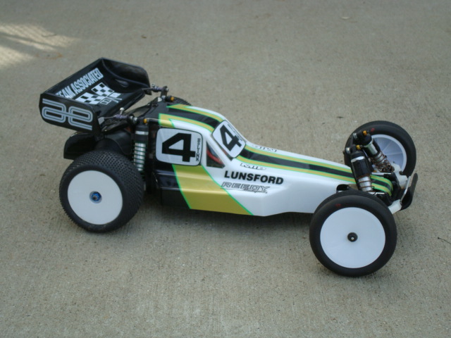

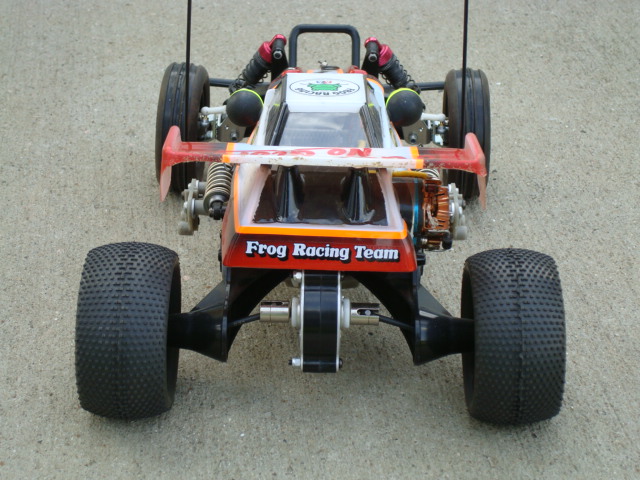

Here are 2 of the 3 I plan on running. The Supershot STILL needs paintwork done.
The Frog will be back. I have since put on HPI 5 star wheels. Looks better and widens the rear track considerably too. Added Tamiya CVD's, and I plan on replacing the stock steering links with turnbuckles and regular 4-40 ball ends.
