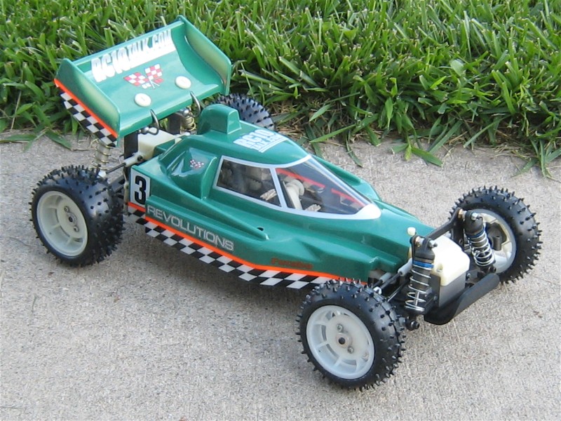

I am seriously thinking of adding the hop-up shock kit to my Hotshot for 4wd:
2wd may be my Rad2. I have to try a different motor in it as the silver can/XL-1 combo in it now is painfully slow and I need to see if I can get it up to par:
I haven't decided if the Grasshopper will make a Classics class return. I may have a Marui Samurai restored by then-- would that be a Classic or 4wd? The kids have also volunteered their Frog but three classes may be too much.

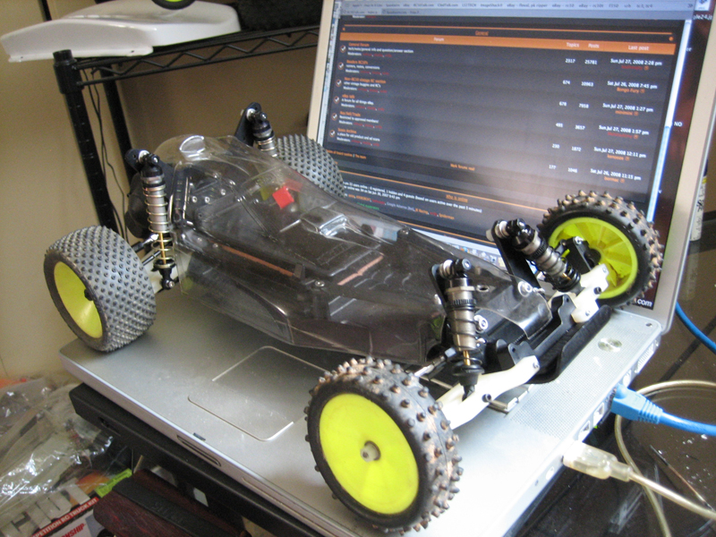

Post by markt311 »
Mine's almost ready to race, sorry for the cell phone pic

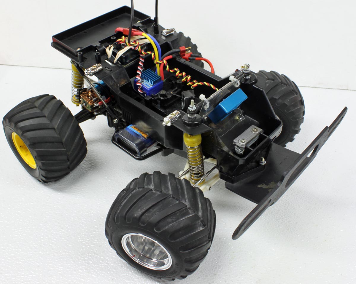

Post by aconsola »
one down 2 to go.
This is a re-release lunchbox with a parma lexan body, CRP front end conversion, CRP and hpi rear hubs combined to widen the stance, JG kydex front bumper, original Tamiya yellow oil filled shocks with 15wt oil and losi grey/1.6 springs in the rear and 40wt oil with heavy clod springs up front. The rear has a short kyosho gold shock in the center for the "3rd shock mod," as well as tecnacraft ti turnbuckles for the chassis braces front and rear. More tecnacraft rods for steering and camberlinks. The front wheels are SEES, intended to help keep the front end planted a little better, aided by about 1.5oz of lead in the nose. Full bearings throughout and all 4 wheels have been balanced with lead weights so it doesn't bounce all over on the flat sections.
Electronics include a Hitec hs625mg servo with large kimbrough servo saver, Trinity stock motor, LRP quantum super reverse ESC, a reedy 3000mah nimh stick pack, and a losi/spektrum RX.
It is ready to race, unless I somehow find some more aftermarket parts before september.
