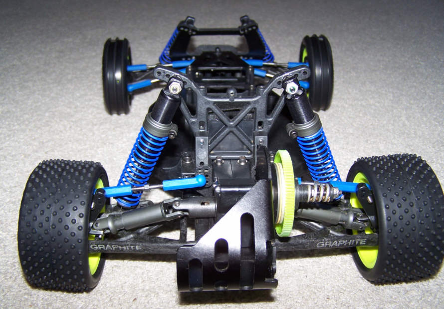

bormac wrote:What I would like to end up with is a retrofit trans that runs the original slider driveshafts. I would like to atleast keep those original to this car so I wont be needing the dogbone driveshaft parts.
hello Jason,
I beleive the retro fit trans uses the same internals as the XX transmission. If this is the case, then you can use the outdrives from the XX sport. Below is a picture of the slider outdrives on the xx trans. Sorry, I no longer have the car nor do I know the part numbers. I think there was also a slider conversion for the xx.
Regards,
Roger
