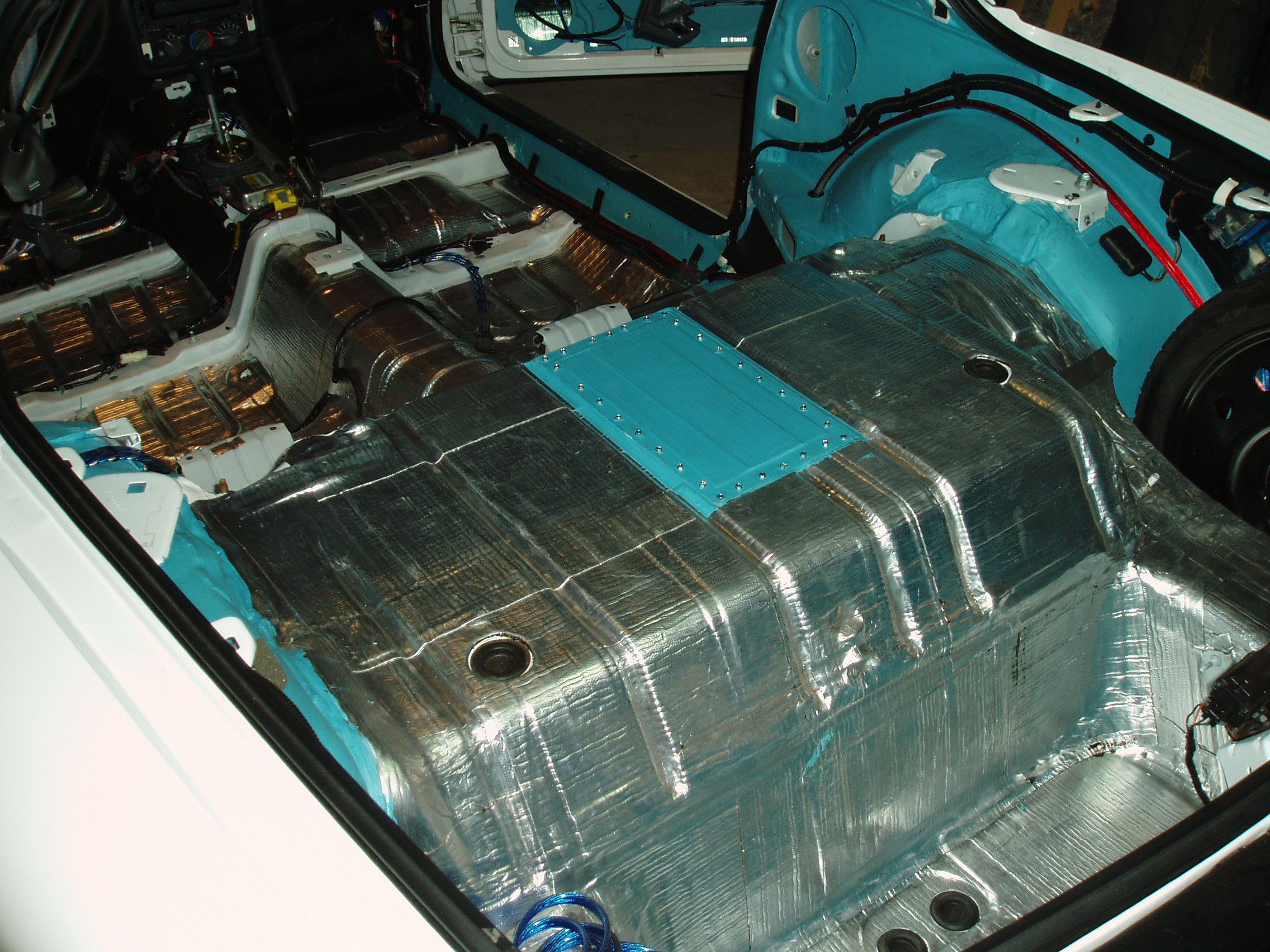

i agree 100%, but also consider that the late 70's and through the 80's, and certainly now cars became increasing harder to maintain. it seriously took me about 4-5 HOURS to change the spark plugs in my 98 firebird (most that time on the #8 plug...).jwscab wrote:...i find it disturbing that people just can't understand that mechanical and electrical devices need MAINTENENCE. I think that some weird mindset happened in the late 70's and 80's that magically, everything suddenly needed noting other than putting gas in it, then complaining when something went wrong.
e.g. why the HELL design a fuel system that uses a fuel pump in the gas tank that will eventually go out, and instead of incorporating some sort of access hatch in the floorpan of the car to get to the fuel pump, you have to drop the exhaust and the tank to service?
i saw that problem coming when i installed the stereo, so i cut out an access hatch for the fuel pump:

Honda had an access hatch on their cars in the late 80's then decided not to do it anymore. Sure made it easier when there was one.badhoopty wrote: e.g. why the HELL design a fuel system that uses a fuel pump in the gas tank that will eventually go out, and instead of incorporating some sort of access hatch in the floorpan of the car to get to the fuel pump, you have to drop the exhaust and the tank to service?
