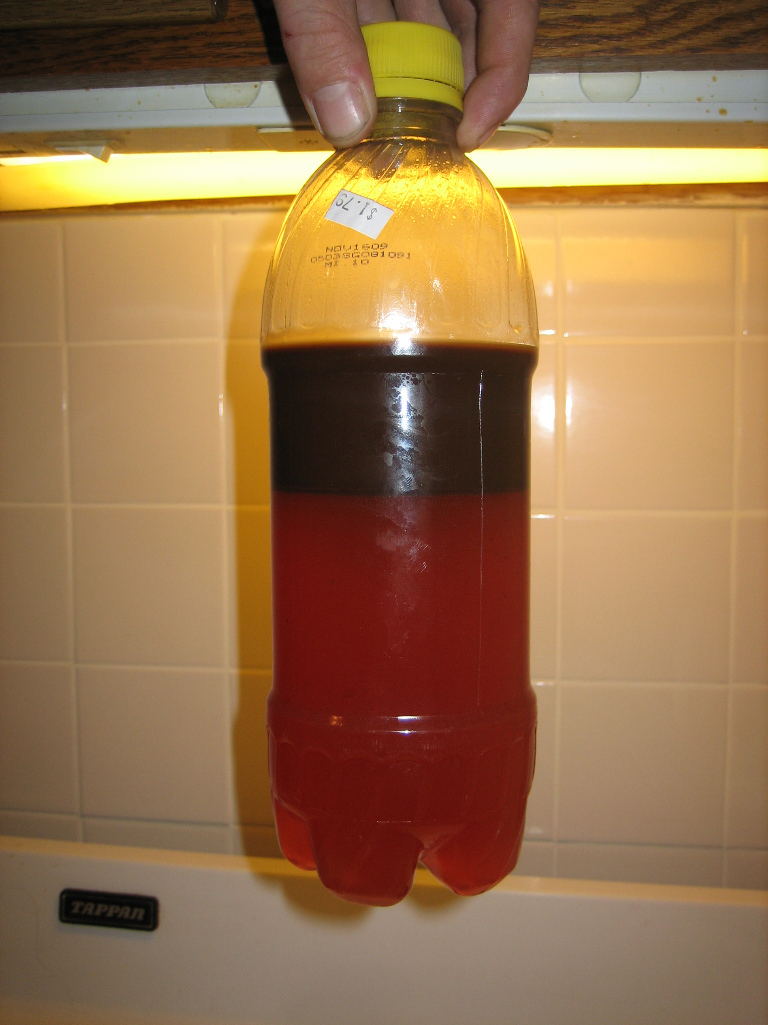

while smoking crack, gm engineers decided a power steering cooler routed inside a radiator hose and using 200 degree coolant to disperse the heat of the power steering fluid was a good idea.
while cutting a buck, gm then builds the system so crappy that it fails at 70k miles.
while getting my car ready for the nats, i now have to deal with this: not the most encouraging thing to have to deal with right before a 1k mile trip...
and while again smoking crack, gm makes a new coolant that if allowed to 'spoil' chemically breaks down to create the most slippery and yet sticky substance in the universe. this came out of my overflow tube.

i'm 99% sure that the slime is only limited to the overflow tube after being subjected to many many wet/dry cycles over the course of 10 years. that slime in the pic was it, it aint like theres more i'm digging out, thank god... i flushed the old dexcool out at around 45k miles, and i can remember the old stuff still looking pretty healthy.
radiator petcock, radiator cap, all the rows inside the radiator (that i can see), and thermostat are all clean as a whistle besides the oily film of power steering fluid i'm flushing out... next time i drain, i'll pull off the radiator hoses to see if there is any slime in there, since it may be something to do with being in contact with rubber or something.
i was pretty bummed out last week when i discovered the leak, but i'm pretty sure it's all fine now that i've torn into it and started flushing the coolant. i'm lucky to catch the power steering leak as soon as i did, some people have either neglected the problem or have foolishly kept topping off the power steering fluid and eventually had coolant enter the power steering system, which creates all sorts of fun...

I heard that Dexcool turns into sludge when exposed to air. Apparently this happens if there is a leak. Hope everything is sealed up now.

yeah, after ALOT of reading on dexcool issues, it seems like my slime isnt at all what the 'typical' dexcool issues have been with most other people.

you are 100% correct. The biggest problem with dexcool and other high mileage anti-freeze products is that they are designed to be a fully self contained system. You are NOT supposed to open the systems on them. They are tested in labs under very strict guidelines and they are not opened. Therefore they can say it will last 100,000 miles or whatever the current claim is.RichieRich wrote:I heard that Dexcool turns into sludge when exposed to air. Apparently this happens if there is a leak. Hope everything is sealed up now.That reminds me, I have to change the oil on my truck, replace the shocks and fix a transmission mount that a friend broke when he replaced the clutch.
