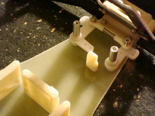

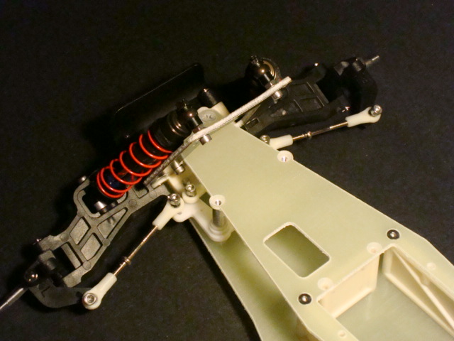

Build 5
Notes: The steering bellcrank comes with plastic bushings but I opted for some Avid bearings instead. The shocks went on without any problem, and are nice and smooth. I will have to replace the "Slash" oil with some lighter weight oil eventually.

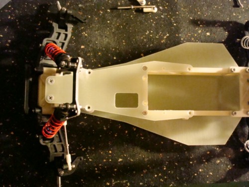

I had reservations about the strength of the fiberglass chassis. It became kinda floppy after I started to bolt the pieces on it, so I mocked up the front stiffener. It does a very good job of tying everything together and makes the whole assembly ultra rigid. Hopefully you will never have to replace the steering link from the servo as you would need to remove this brace to get to it.
Bellcrank installed
Bellcrank installed
Front shocks installed

One very stiff chassis
Not much room for wrenching

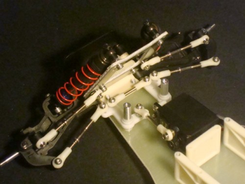

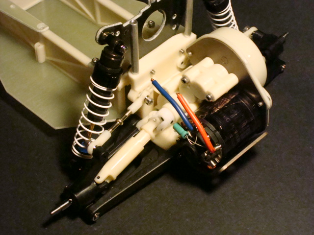

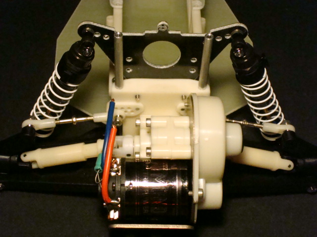

Build 6
Notes: Nothing out of the ordinary here. The white outdrives on the tranny were a PITA to get the spiders in. I wish Traxxas would have made the hex on the turnbuckles a little wider. Seems like adjustments on these things would round the hex off quickly as they are.
One other note: The exploded view suggests the rear camber links bolt to the back side of the hub. I went in front, as it just seems more logical. Close to the shock spring, but still plenty of room to clear.
Sliders and rear camber links installed
Steering links installed

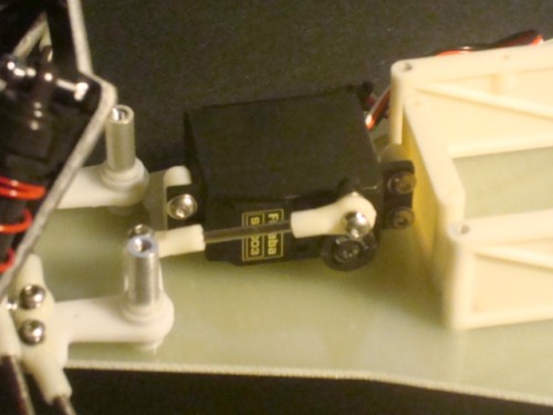

Build 7
Notes: Everything basically is together now. Ultra rigid chassis as I mentioned before. The battery strap was a missing piece out of my kit and all I have been able to find is a black one. If anybody can line me out with a white one, let me know!
Servo in place.
Servo in place.
All front suspension links installed.
Front brace and battery strap installed.

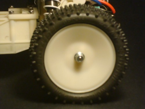

2.2" wheels with Proline rubber

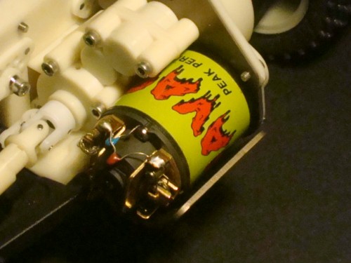

I swapped out the Diamond Power motor with this Peak Performance modified. Thought it fit the car better since it is more in the same era and Traxxas' affiliation with Peak...
