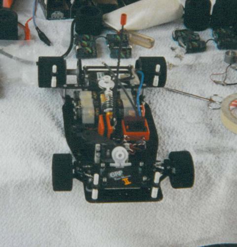

- Bud Bartos
- Regular Member
- Posts: 11
- Joined: Wed Dec 02, 2009 9:52 pm
- Location: Amherst Ohio USA
Re: WC1982's 1/10th scale thread
Thats right Bud's super machine II That thing had all sorts of adjustments !!!! Yes I think it was but ours would fit the associated cars and I don't beleive the Trinity one did.
- drbelleville
- Posts: 815
- Joined: Wed May 20, 2009 5:03 am
- Location: My Adopted state - Texas
- Been thanked: 4 times
No the trinity was really narrow (it would not fit the 10L SS even) , they had the EV10 chassis which ran the cells down the center and was a "link" Car. What are the chances of those coming out again?
I imagine like the Trinity they require a bunch of maintenance.
Thank you
Thank you
- Bud Bartos
- Regular Member
- Posts: 11
No not much maitanance, but the average racer didn't really know what all the settings did. Caster, camber, roll center, chamber and caster gain !!! That front end had more adjustments than a real race car
