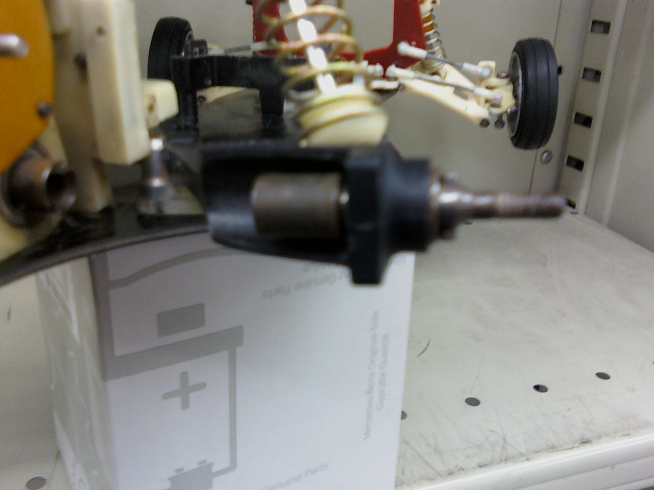

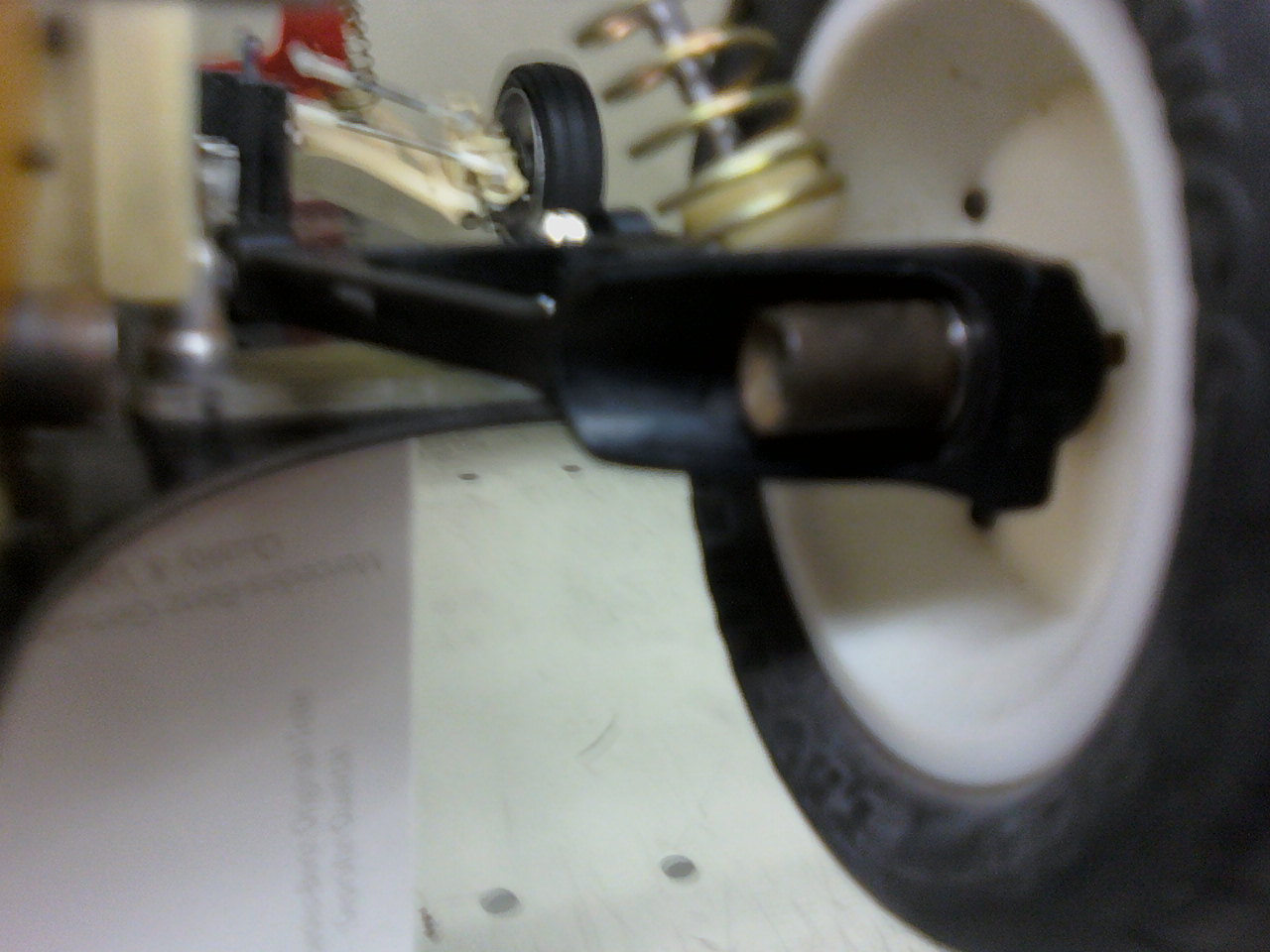

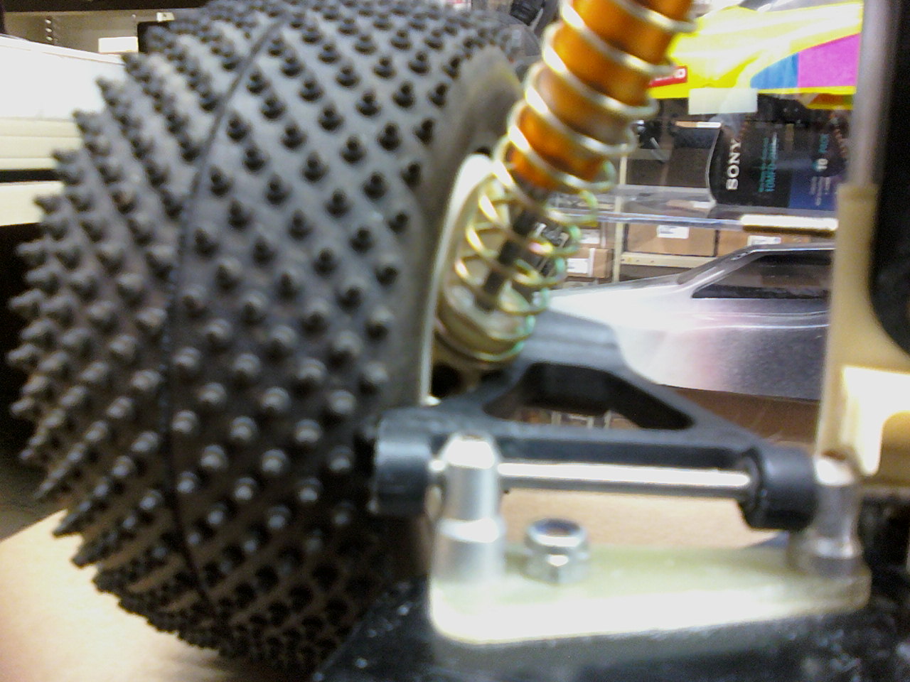

First 2 pics are different angles trying to show the RC10T tire hitting the arm and the wheel touching the shock. The second 2 aren't so good but may show something the first two don't. One thing that crossed my mind is thet the arms may be on the wrong side. Do they look mounted correctly? Lmk.

Re: Houge RC10 Info
problems:
1) don't try to use 10t rims on something designed for a buggy rim. if you want to use a truck rim, you need to use something actually designed for use on an rc10.
2) i can't see how the top of your shocks are mounted. but it seems to me that you have them mounted on a&l shock mounts. take them off. then mount the shocks on the backside of the shock tower. the shock should be pretty much vertical when looking at it from the side.
3) is the houge arm and a&l arm the same? i bring that up only because you have houge arms on a&l mounts. that could screw up the whole geometry of the rear suspension. never mind dogbone issues.
4) i also see the buggy rims your trying to fit on the car are the 3 piece 2.0 rims. sometimes the angled design of the inner piece interfiers with suspension components. you'll have to use a 1 piece rear rim.

I have not had any problems with tire rub on my car. The top of the shocks are laid over as was previously described. Mine however, are mounted on the front of the shock tower. Also, something you can do when you get it all worked out for your bottom mount- Take your 4/40 screw and dremel the head almost all the way off (and flat). Notch it like a slotted screw and run it through the arm from the back. Then you put the bottom of the shock on the screw and secure with a lock nut. This will prevent the screw from pulling out of the plastic arm. The head has to be cut down for this to work though. Otherwise it will hit your stub axle (CVD).
- jwscab
- Posts: 6580
- Location: Chalfont, PA
- Been thanked: 505 times
Re: Houge RC10 Info
like Scr8p said, you have a bunch of incompatabilites going on there. The easy way out is to use A&L arms, since you already have the arm and shock mounts. I don't know if the truck wheels will work with the A&L stuff though.
or, alternately, use the houge arm mounts, and take off the A&L shock mounts. Stick with buggies wheels.
Re: Houge RC10 Info
Thanks for all the info. I'm a little late to the hobby and don't really know a whole heck of a lot about the Houge or A&L stuff. I took for granted that what was on the chassis was also Houge, so the mismatched parts explains the problems I'm having. I'll move the shocks outward onto the tower and see how that goes, but Im sure I'll have to pick one or the other. If it's possible could someone post a pic of an original Houge setup and one with an A&L so I can see what components I need to change.
