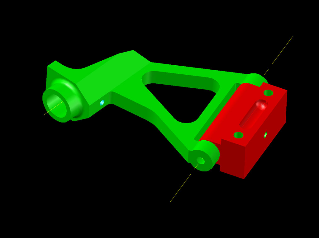

In my quest to help a few members here, I myself designed a replacement arm that is machined from billet aluminum that was stronger than the injection molded Houge arm, and made to work with the standard Houge chassis, but without the need of the standard shim washer everyone had used to correct for the sharp camber angle. My design was different enough that I had to give it my own name of Ruf-Trailing Arms, and also so-as to not incur in any legal problems with Houge. You can see the progress in this thread HERE and the final resulting model images.
Only two sets of these have ever been made to my prints; Jeff Harris here has one set and maybe he can post a picture of his mounted to his car after he had them black anodized, and I still have the second set with me as I lack a Houge Chassis to mount them to.
My arms are designed to be run hard without the fear of breaking, twisting or bending under the harshest track jumps we find today, even when landing on the edge of a tire. You would find that you would snap the 8-32 aluminum screw holding the arm mounts to the chassis before you did any damage to the arms themselves.

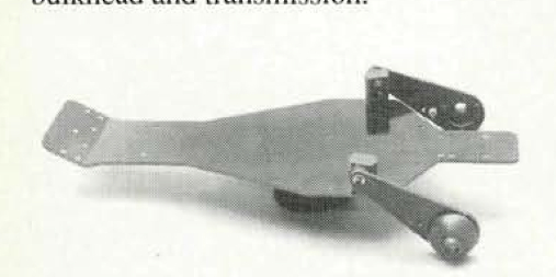

I don't want to detour from the thread theme but I wandered If Ruffy or anyone knows a bit more on the Andy's trailing arm design. It is very similar to a Houge design, the chassis mounting is almost the same.
image from Asso_man!'s stable

I have the same setup as you but my instructions state it is for a standard stamped chassis.

I remember at the Nationals one year, Houge had a bunch of prototype cars with his drivers, and all the cars had arms made of aluminum front and rear. The thing is that those rear aluminum Houge arms I saw as I held more than one of the prototype cars in my hand, were exactly like these Andy's arms I have seen around the net and pictures like the ones posted here by M_Vice. My guess is that Houge was starting to back out of making any more production trailing arms (the aluminum ones were strictly prototype as they were machined and not cast like the A&L arms, as the cost would be too high) and sold his design to Andy's, which Andy then took and had production injection molds made for these, and he also molded the chassis instead of having a carbon fiber one made.

the andy's trailing arms and mounts are quite different than the houge pieces. i don't see how they have anything to do with one another, but that's just my opinion. i have no back story to go along with it.......

The arms and the mounts design is quit different but the chassis are very similar. Mounting location and everything, you can mount Andy's on a Houge chassis and vise versa but you end up with different wheelbase.

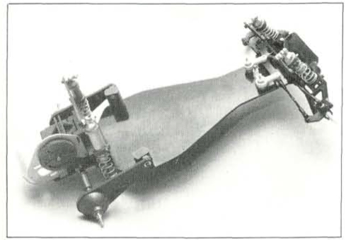

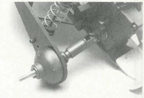

Has anybody ever seen the Bullet Racing trailing arm kit? I'm curious how the durable the arms were, the mounts and pivots look pretty small.

mrlexan has one, and i'm pretty sure cedric does, too.

well, that means the mounting location is different between the chassis', too. :wink:
