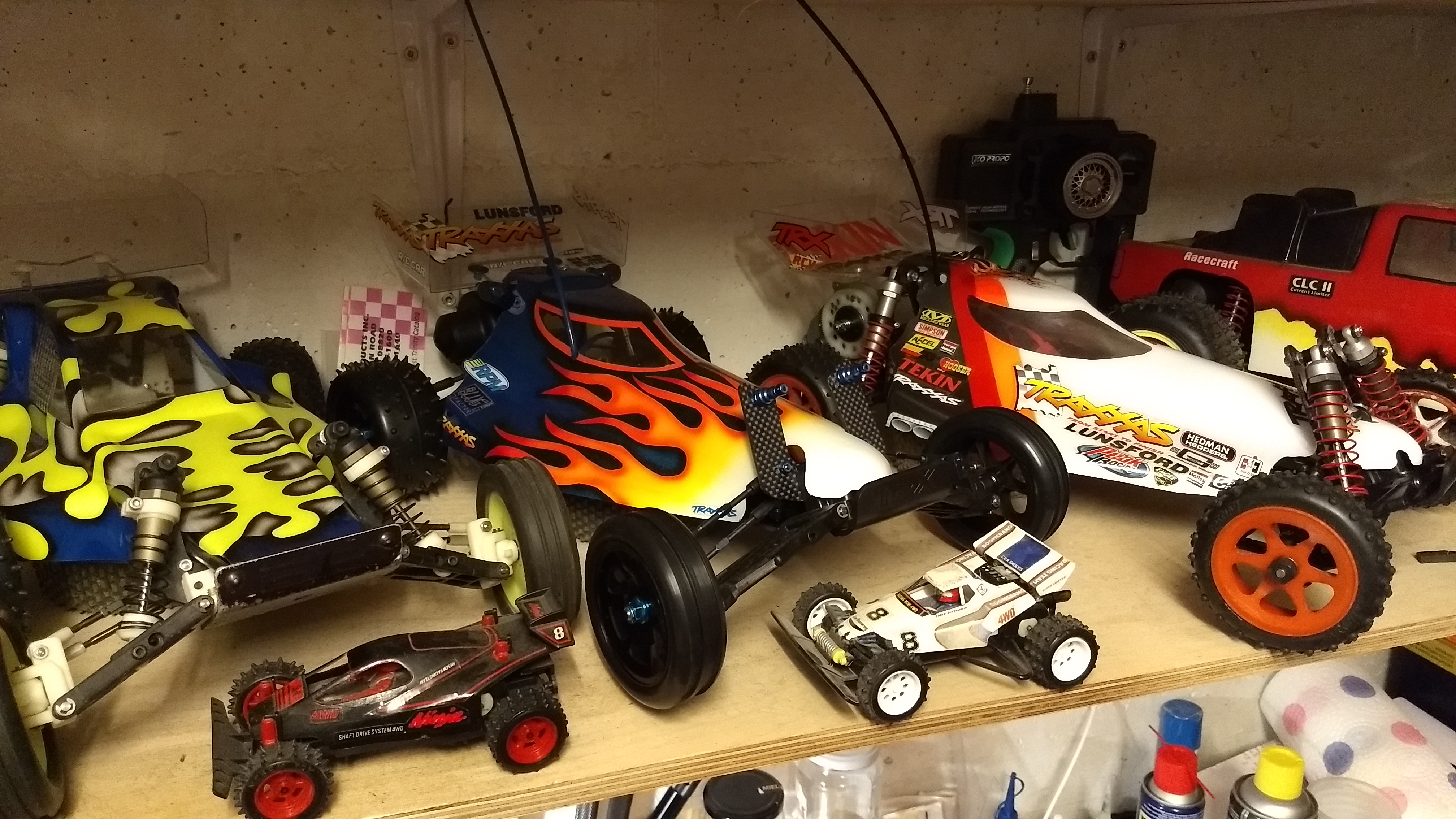

Long overdue update... Due to other priorities, I got very very late with this car, missed the end of the indoor season and completely neglected this thread
I am 99% done with the car, so here's a few pics to beg forgiveness. I'll post more tech info later on this month
and now with a couple of other cars
and a very anachronistic comparison

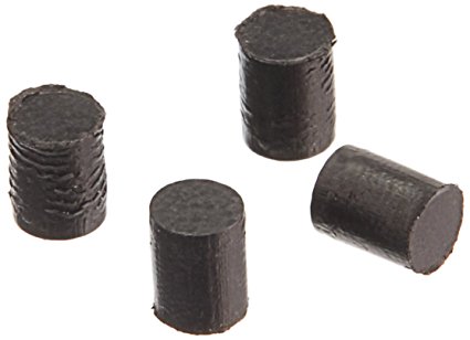

Can anyone please help with the slipper:
What am I doing wrong? was anyone running the stock setup bitd? Any recommended aftermarket parts that make it better other than Jeff's clutch - which is a vintage design, maybe not as easy to work with as the newer stuff?
Thanks,
Paulk

my trx1 seemed to be OK with the rulon pegs. I may have added as many as fit in the gear, beside just a single circle of them. I never heavily raced i though. ran it with something like a 15 turn or maybe 14? been too long.

So to drag up the shock diaphragm issue. Yes the diaphragms are hard to find for the original shock caps. The only ones floating around out there in quantity are either for the "big bore" shocks (TRX-3) or maybe their "ultra" shocks.
I have had success with:
Bladder in cap, fill shock body until oil forms convex meniscus at top of body (piston down).
Place cap on body and screw on just until the treads mate enough to keep it on.
Tilt shock slightly (imagine that you are the air bubbles and want to get out) push piston / shaft upwards to force out remaining air (same distance for each set of shocks), then tighten the caps.
With the slipper issue. Are you using the older style "red rulon" slipper pegs or the newer style "black and more grippy pegs"? I have noticed that the old red ones that can still be found have hardened and in some cases seem to have gotten shorter, which messes up the frictional properties and causes the spring tension to "build" within a narrower window.
The red rulon pegs seem to have been press molded whereas the black ones look like they were extruded.

Thanks Joe, Mark
The STRC shaft looks like what I will have to install indeed. I need to ensure I have a top gear to drop it on, the issue is runing a metal one which is the only one that holds - they are expensive and the last one i tried to fit on the stock TRX-1 shaft I actually had to use a vice to slide on... quite a traumatic memory, really
I use the red pegs, "only" 12 of them, not using the outer ring - and indeed they are short as heck and they fill hard as a brick. Is the part number for the new ones 4685, too? Would like to give them a go before I go through the traumatic top-gear swap
For shocks - I used about the same procedure as you described. Bladder shocks for offroad , the VC just doesn't work right for such volume variations. So emulsion will do just fine, as bleeder caps seem to fit I will give them a go

https://m.ebay.com/itm/Traxxas-4685-Slipper-Friction-Pegs-12-for-T-Maxx-2-5-Nitro-Rustler-Stampede/362111217073?epid=1300555714&hash=item544f82adb1:g:yAsAAOSws8VZ4m5O
They look like turds but they work OK

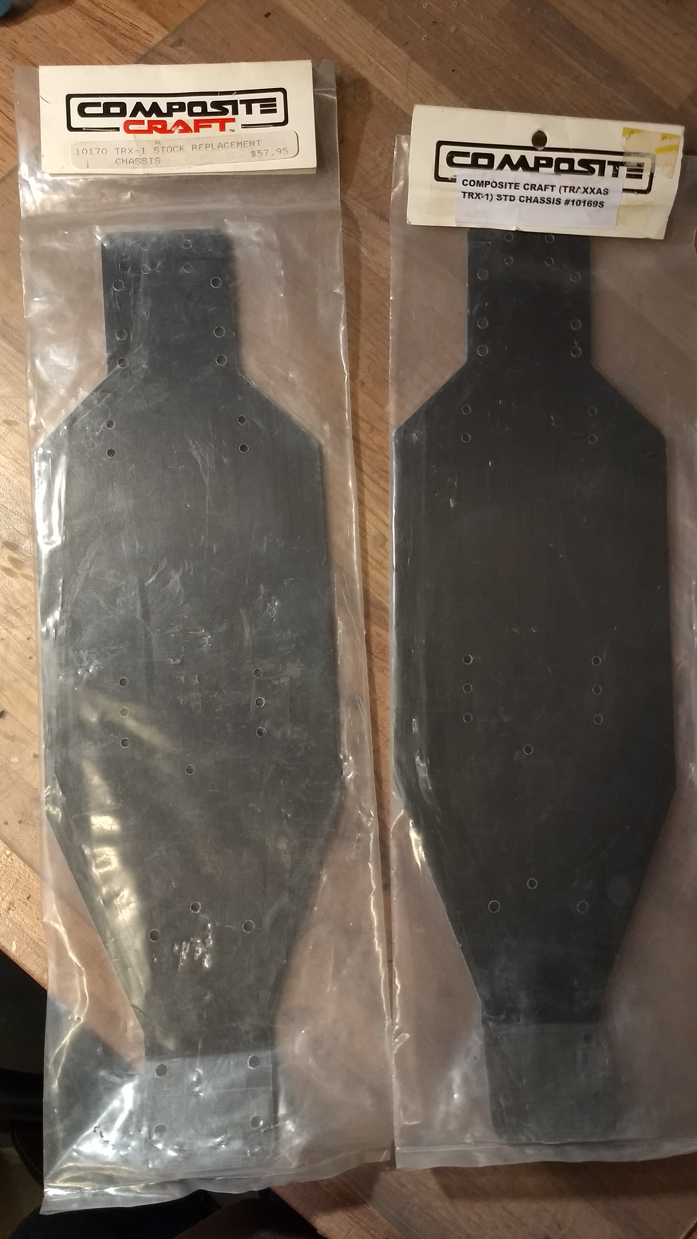

Strc shaft ordered, car finished for now!
Look what i found in the stash
And a group short of three cool 2wd's
More when i have a proper PC!
