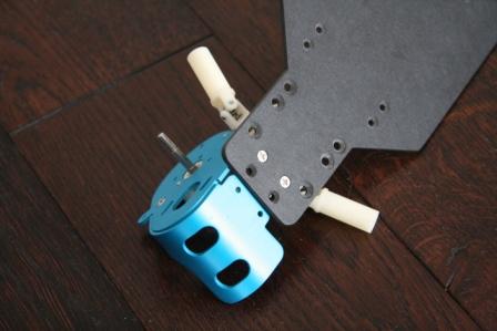

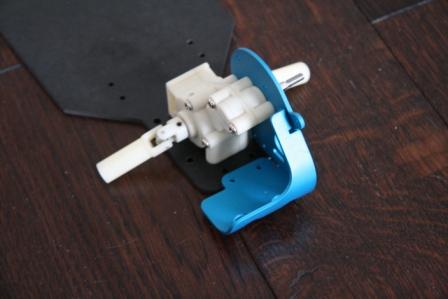

Hi Scott,
I started to build my own vision of your World finalist TRX1.
Your rear arm mount looks to be machined as the gear box.
But the motor plate you used comes from the Blue Eagle.
So I drill and build the thread in a Blue Eagle motor plate to fit the TRX1 gear box.
But when I assemble it on a regular TRX1 chassis, this one looks too short.
What looks to be wrong ?
Your chassis are longer as the TRX1 production car, or I'm out with my theorie ?
Thanks
Cedric
