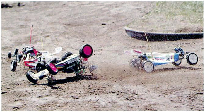

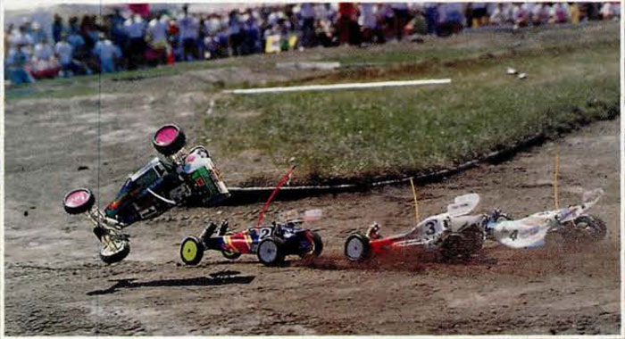

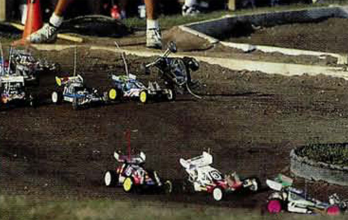

some pics from the mag.
My first buggy racer was a Traxxas Bullet and had a hard time keeping up with the RC10s so I made the switch to RC10 but always wanted a TRX-1.
I am currently re-living my childhood wrenching on old RC10s and planning to build one base on your car so I am really looking forward to the photos.
Thanks again.
