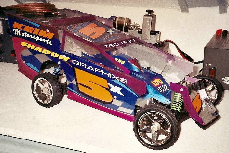

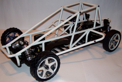

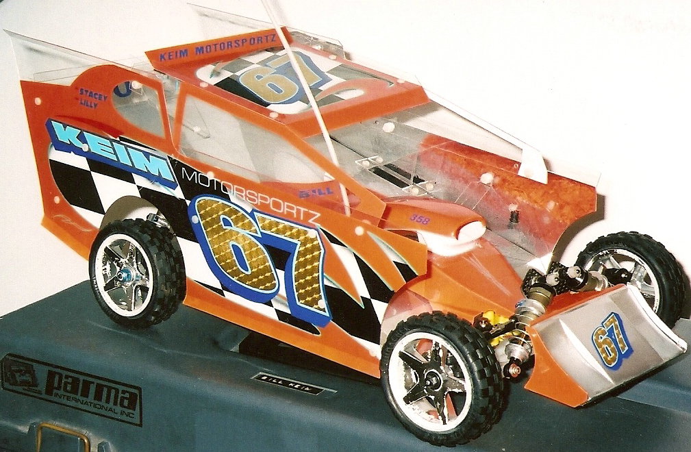

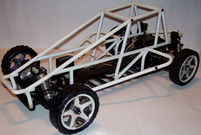

I never would have guessed that the spiked tires would have worked!
if you think spikes wouldnt work check out what we run on polished concrete:
