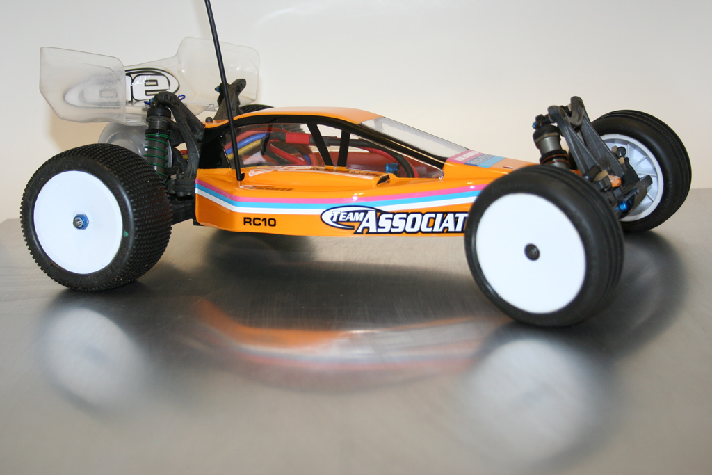

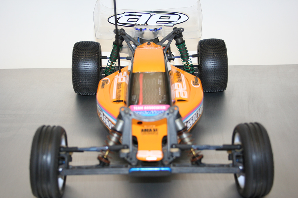

I finally got around to painting my B4's stock body, and at the last minute decided to try another vintage boxter look with a modern touch. Up until now I have been using a borrowed body from Jeff Harris.
I haven't had or found the need to do any of the things you have mentioned lonestar, but then again I have always found that I have never had to use aftermarket products or make changes to Associated's RC10 buggies to make them better, last longer or be more competitive. I've grown accustomed to just always running my buggies box-stock. I've been running mine box stock and it has been a fantastic racer. Nothing needs changing still, just wheels and tires as I wear them. I'm even running all my cars with an Airtronics CS2P radio on 27mhz FM.
