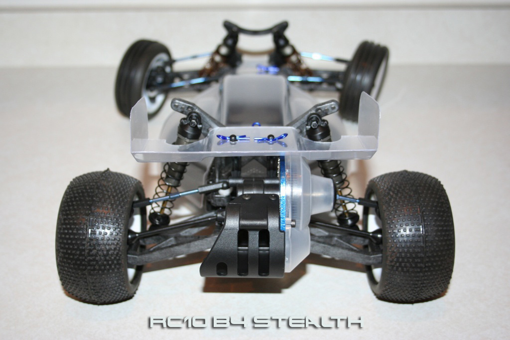

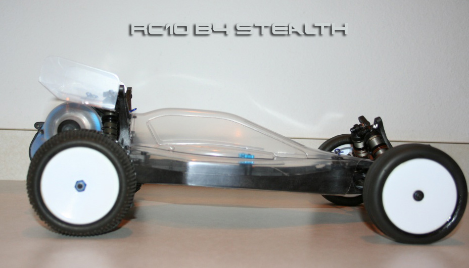

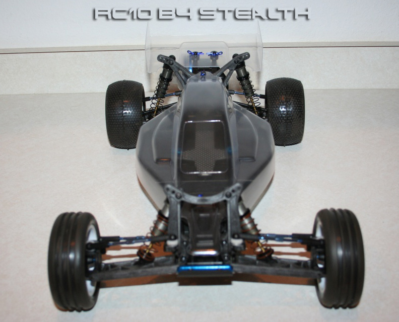

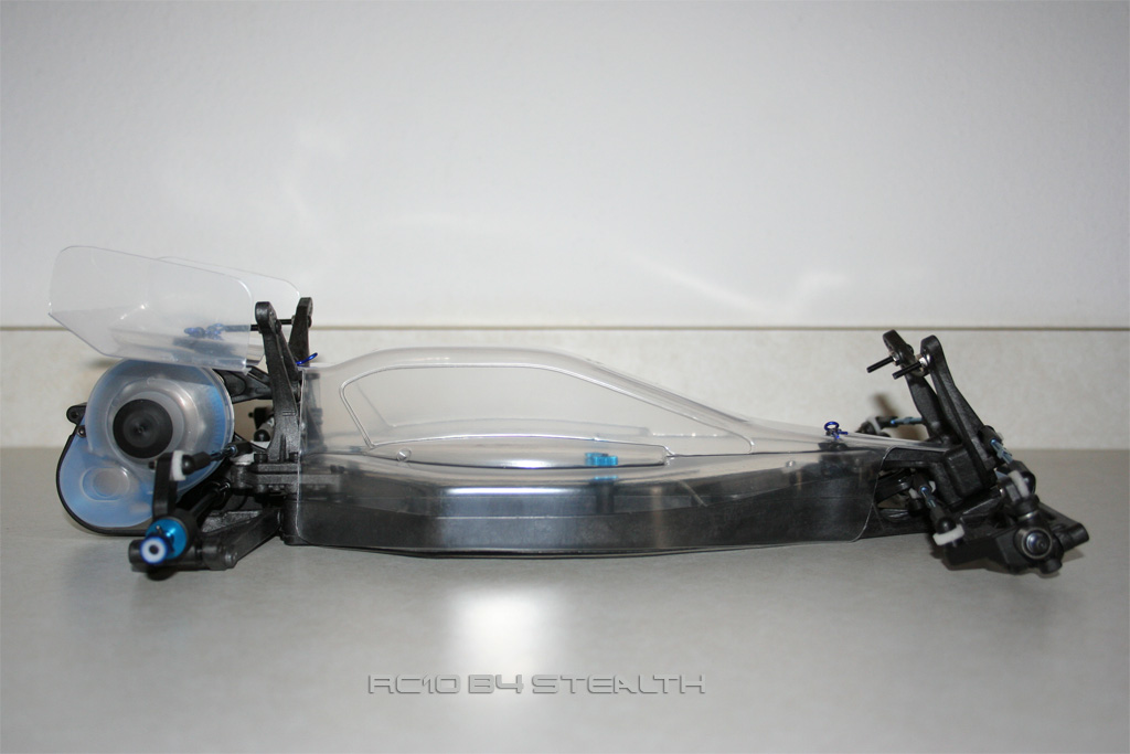

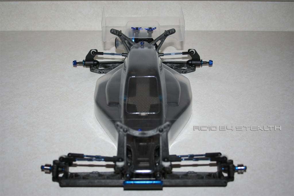

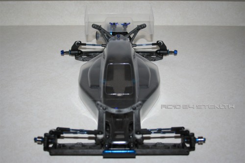

I know it isn't vintage, but I bought a B4 Factory Team kit just after joining these forums and after I just started racing again and am finally building it. This is my 1st B4 build, and completes my entire collection of RC10's from the Edinger version all the way to the B4 in sequence. This will be the only one that gets modern electronics though for racing as I am ordering an LRP SXX ESC with an LRP Vector X12 8.5 mod brushless motor.
Should be interesting, at least for me, as I initially bought this to study and learn about the new B4 to see what makes it tick. Does anyone have the ad picture like the one above but when they still had it covered up?! I remember seeing an ad once like that in a magazine, when I went to buy something at a local hobby shop.
My 1st RC10 Stealth Car; Code name: The B4

My kit has gone together like clockwork, hands-down of all the kits I have put together over the many years I raced every single week since 1985-86 until I retired from racing; I would have to say the B4 is the kit is a well manufactured kit. I looked for areas to improve upon and other than a very light ream of the arm hinge pin holes and removing of very light flashing on the front arms where the shock mounts, this kit is perfect.
The way the components snap together within bosses makes for an error free and clean assembly.
To ream the hinge pin holes, you can use a drill bit that is the same diameter as the hinge pins and a hand chuck. Turn by hand only, don't use powertools for this as a little too much is usually way too much.
The shocks, with the Assoc. bleeder caps are definitely a lot easier to get right on the first try now.
Shocks
Build continues, I got the shocks assembled and on the buggy per their instructions... I only added the bleeder caps. To get the springs to sit properly "all" the time on your shocks, I recommend using an exacto and separating the ends that have the coating on then from the spring if you have to. Sometimes this coating prevents the spring from resting correctly on the shoulder of the adjuster.
Tires and Wheels
Before bonding the tires to the rims, using motorspray and a rag I cleaned the mold release from the tires bead area where it will come into contact with the wheels. I then cleaned the wheels using the same spray and a rag, rubbing it through the area where the tire bead will bond. This removes the mold release from both components that need a good bond. I can't tell you how many times I have seen tires come off the wheels during racing, because the mold release was not removed. Using rubber bands around one side of the tire, I then apply a small bead of Locktite's Super Glue adhesive around the circumference and rotate the tire a few times to try and get equal distribution, until the glue starts to "slow" down or thicken. Then just let them set for awhile as you move to the next tire to bond and when you finish one side on all 4, you should be ready for the 1st tire/wheel again to do the other side and start the process all over again.
Shocks
Tires and Wheels

I'll have to try the bleeder caps sometime.
Any problems with the rear suspension? I had to grind down the rear arm mount to get the holes to line up in the chassis, it just wouldn't fit otherwise.

SteveK, no I didn't have to grind the rear anywhere. It actually fit like a glove. This is the Factory Team kit so not sure if something might be different with yours, or maybe just a bad part got put into your kit.
m_vice, No my rear tower did not come with it, I added it based upon suggestions from current very fast current racers and Associated Racers (some being my old-younger teammates that still race for Associated) as they suggested I copy my "base" settings from Mayfield's settings (dunno who this is yet but he must be good currently), since this is what they are using themselves.
