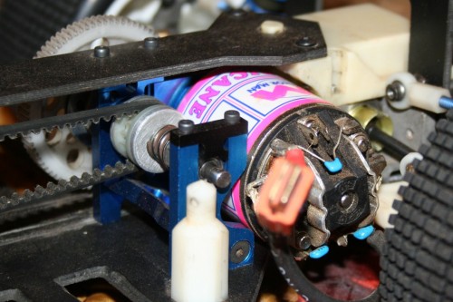

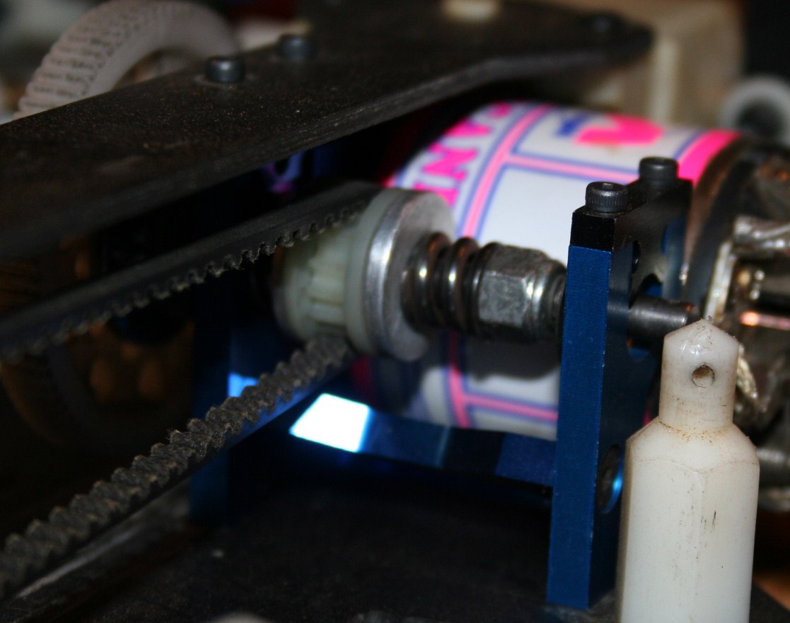

I feel your pain on this one. I have been doing the ebay thing and ordering from a couple of other places. I ended up with a machined aluminum YR4 motor mount pretty cheap from the team integy web site. and am in the process of building a slipper set up for my 870C.
another view
another view
motor mount
motor mount

Justjoe wrote:I feel your pain on this one. I have been doing the ebay thing and ordering from a couple of other places. I ended up with a machined aluminum YR4 motor mount pretty cheap from the team integy web site. and am in the process of building a slipper set up for my 870C.
That YR4 mount is pretty slick. Think I'll order one myself!

The YR4 motor mount from integy does look nice. I would have bought that one if I didn't buy a Yokomo motor plate I found on E-Bay.

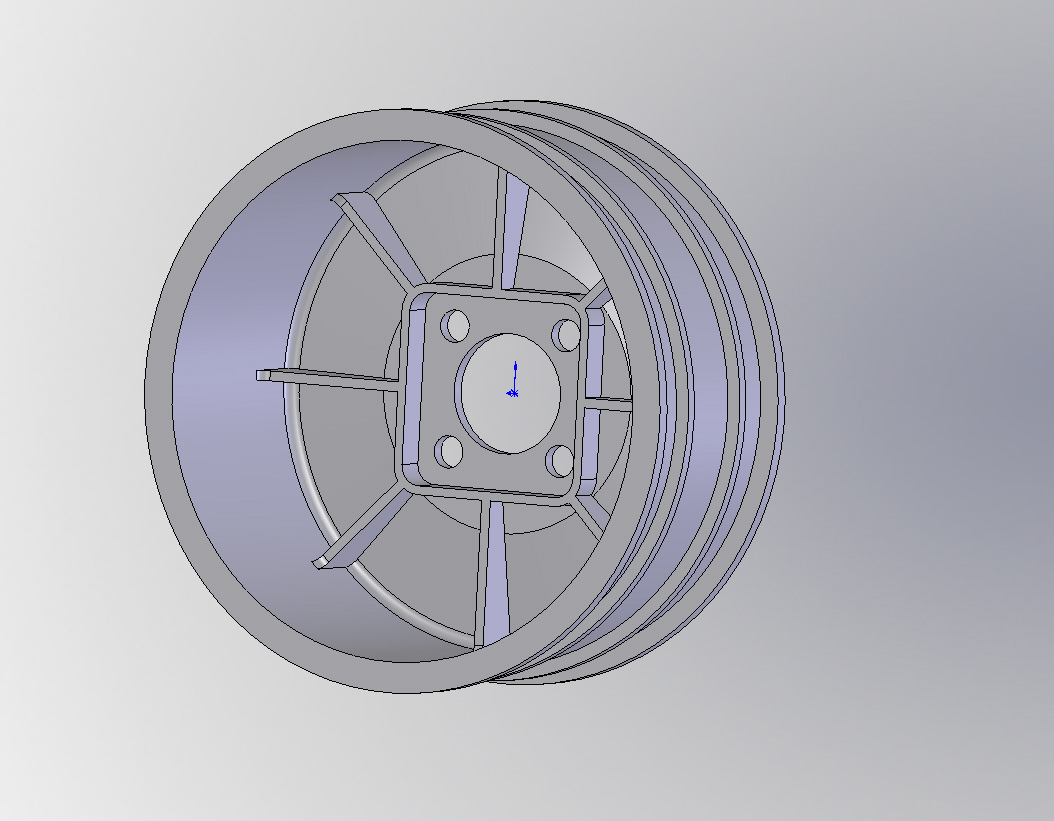

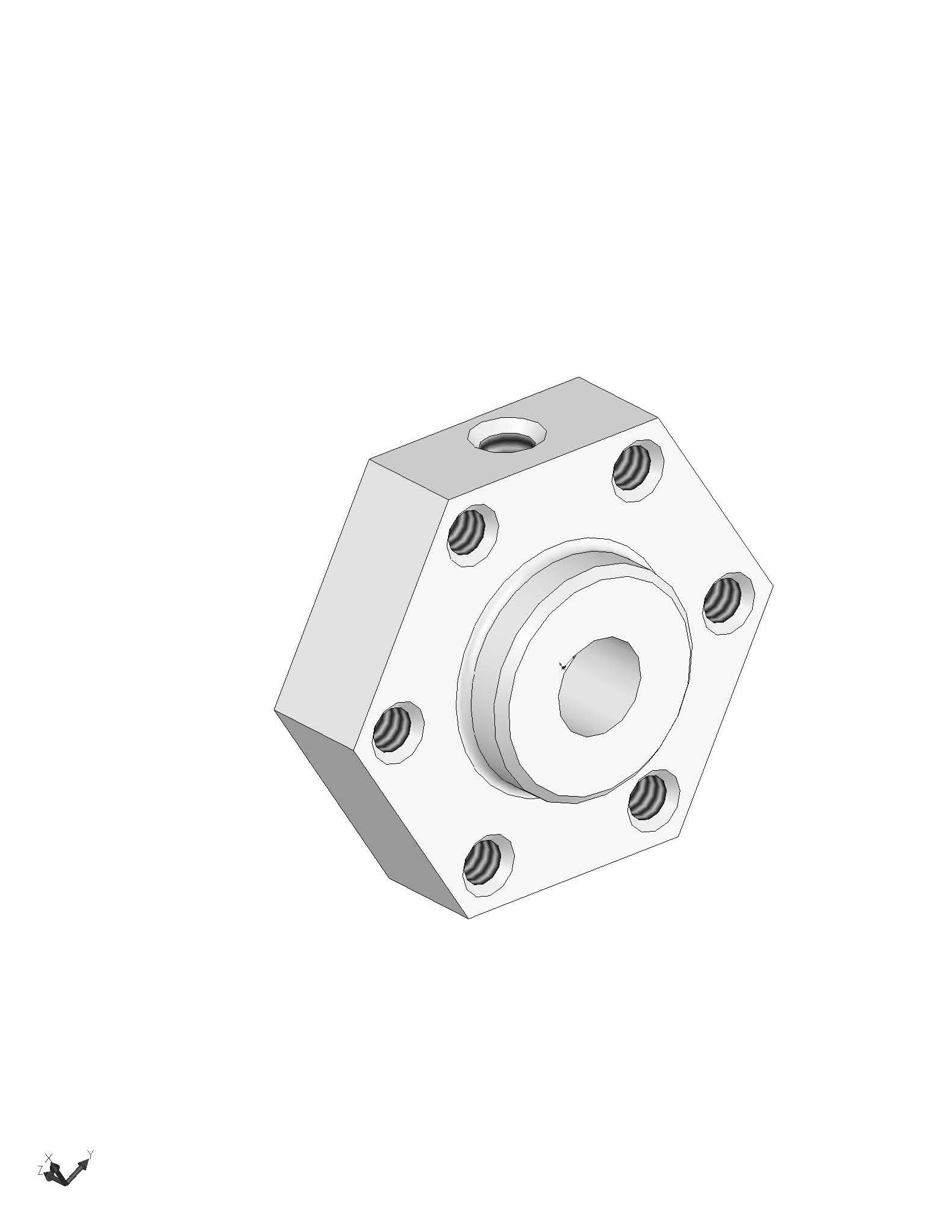

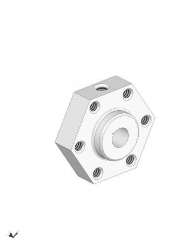

I also bought some rims M4X from E-bay and just modeled a hub to adapt it my car. What do you guys think? They will provide the same offset as the original 91 Yokomo hubs and wheels.
MRX WHEELS.jpg (14.01 KiB) Viewed 1200 times

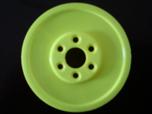

MIKE VALENTINE
Posts: 98
Joined: Thu Jun 17, 2010 2:29 pm
Location: TORRINGTON, CT - USA
Re: YOKOMO RESTORE HELP
Post by MIKE VALENTINE »

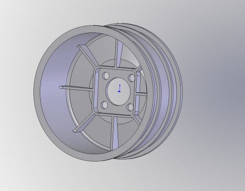

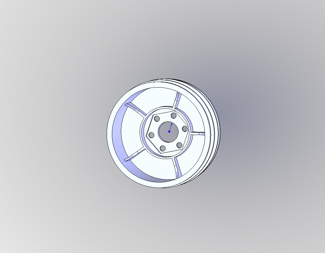

Those are the ones i saw also and they won't fit the rims I bought. Original Yokomo rims had a square recess for the wheel adapter to sit in. The newer MX have a Hex design, so they won't work for me.

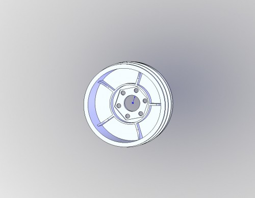

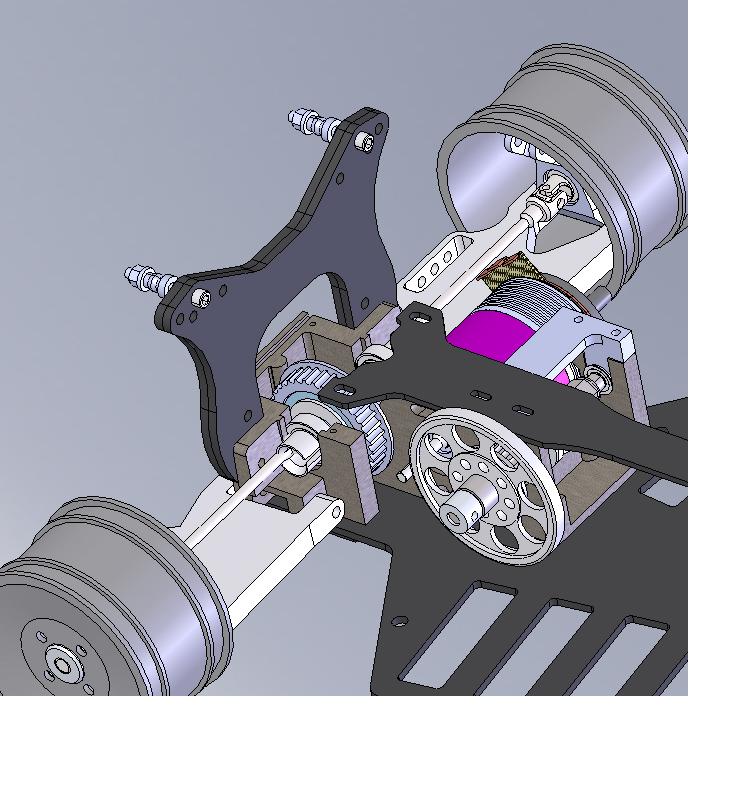

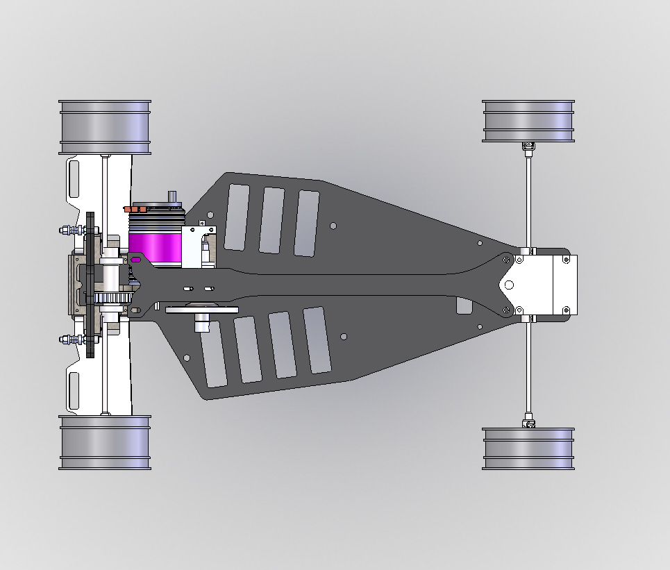

I haven't taken any pictures of the car yet, but have put some of them into CAD. From what I have done, is it a 91 works? Or I'm i wrong about that.
MIKE VALENTINE
Posts: 98
more pictures
