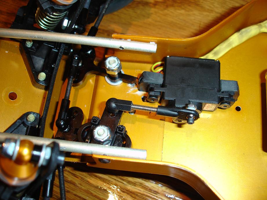

Russ Winn wrote:Thanks for the tip on the posts... The ones I got are from Associated. I'm not sure which car they're made for, as the package didn't specify. They're different from my TC4, and were the only servo blocks I could find at the LHS...I think they'll work fine for now.
They are for 10L and 12L carpet cars. Don't mount the servo on the angle, use the backside of the mounts and you should be ok. Not ideal, but they work.

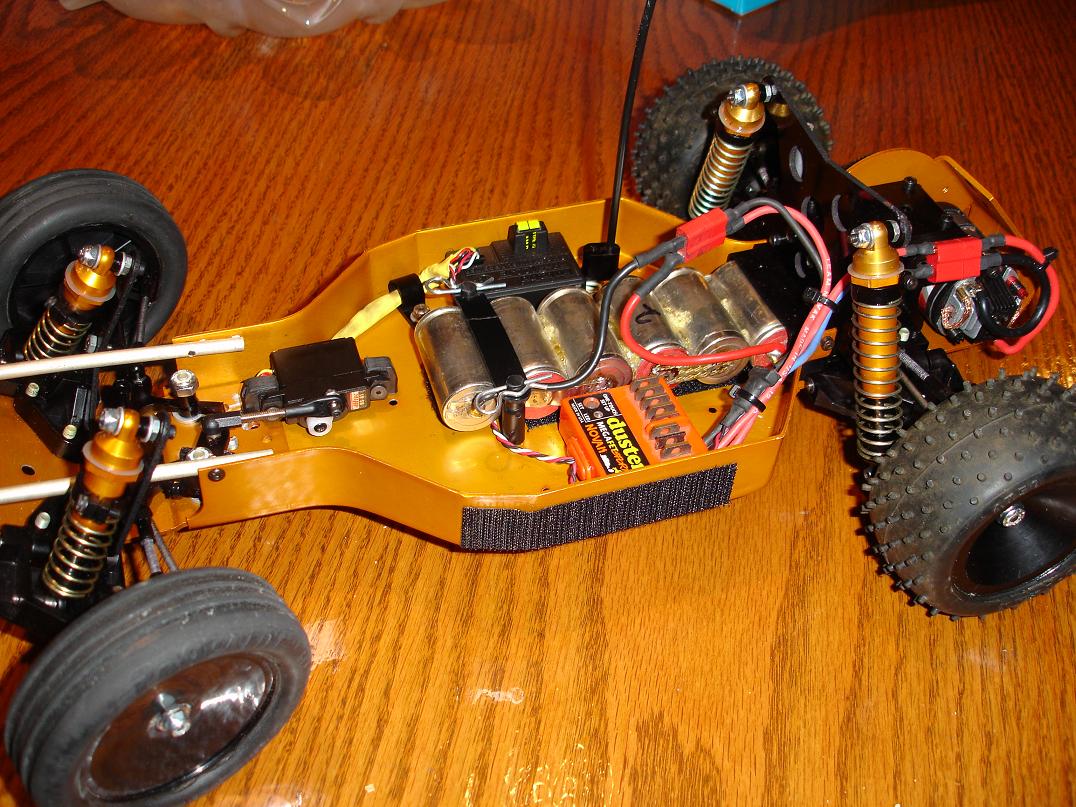

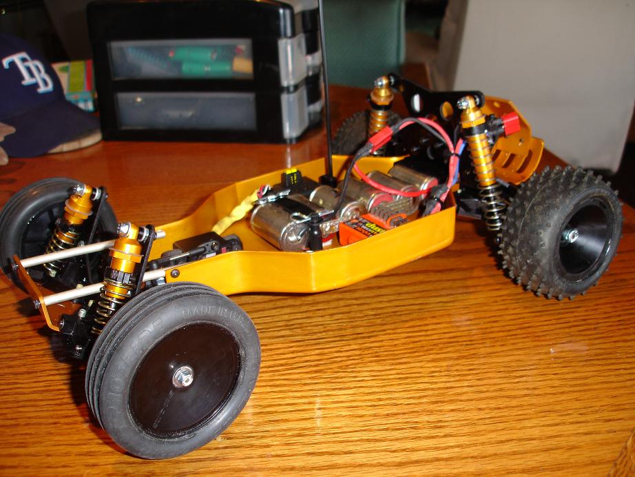

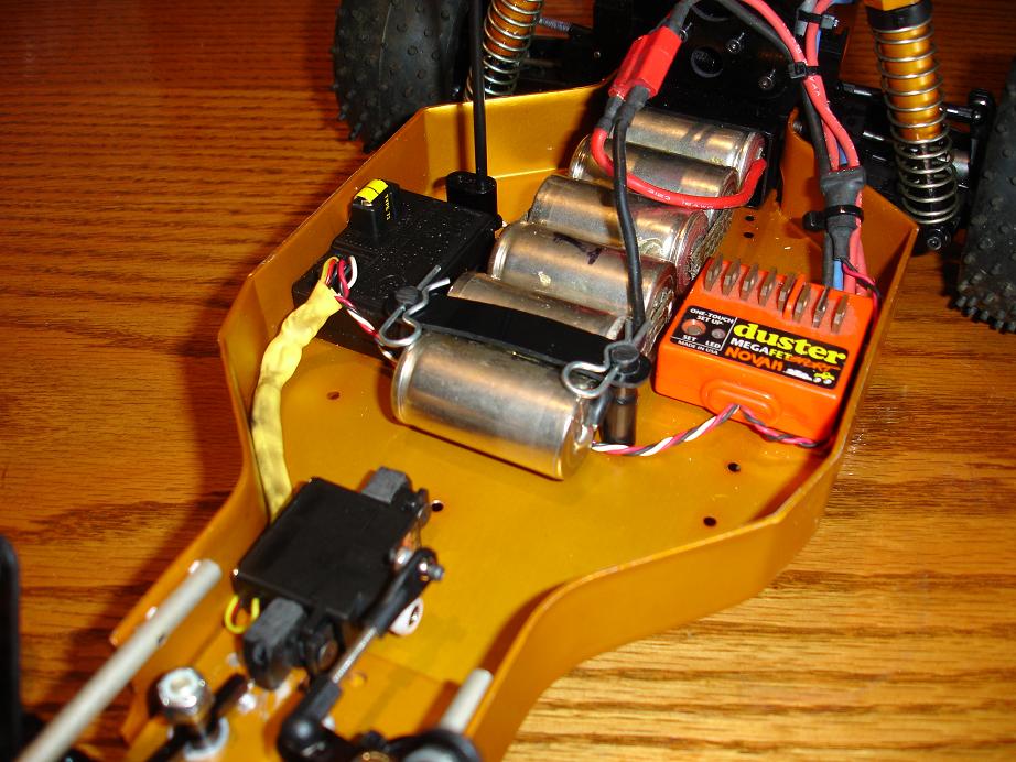

Well, a bit more has been done to the car (linkages, electrics, wheels). I had to be a little innovative as far as battery mounting. My batteries are configured for my TC4, and are too long to use the battery tray. I ended up using some old body posts and cut a strap from an old bumper. With the addition of velcro on the chassis, it's not going anywhere. So far, I just need a motor and a body to get it running. Eventually, I'll spring for new batteries.

Russ, you do that those batteries insulated against the metal chassis, right?

Post by Russ Winn »
For sure...They're wrapped in clear heat shrink.

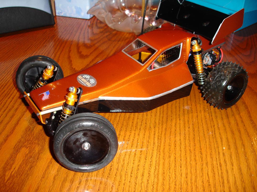

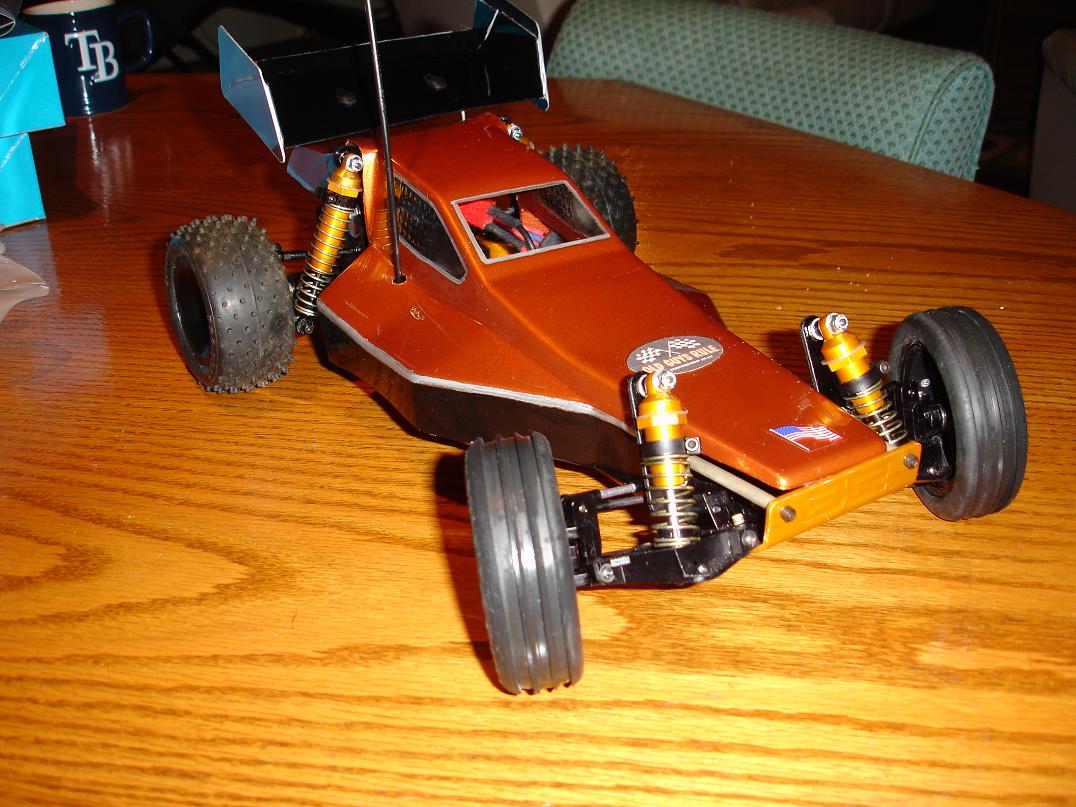

It's been a while, but the car is now "complete". I'll refrain from using the term "finished", because they never are. Anyway, I picked up a body and motor for cruising the street (just waiting on my NIB Bolink foams to arrive via ebay).

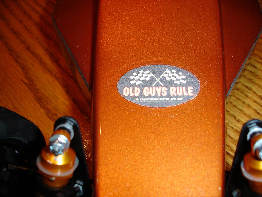

The body, as you can see, is very simple using rattle cans (I never claimed to be a painter). The wing was made from sheet lexan. I just need to find a couple of white Associated decals to finish it off.
I'm not sure about any setups until I get the tires. I'll probably spend 95% of the time on the street with it, anyway.
The main upgrade I have in mind is a better bellcrank. Apparently, they're like gold on ebay. After that, maybe some screw-on ball ends from Dubro or similar type.
