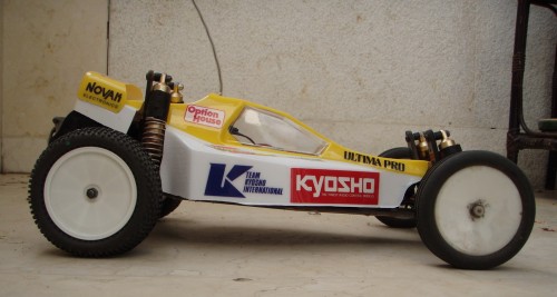

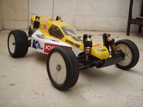

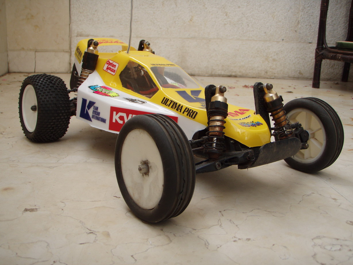

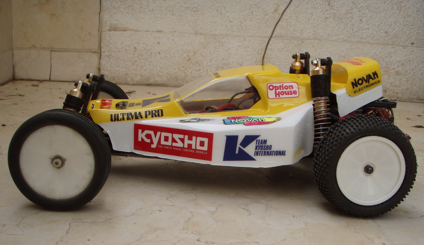

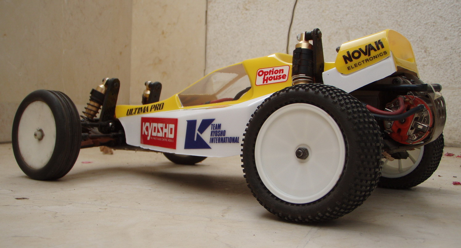

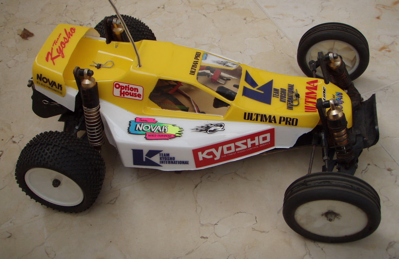

I just finished painting a new body for my Ultima so thought I share it here. Decided to treat it with a new body as its one of my favorite runners and I really enjoy running it. Its being continually upgraded whenever I get the chance. Currently it has a Duratrax carbon chassis with alloy upper deck, ball bearing steering, ball diff, universal shafts and I just replaced the worn rear tires with new bowties. Future upgrades/wish list would be installing a Triumph gearbox like Bormac and some other members recently did (I race against stealth RC10 tubs and the Ultima is definitely the noisiest car on the track plus, I really would like to have a decent slipper!) and Pro XL suspension for better handling.
The body is a Kamtec repro for Turbo/Pro Ultima and was a real nightmare to finish -the window lines were non existent and it took me some time to get the masking right.

Looks great! How does it handle?

I'm not the best driver at the track but with this car I can definitely keep with the pack of RC10 tubs. Sometimes I even lead! :)
The Ultima has inherent understeer which I manage to control with suspension adjustment and driving style. Personally I prefer understeer over oversteer so I guess thats part of the reason I like driving it so much. The previous tires (also bowties) were worn which I guess helped with the handling (the local track is dusty which helped me do power slides into corners), I haven't had the chance to drive it with the new tires so I can only hope it won't have much affect on handling.

Hey Snake, great to see you hopping by again!
The new body looks pretty; for a moment I thought you had a box-art optima body on it.
you brought up an interesting subject with the triumph slipper: would love to hear how well/bad it handles from the guys running one.
The A&L slipper works very well for me but I too would prefer a triumph transmission for its stronger belt if the slipper is equally good.

Car looks GREAT though, e ven if the painting was a nightmare. I like the integrated wing a lot.

i use the parma liquid mask for windows, it brushes on easily, if you have a steady hand its pretty easy to get the lines perfect, and if you dont you can easily exacto off the excess. plus not a drop of paint should get under those masks, they stick like a mofo and are easy to pull off when done. One tip though, if you are using faskolor paints, run a sharp exacto over the lines again because with the thick paints like that, sometimes you get a paint pull when you remove the masks, unless you cut a line first. rarely happens but u want to be safe.

Hey Snake, any chance you have photos of the car without the body?
I always wander hoe the Duratrax carbon chassis for Ultima looks like.
The car looks good. :D
