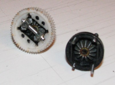

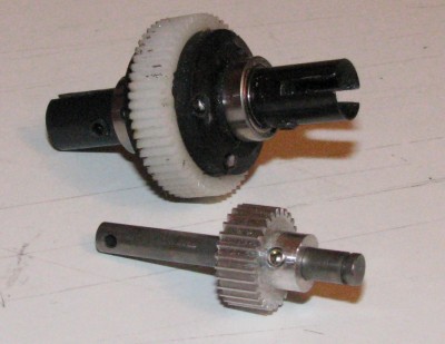

On the 2X4 :
I removed the A&L: as Daryl told me it was released in (thinking) 1990?
Then put in a standard ultima house and moterplate. It started out with a home-brewn geardiff: using a 48 pitch maingear from a thorp balldiff and the meeting pinion.
The outer gears I used are alu and all kyosho module (M0.6?)
I got those outer gears in a LHS, but they turned out to be too worn and noisy, so I soon ditched them for the pro combo: 32 pitch and M0.6 only for the main gear of the spur.
Ran a couple rounds, then the thorp pinion slipped. When I tightened it back up , I destroyed the M3 tread I made in it to work with the geardiff.
(I will post pics in the coming days of this diff, and will try tapiing it for an M4).
So I replaced the diff with the standard ball-diff and a 32 pitch hardened pinion.

Here are the promissed pics of the modded gearbox
