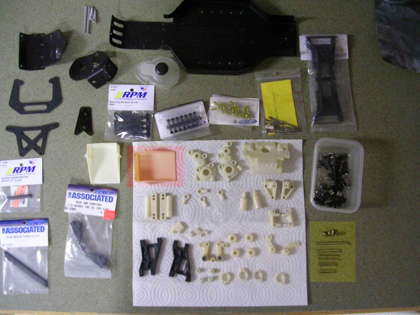

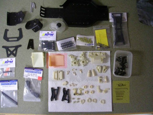

The chassis is finally clear of decals and velcro, the parts are mostly ready to go back on.
I still have to polish the pins and I think I will polish the shock's pivot balls just to make the suspension as smooth as it can get. I'm sure it wont make too much difference, but what the hell. I also got to rebuild the shocks and transmission.
I cleaned up the old battery cup for craps and giggles, it is white and only has two slits in the top of it. It's still better than half the ones I got. The new one going in is in great shape. With that MIP steering setup I might have to use Associated ball cups for better clearance on the tower and use RPM for the rest of it.

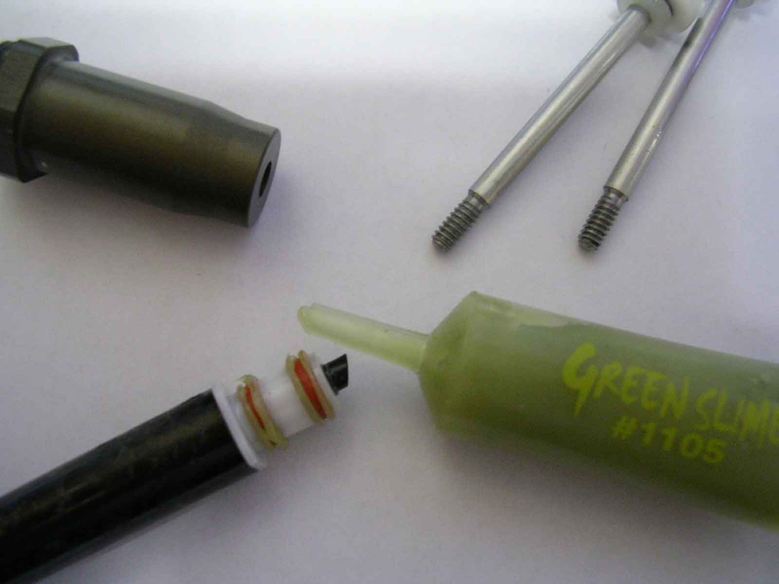

For now I might as well rebuild the shocks...using the rebuild kit and green slime between the o-rings

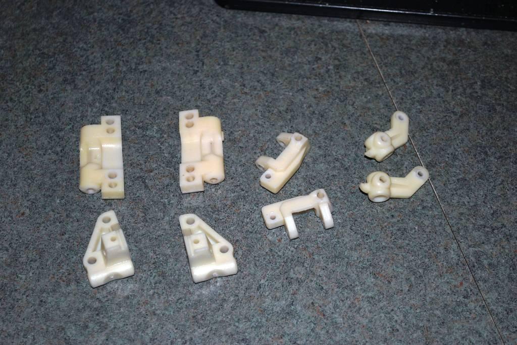

First thing was to boil parts for 20 minutes. I wasn't sure if I was supposed to boil the arms, so I left them out and can do it later.
I got the pins all polished and some of the assembling done, but will wait til I finish the assembly.
