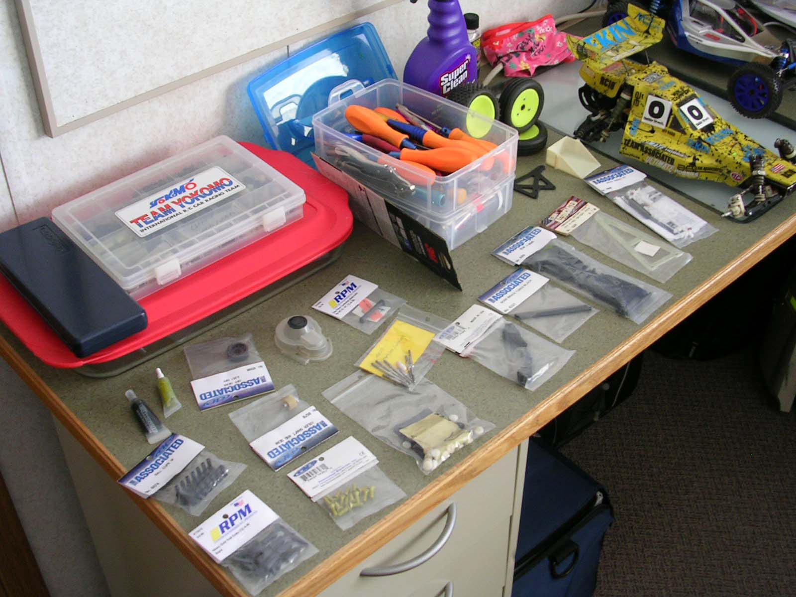

I was given an opportunity to contribute to Slotcarod's 25 YEARS OF THE RC10 thread, so I went for it.
Here is a bit of background...Rod and I both used to live Calgary, Alberta, but I didn't get back into RCs until 2 months before I moved back to my home province of Nova Scotia, which was when I ran into Rod. Now we cross paths several times a year as I still work out of Calgary and fly back and forth to home. I was at his house the other day and he handed me a crusty Worlds Car to work on for his 25 years of the rc10 thread.
For those of you who haven't been to his thread, it's about documenting everything that was factory on each and every version of RC10 up to 2009. I'm not sure if he had revealed all of his plans on his quest to document all the RC10s but I think they involve runners of each one and much more. I will be restoring his Wolds Car runner to his requirements and it will be used in his testing.

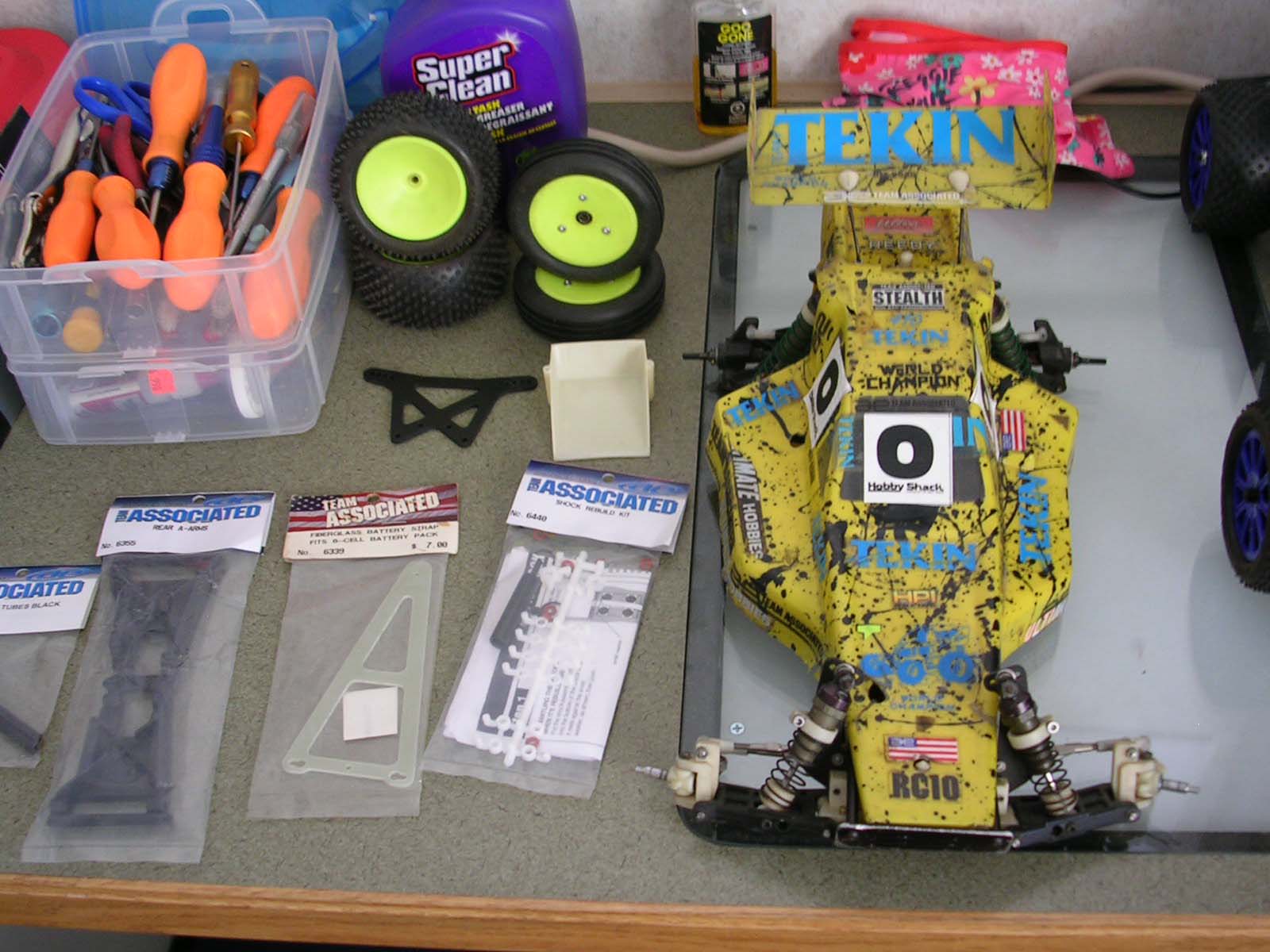

The to do list
Disassemble
Clean
Rebuild shocks
Rebuild transmission
Boil hubs, knuckles, mounts, bell cranks, and rear bulkhead
Polish all pins and shock shafts
Replace ball cups and turnbuckles
Replace rear tower, rear hubs, rear arms, nose tubes and chassis screws
Rebuild everything as per the Worlds instruction manual
Probably try and strip the body and wing down too
Rod, if there was anything I had forgotten please let me know
I will try and document as much as I can as the restoration goes on.

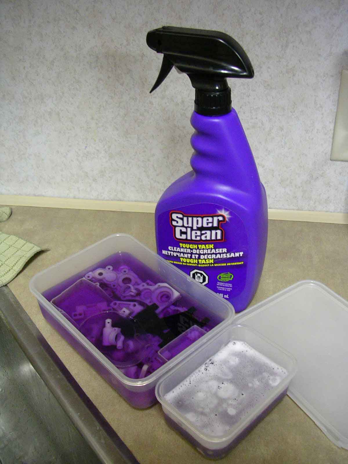

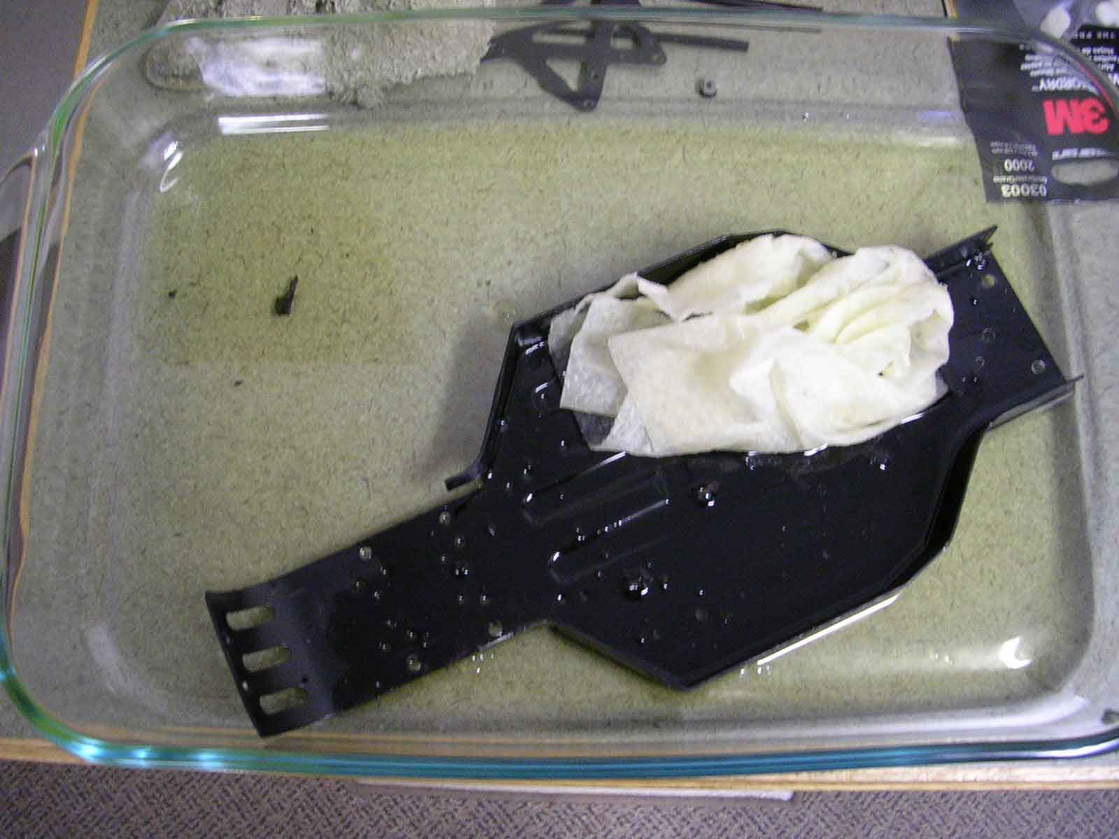

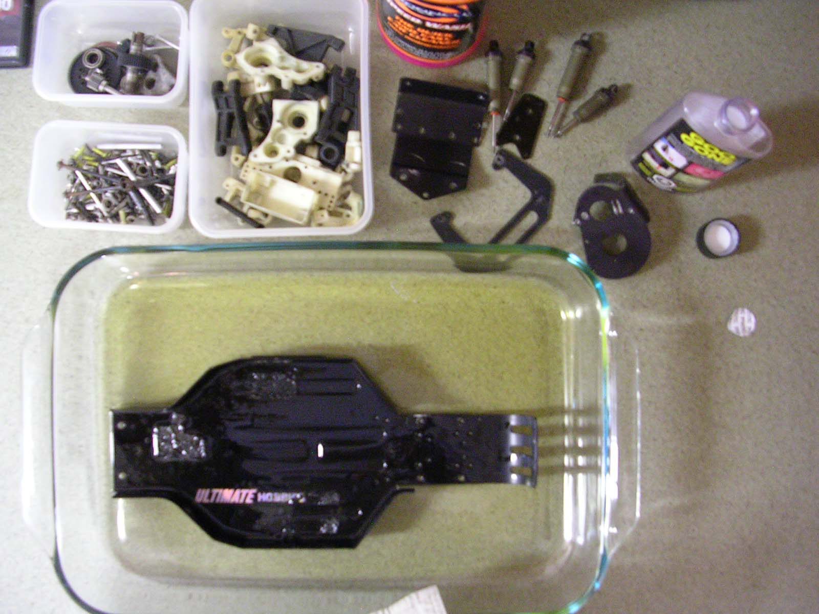

I got the buggy stripped down and the chassis can take a bath in Goo Gone over night.
Got some cleaning to do tomorrow. I got some O'Donnell Speed Wash and some Purple Power Super Clean. I hear conflicted things about using Super Clean on white parts....some say that it leaves a purple tint, is that true?????

I got some cleaning done today. I used the O'Donnell Racing Speed Wash and it works great
Then I got doing some research on the Purple Power and realized that I could use it to get the stubborn blackish coloured stains off of the white parts. I initially planned on using it to remove the paint from the body, but I'm not sure if I will have enough left now. I have the parts and the old hardware soaking in the Purple Power and will check on the throughout the day.
The chassis was soaked in Goo Gone is still soaking

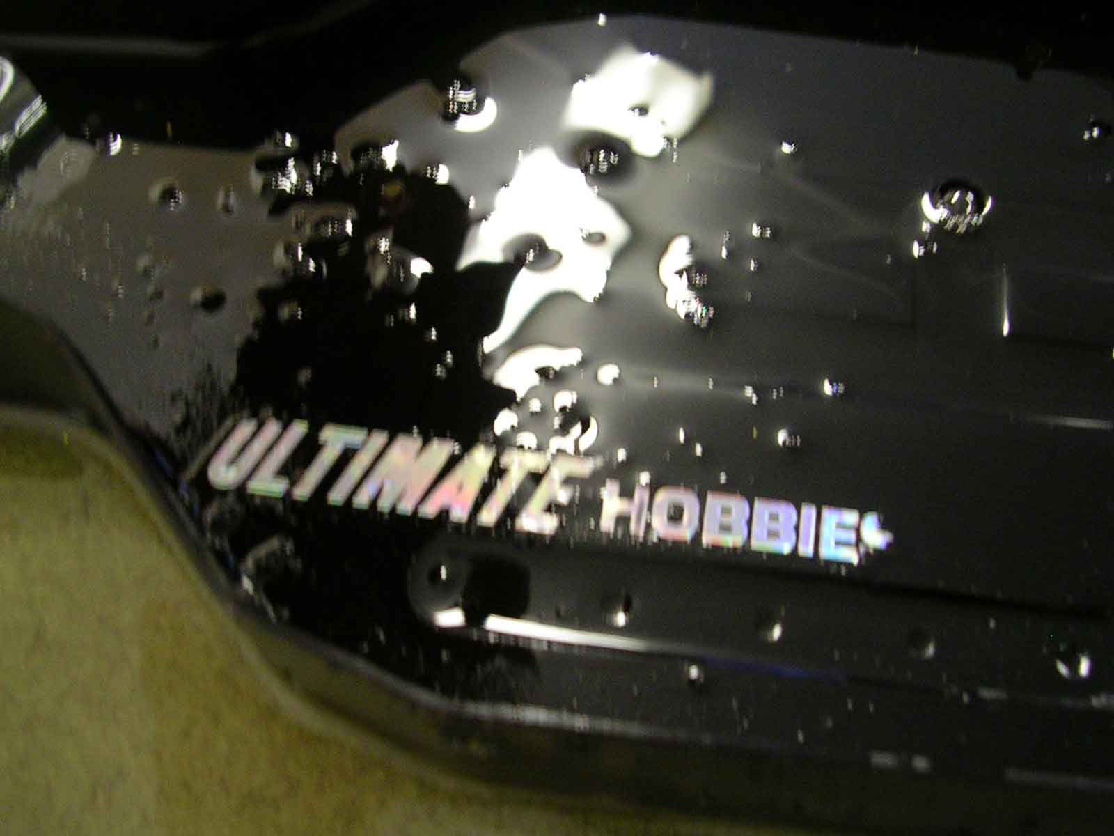

I got everything off but one ultimate decal from Ultimate Hobbies. I took a couple sheets of saturated paper towel and laid it directly on top for better coverage. I hope it helps

I like to peel stickers off and then hit the residue with some paint thinner, quick and easy. If the sticker is stuborn hit it with a blow dryer.

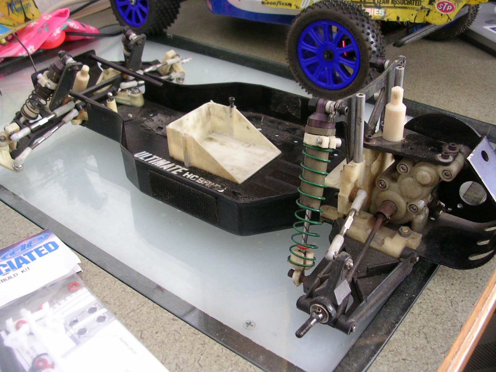

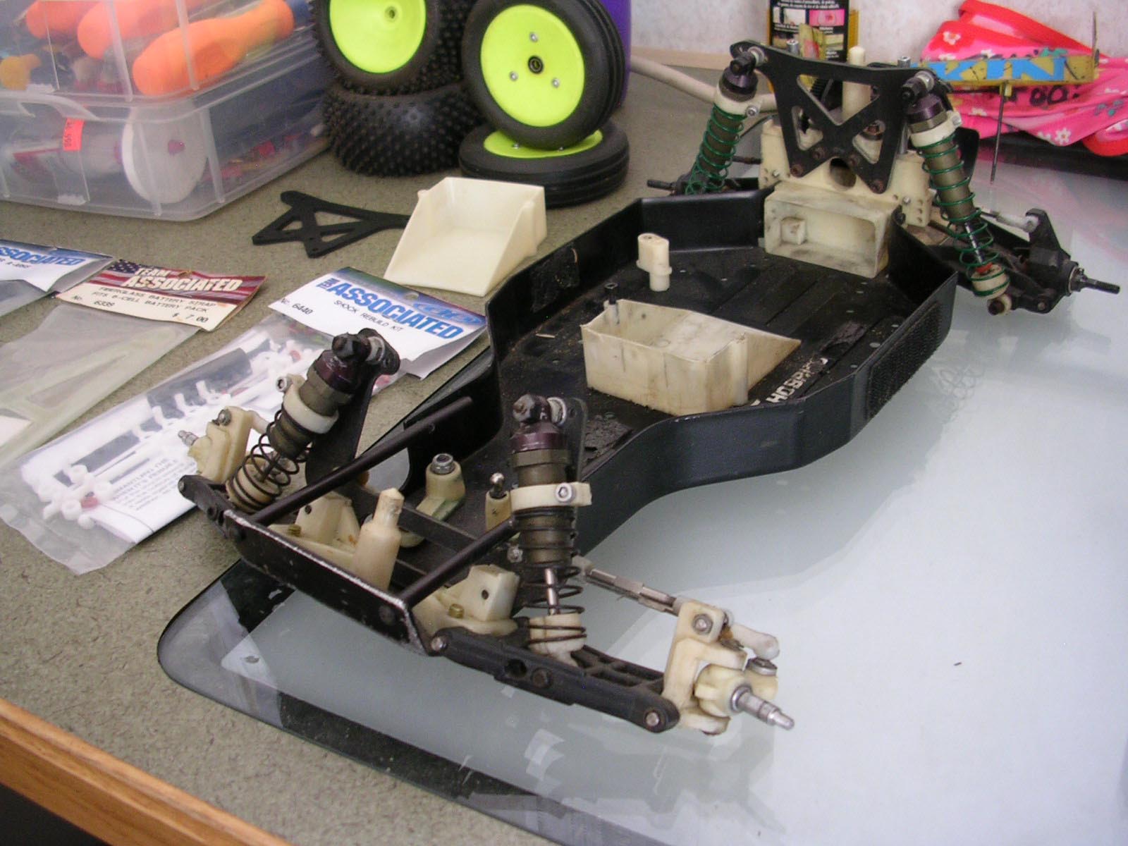

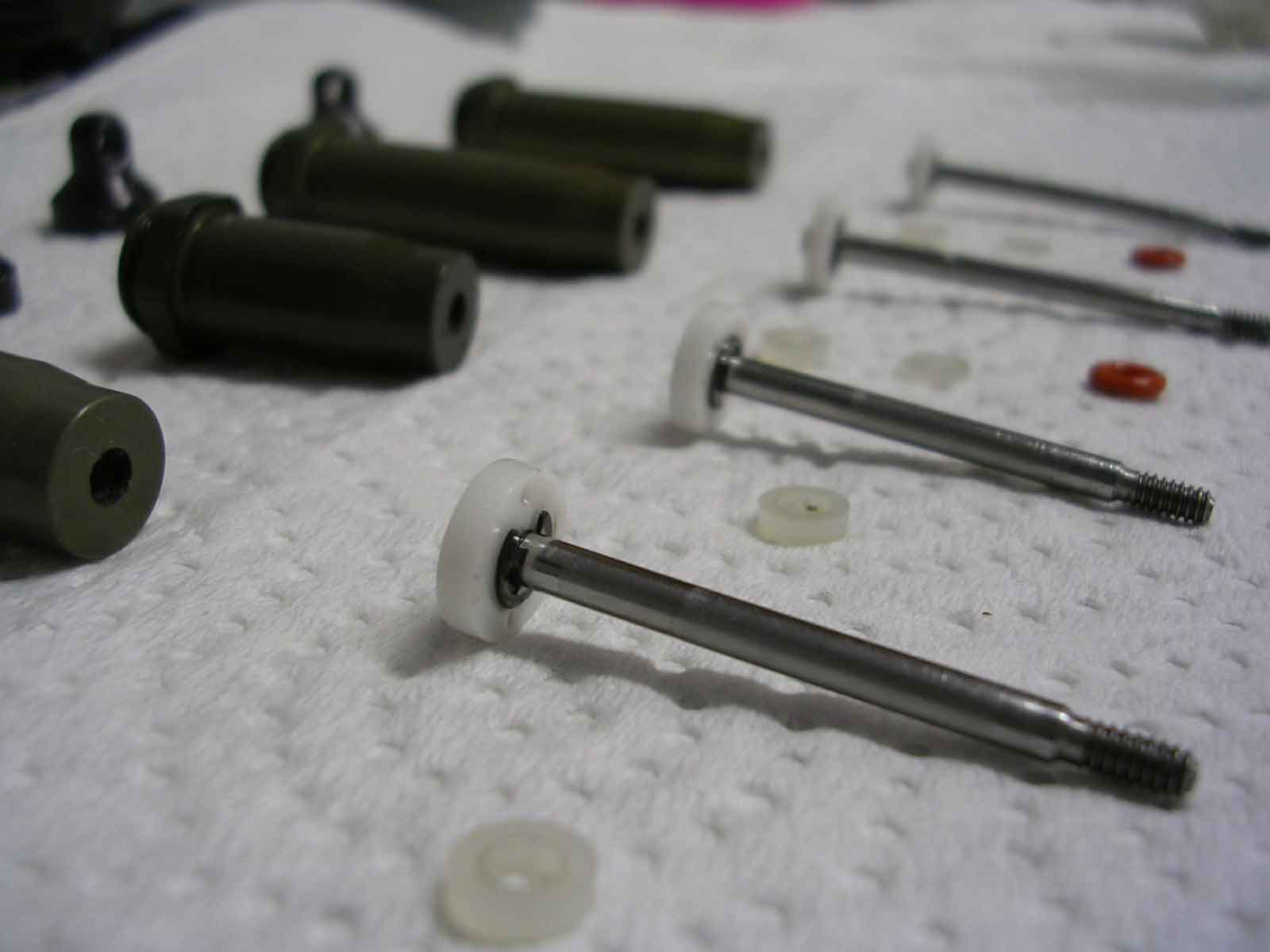

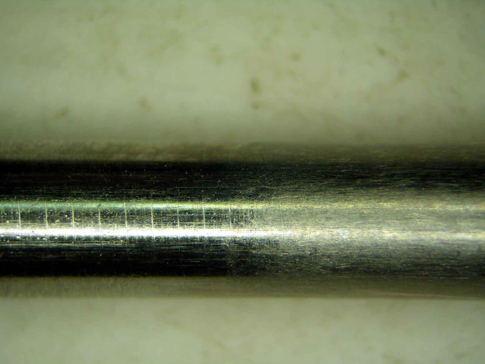

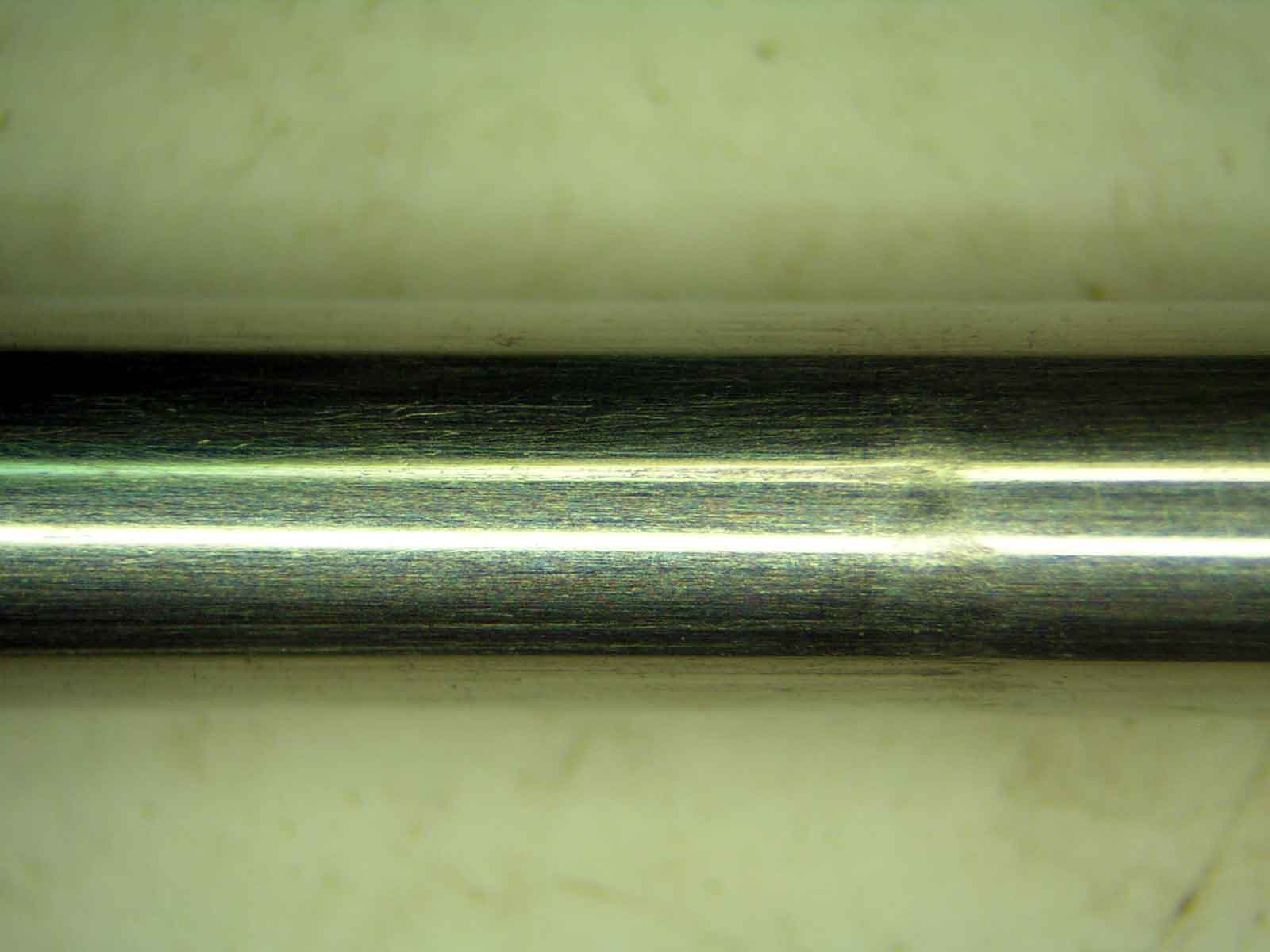

As the shocks come apart it is revealed that they were built just as the manual shows, well almost...there was the o-ring limiter on the bottom of the rear shocks, but they had the same limiters inside as the manual.
Since I will be polishing the shock shafts and the fact that I'm a geologist "at work" with a microscope, I thought I would snap off a close up of the before shock shaft. The are a lot of striations running length ways due to scraping against the outside of the shock body. And a few perpendicular striations which look like impact marks from the shock body opening and not plier marks.
I will go over them with some 3M 2000 grit wetordry abrasive paper and mother Aluminum polish. After shot, which looks a lot smoother with the naked eye.
