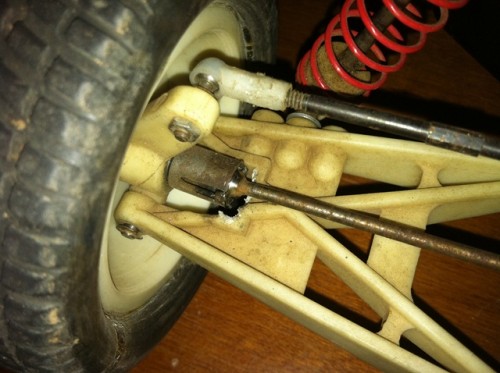

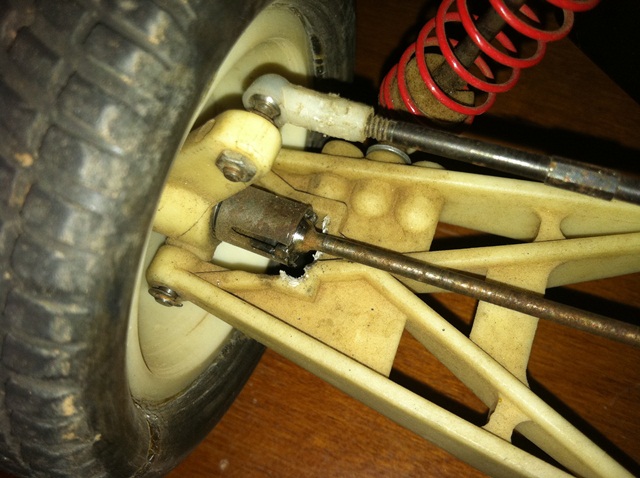

Installed the RPM tranny and took my kid to the track. didnt have the money to upgrade the CVDs yet. Overall, the springs that were on there are way to stiff...I have no idea what kind of springs they are or what spring rate. between the RPM tranny and the brushless motor, 1 of the stock dogbones got torqued causing it to pop out and chew up the a-arm. got a new body and had my kid design the paint scheme...not bad for a 9 year old.

You can ( as I did ) move the battery box up so its just off the steering servo and then
use T4 battery spacer foams to get the battery snug. All you have to do is take the 4/40 screws out and move the box until it is about 1/8" from the servo and make new holes-
Those rear springs are red associated, and are the stiffest that they offer- try green rears- did you change any oil or pistons?
