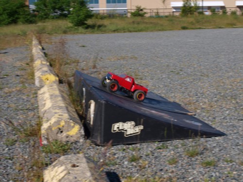

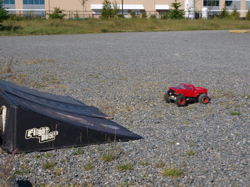

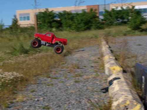

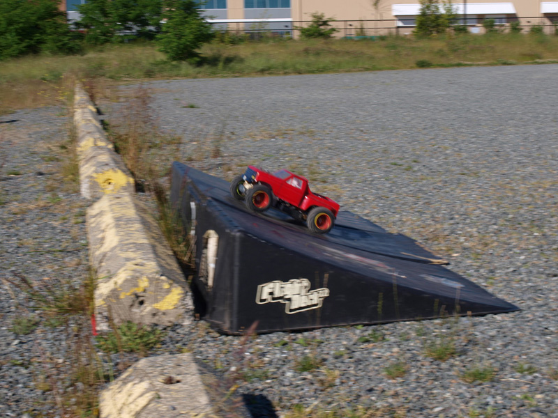

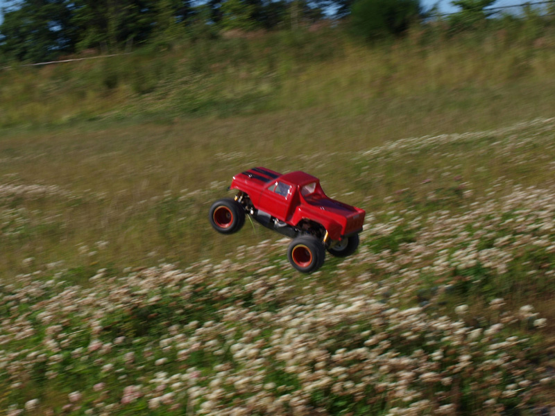

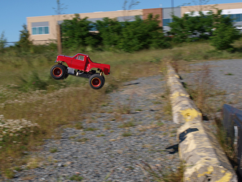

Well, I have been away for a while and had to take a break from my plans with the truck. Hopefully will be able to get back to it soon. I did however get a chance to run in this last weekend with some stampedes. I'll have to say that even though the stampedes can jump way farther, the yz10 did it way smoother. Of course the stampedes had brushless motors so its kind of an unfair advantage.
No problems with the wheels this time and other than a few gravel rocks getting stuck inside it was a great run.
I managed to capture the YZ jumping and thought I'd share with y'all
