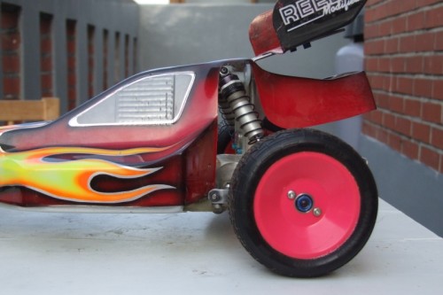

a01butal wrote:
59burst wrote:everything is pretty much finished except for the tranny now.
looks like you could use an A & L Chassis stiffener kit to really pimp it out dude. 8) :mrgreen: :mrgreen: :mrgreen:
As soon as Daryl starts pumping those out, I'm grabbing a few sets. ;)

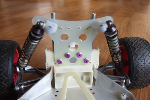

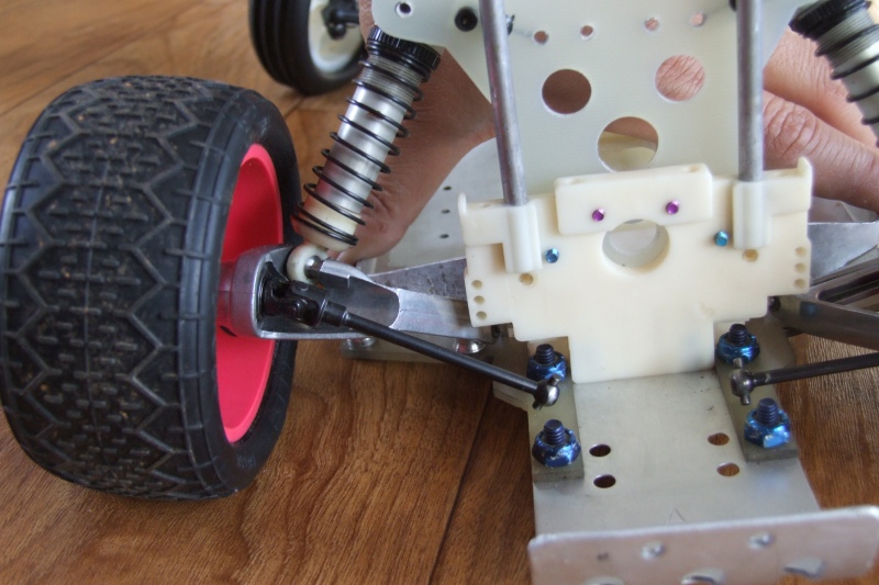

losiXXXman wrote:Hey that's a cool idea on redrilling the stock rear tower. I have been interested in a trailing arm conversion, but have not picked one up yet. Using the stock tower was something I wanted to try - nice to see that it works beforehand! Just a thought though, if the taller A&L tower for the trailing kit uses the stock rear length (1.32body/1.02shaft) shocks....couldn't you use the 1.18 shocks with the stock RC10 tower and the trailing arms? I don't think you would need a further shorter tower. Does that make sense?
the shocks are 1.18 and with 1.02 shafts already. and the clearance is fine with one spacer for each rear shock. but, I still want "more" stroke (wheel travel) which is equivalent to my other runners. so I need to make the tower 2 to 3mm higher than this, then remove the spacers in the rear shocks. it's not for bumps or jumps. but for better handling at the corners. but who knows. it's already looking good and I'm lazy to move my butt for making a new tower. even I'm not a good racer at all :lol: :lol:

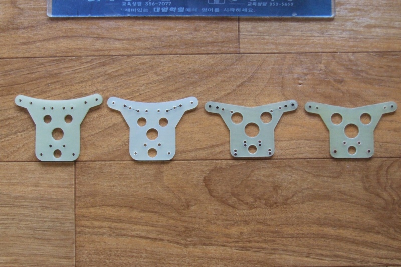

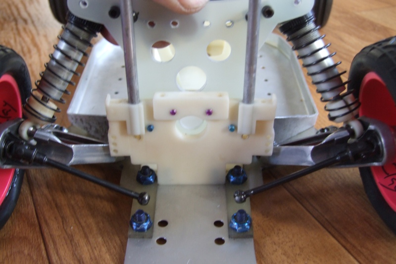

got an epoxy sheet for making the stiffener. but have changed my mind and started to make a rear tower for 1.18 shocks and finished it

I was wondering what's the tools for your custom shocks towers? CAD and machine?

The issue with most TA suspension designs is the wheel rate curve as the suspension compresses I think... looking at this one it accelerates (which is fine) and then slows down (which isn't) :mrgreen: Let alone wheel base changes, and scrub angles with that kind of rear toe...
but it looks SO cool I want one badly :mrgreen:

CAD, Hand saw with jewelers saw and Dremel. :D
what are you using? drill and then dremel?

pretty much same with you. but my dremel motor burned years ago. and didn't get it fixed yet :lol:
but the difference is.. I never tried that complicated shapes you did. I can do such a simple job like this tower. even I ruined the first tower today

Lonestar wrote: The issue with most TA suspension designs is the wheel rate curve as the suspension compresses I think... looking at this one it accelerates (which is fine) and then slows down (which isn't) :mrgreen: Let alone wheel base changes, and scrub angles with that kind of rear toe...
had to read some articles to understand what scrub angle was.
but I can't still understand this part "looking at this one it accelerates (which is fine) and then slows down (which isn't)"
can you tell me more on this?
