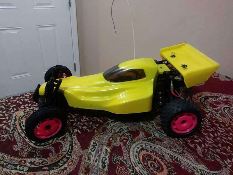

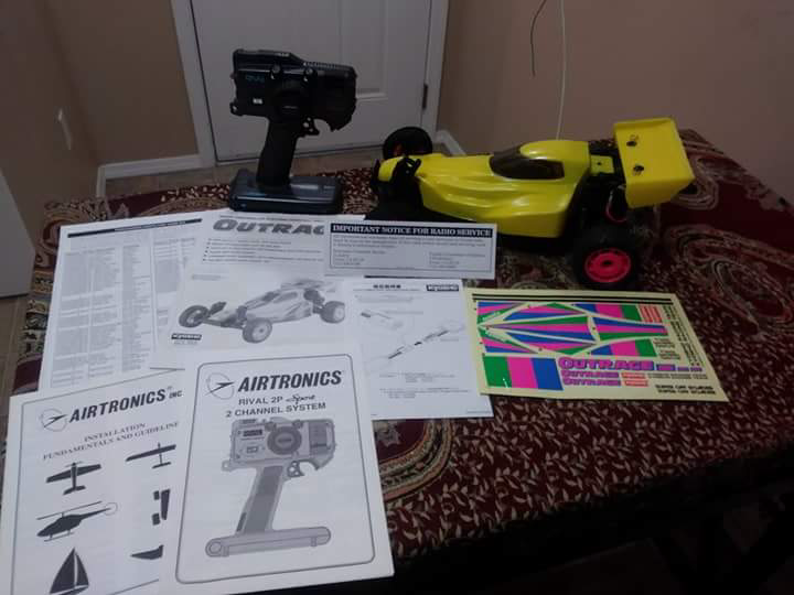

Image an older gentelman gave this to me the other day not sure its even been ran i charged the battery and it works still has the plastic film on the body.

Those rear tires are pretty!
