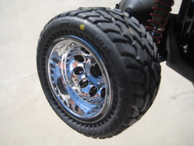

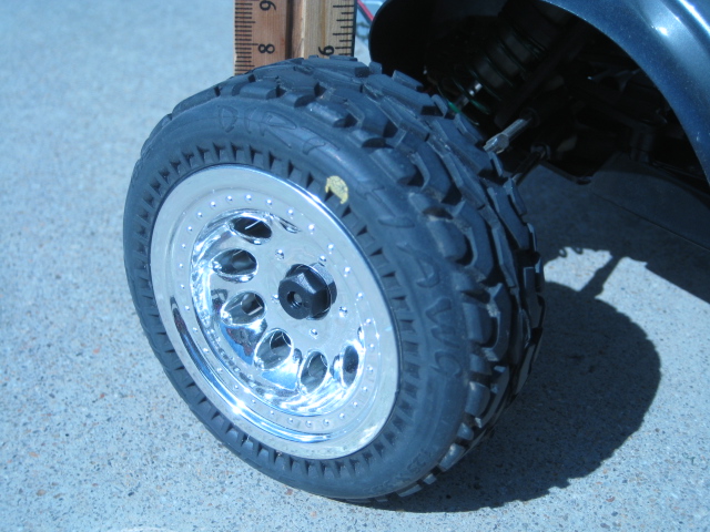

I do think that the Jconcepts J82 front wheels & tyres will look allot better
Do you know of any other 2,2" tyres that are 110mm high with a realistic thread ?
These (rock crawler offsets) 2.2" RPM Revovlers & Proline Dirt Hawgs come in at a little under 90mm...but they are very scale looking...the lug pattern is near perfect match for the classic VW/Buggy pattern used in most VW based off roaders.. To narrow the fronts, you will have to remove the outer tire bead mounting area..plus they will work w/any 12mm hub.:D
So far, your project looks great!

I have a set of the 2,2 street tyres and they are too tiny
I did find a tyre on RC4WD
http://store.rc4wd.com/Dune-XT-22-Off-Road-Tires_p_719.html
So when they make that one with the tread pattern from this one ...That's the one I want
http://store.rc4wd.com/Two-Face-22-Offroad-Scale-Tires_p_1418.html
They do have 2,2 sand paddle and rib front tyres in the correct size
http://store.rc4wd.com/Sand-Storm-22-Paddle-Tires_p_741.html
http://store.rc4wd.com/Sand-Thrasher-Rear-22-Tires_p_746.html
The front tyre resembles the J82
http://store.rc4wd.com/Sand-Thrasher-Front-22-Tires_p_743.html
