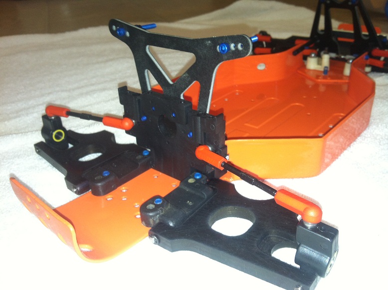

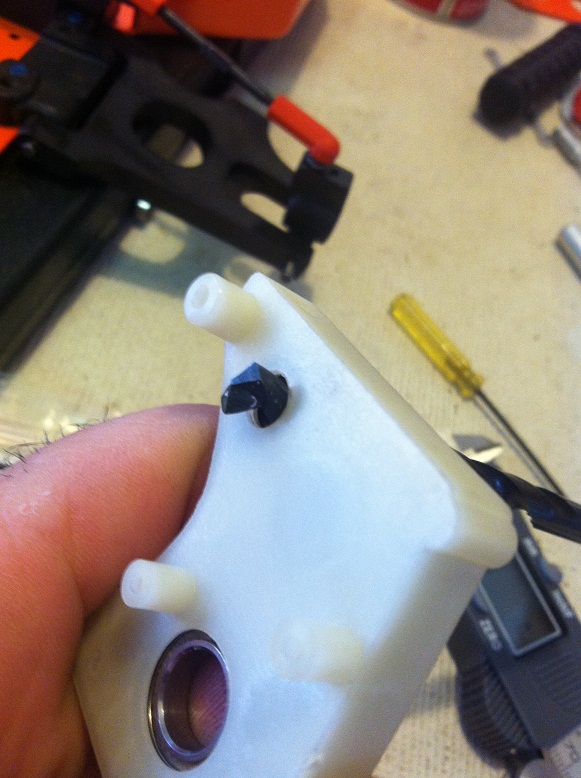

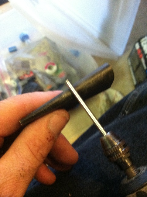

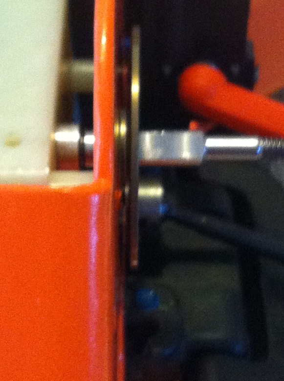

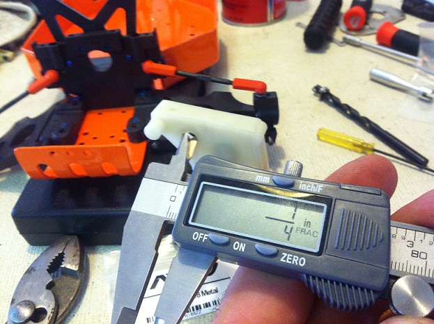

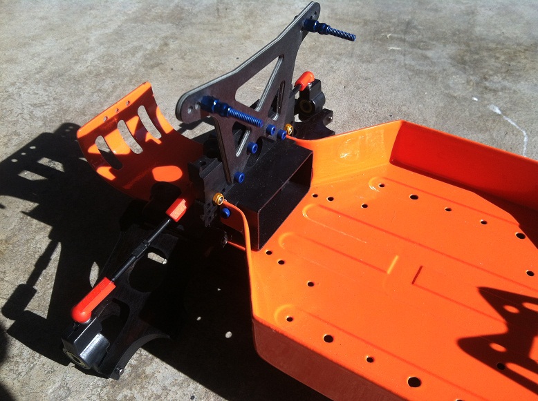

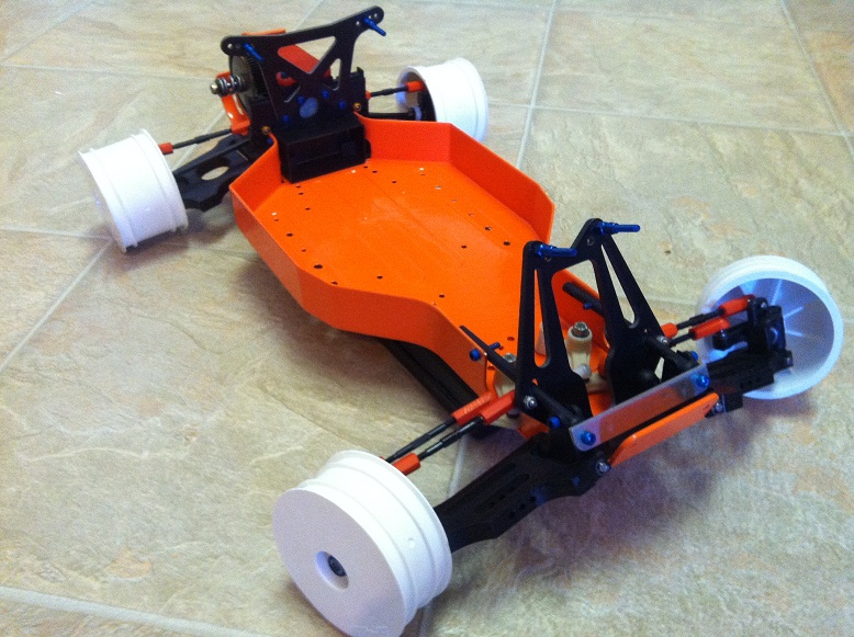

well its been awhile, I have been waiting on parts
well some have arrived and here is what i have gotten done

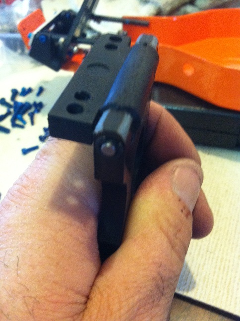

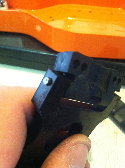

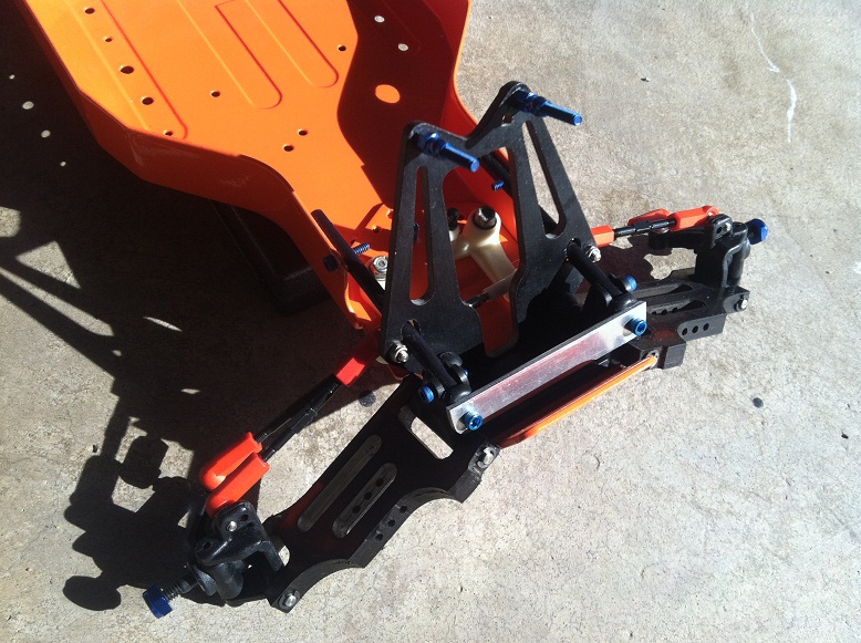

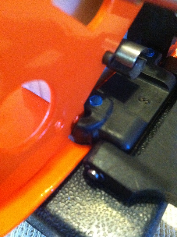

front end hex conversion

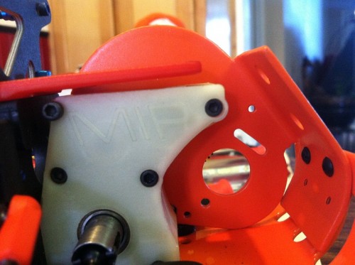

i did have a problem with the jeepz arms (see pics) but was a easy fix

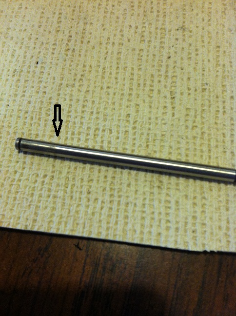

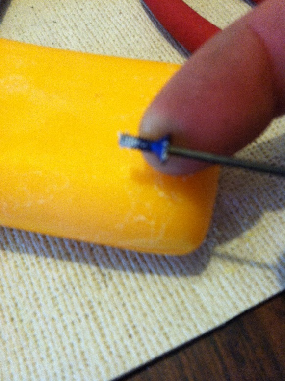

also showed a lil trick that i do to smooth out some aging hinge pins
with a dremel
800 grit sand paper
as u can see in the one pic with the arrow that spot to the left was un buffed
area
really makes for a smooth hinge pin
well if it helps one person
at least it helped
enjoy
thx farmer

Re: FARMERS Official ORANGE RACER Build Thread
Farmer, I see in your first picture of the arm hitting, those arent the arm mounts you used (look like 1.5 or 0 degree mounts), but on the chassis is 3 degree mounts (now I need to check my Jeepz arms, but I dont think they hit).
--Joey --
Vintage A&L and Factory Works
JKRacingRC.com
JKRacingRC.com
ya i was just useing those as a mock up, but even the 3degs on the chassis they hitJK Racing wrote:Farmer, I see in your first picture of the arm hitting, those arent the arm mounts you used (look like 1.5 or 0 degree mounts), but on the chassis is 3 degree mounts (now I need to check my Jeepz arms, but I dont think they hit).
I just checked mine, I didnt round the corners & do have slight interferrence, but my rear droop is more than my stock armed buggy.
--Joey --

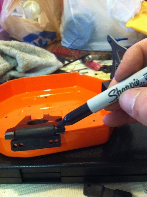

mite be worth it to round them over to get rid of the bind
ill tell you what the mip tranny thats going in there
is a PAIN IN THE A$$ UGGGGGGHHHHHHHHH
but after a beer and the dremel its starting to take shape
kinda like trying to shoe horn a 454 into a civic
farmer

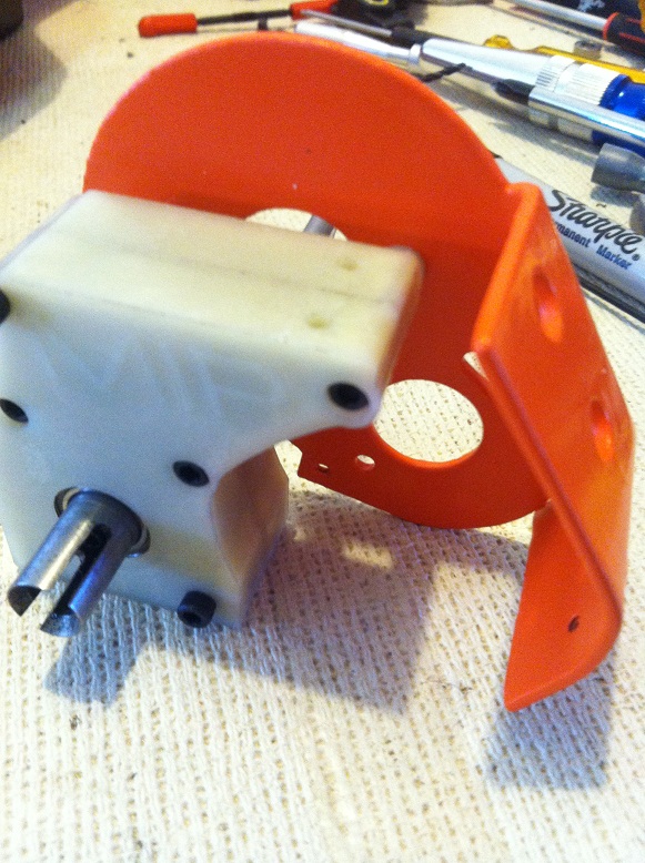

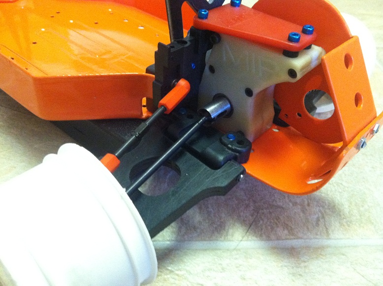

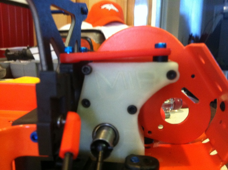

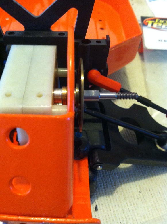

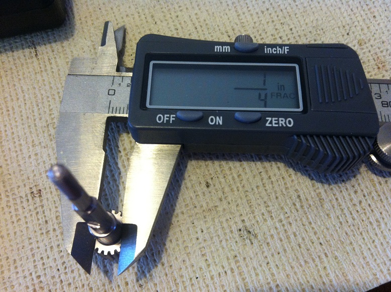

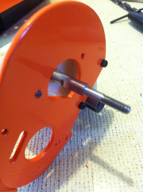

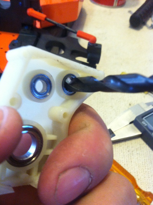

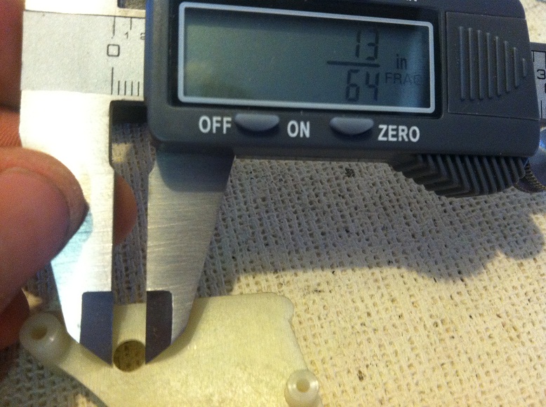

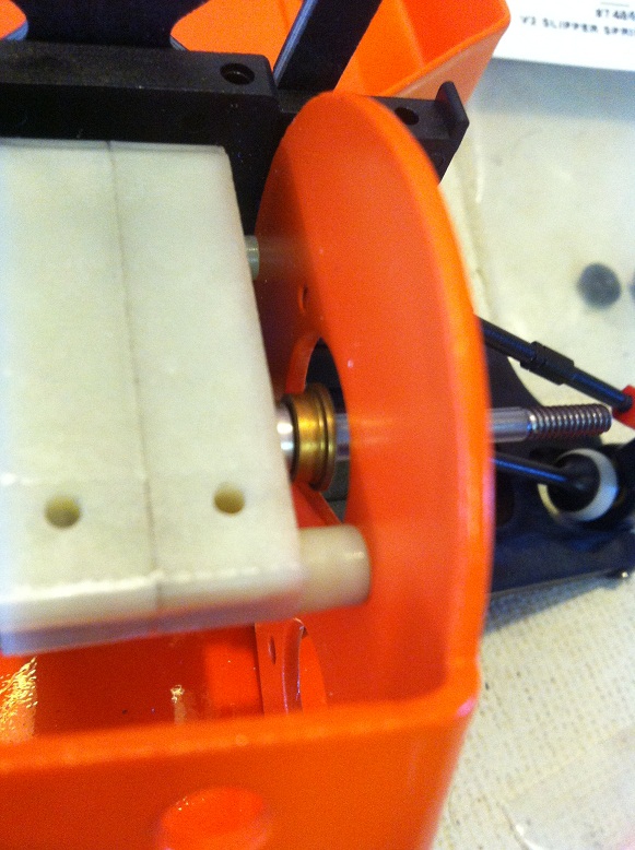

well the tranny is in! ya it was a b!tch
so here are some pics
MIP lite weight top shaft
wassnt fitting but now it does
lil soap trick share
b4 v2 slipper
wasnt fitting but a lil brass bushing fit just rite as a spacer
enjoy
farmer
b4 v2 slipper
enjoy
farmer

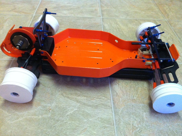

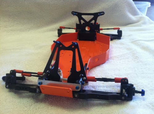

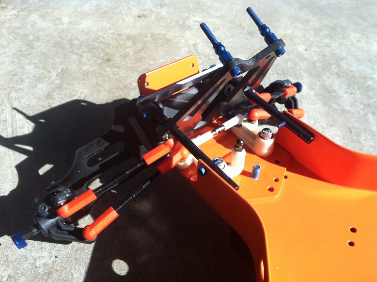

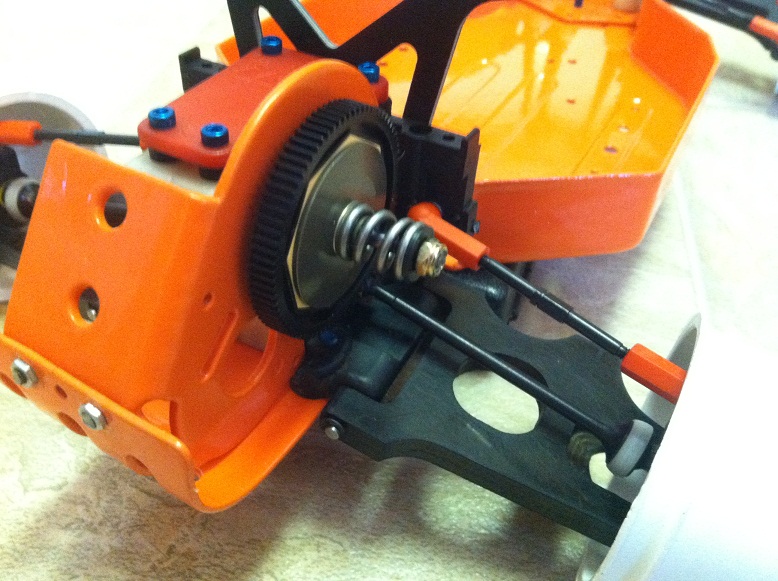

here is the second set of pics
mip cvds
12 mm hex wraped around
mip tranny sitting
enjoy
farmer
mip cvds
mip tranny sitting
enjoy
farmer
looking good farmer, let me know how you like that front 12mm set up. I've been eyeballing it for quite a while, but havent pulled the trigger quite yet.
thx joey
i think i mite need to find some longer bones for the b4 cvds
with the CWs hubs on the lower adjustment hole
at full extension of the arms (droop) the bones want to slip the outdrives and also they rub the big center brace of the jeepz arms
shock limiters would work but the amount of droop is almost none
i like droop
on the top holes of the CWs hubs its ok but i want to be able to use the bottom holes
lower Rear end cg
also there is a lil bind in the hex on the rear when u tighten the rear nut
i think its from the hex adapter has a little lip on it after capturing the drive pin
so when i tighten the nut up it pushes the adapter into the beaing a lil
ill make it work
feels real solid
farmer
i like droop
lower Rear end cg
ill make it work
feels real solid
farmer
I am using the Losi rear carriers, but in the lower hole (which raises the CVD away from the arm). Lets me have the droop you see above. Do you have crush sleeves in the CW carriers? That may solve the binding issue.
no?
didnt know they where needed,,,do to the bearings being captured in the hub
they dont push all the way through?
post pic!
farmer
post pic!
farmer
- Posts: 12336
- Has thanked: 1129 times
- Been thanked: 3919 times
the crush sleeves let you tighten the nut fully without it binding up the bearings. it spaces the inner races
