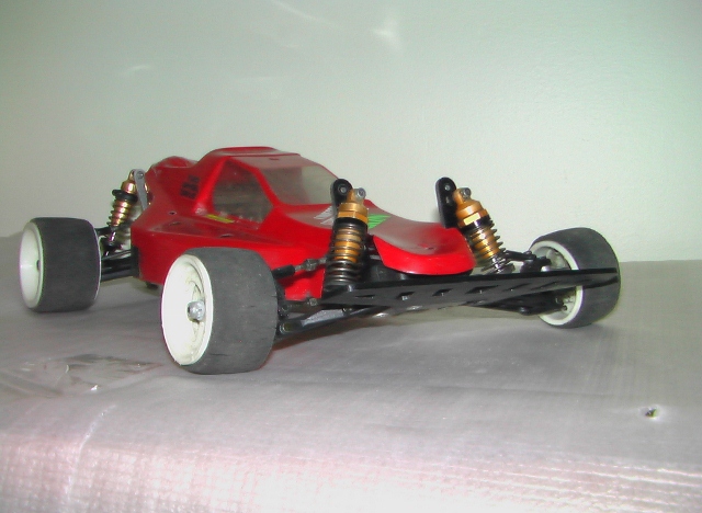

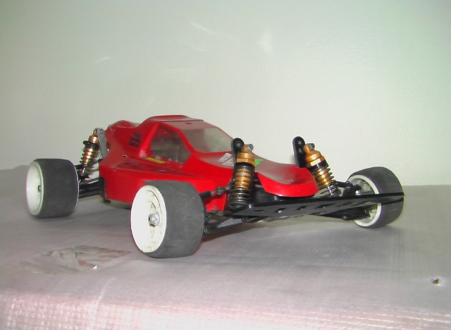

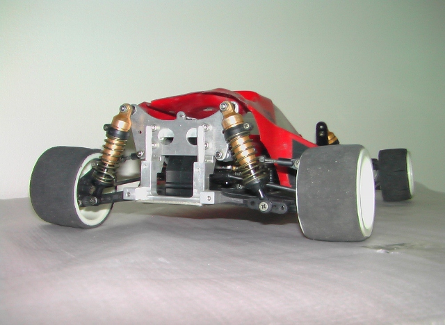

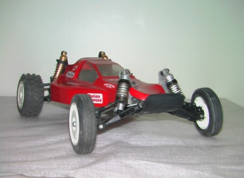

I got hold of my very old low profile foam wheels, kind of dry and cracked :roll:
This is how the car look like 1987 indoor season.

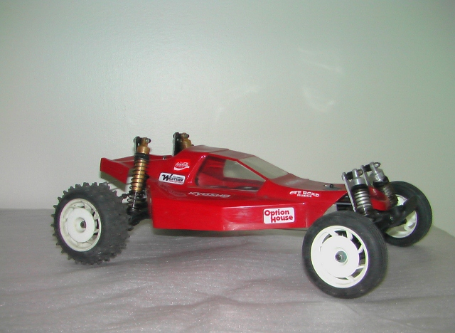

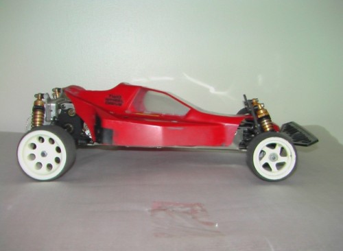

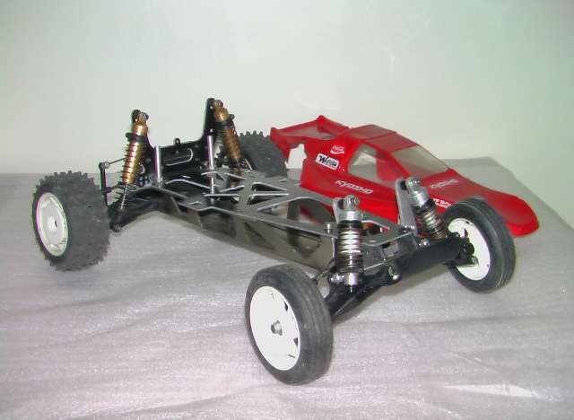

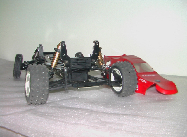

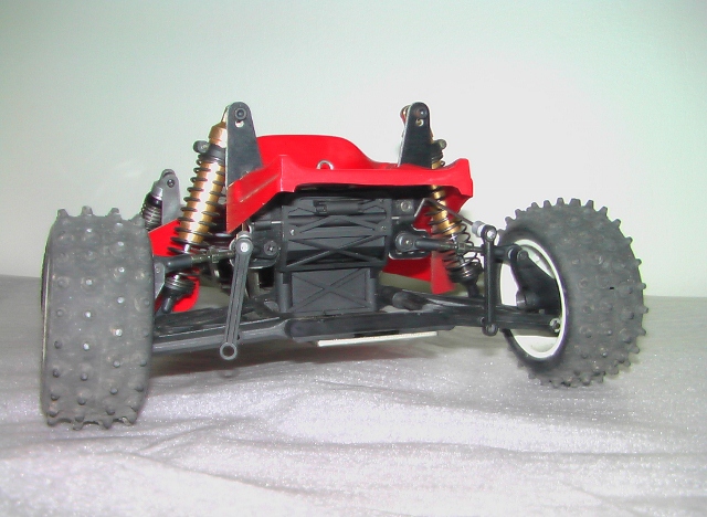

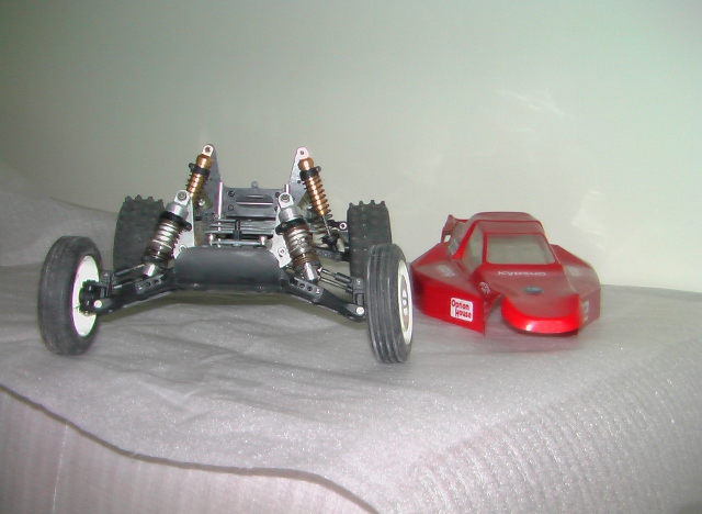

I forgot to finish this 1988 Time has come now. The wheels is just on for the pic. still digging for unpacked parts :roll:

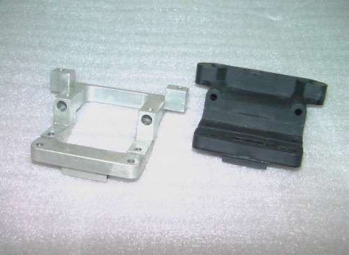

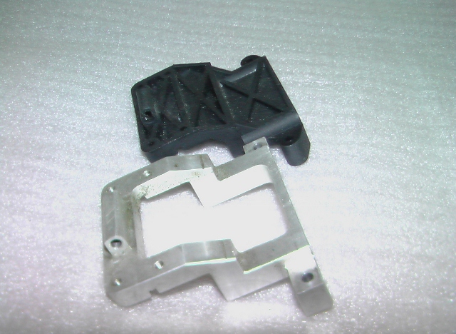

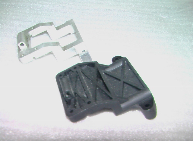

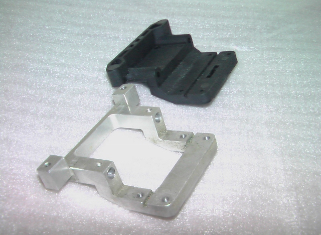

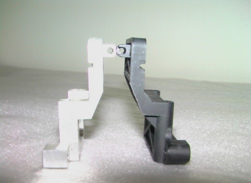

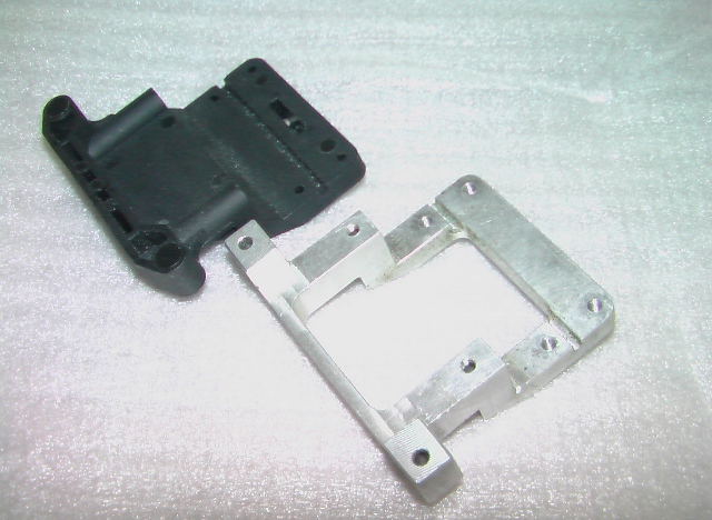

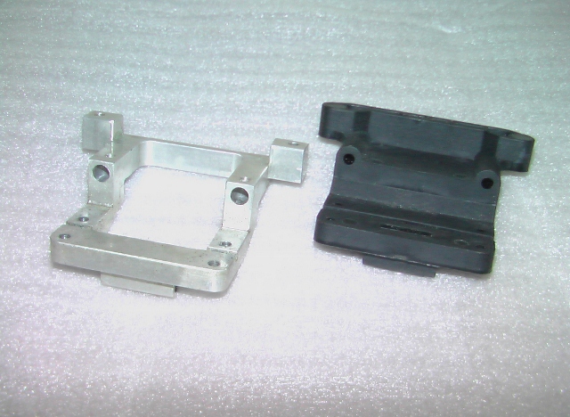

Thank You Sir ;)
That will be a very short list, after consulting the RedBox (lack of memory) i find out only one part is replaced.....hmmmm
and i can't remember why i did it. Must have gone in custom mode again....can't let things just stay like they are.
You made me take it apart and look........that's a good thing ;) The original plastic thing fit...so blame custom devil.
The next thing is running The motor backwards.......electric motors do not know any directions.....lucky me back then.
I did not know the brushless motors know directions, no experience yet. So now i got to leave the hill for a tour to the hobby shop
and get a set of lipos, brushless motor and speed control....ugh. This little beast is going for a ride. o my god.....still got a family pack of gearboxes. This mission cant end well :roll:

Plastic vs aluminum
Plastic vs aluminum

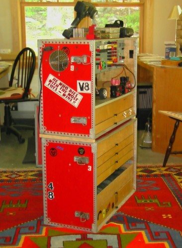

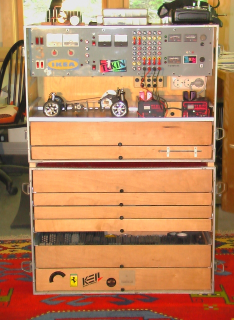

I want to know more about that crazy pit box!!

It's DYNAMITE Power Plant :lol:

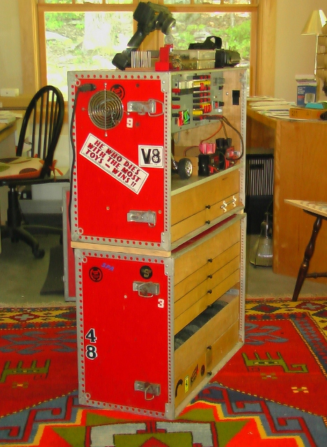

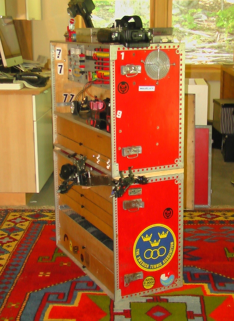

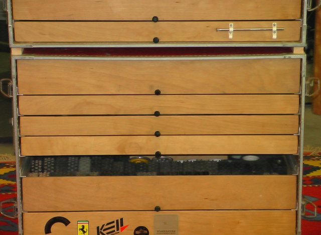

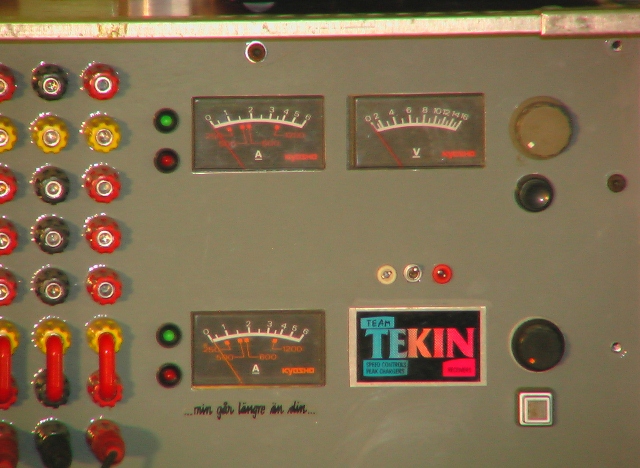

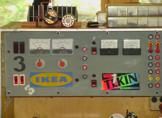

RedBox l & ll The Reveal ;)
When i started RC Racing i used to go with plastic bags as transporting method :oops: Result a trail of parts on the ground :idea:
Get small Box to fit all i need for a race............Ooh my world so much stuff :shock: I need a BIG Box...........If i get this much crap now what will the near future look like :?: Order Two BIG Boxes and stuff them until i can't lift them.
So here it comes folks You don't need to be crazy in RC Stuff But it helps a lot if You are. :lol:
If You still need more description Don't hesitate to ask. There is no stupid questions only stupid answers.
Still missing one drawer ugh.
Built in Kyosho chargers (sweet)
Two Power Supply
Two Power Supply
Cooling air intake
Cooling air intake
Side with Power connection
RedBoxReveal
RedBoxReveal

It's like a portable workbench - no wait, it IS a portable workbench. :D Really cool.
How did you move it? Isn't it really heavy with all of the stuff inside it?

the red stack needs wheels under it.
Could it be you made that alu part 'cause that's what's in the single picture of Joel Johnson's proto-type mid motered ultima?
and to correct : brushed moters are sensitive to reversing. First of all you need to physically change the the timing by turning the endbell about 15 ° and secondly you need to true the collector and put fresh brushes on if it's a moter that was run in the normal sense before, and then switch the leads , or turn the endbell 180° on top of the 15°
PS: I like how you used the mid front carriers, steering knuckles and wheels. I never understood why this wasn't a more popular mod in it days.

EvolutionRevolution wrote:It's like a portable workbench - no wait, it IS a portable workbench. :D Really cool.
Thank You !
So many races with something missing ugh. Getting tired and cranky of missing parts. And i knew i got them at home....far far away.
Solution center kick in....if i bring it all i will at least stay warm....
Heavy....30 Kg or 60 LBS each.
The only thing they don't do is making good coffee :lol:
If i go to a race i can replace anything at least three times.........if that's not enough i go to a bar and cry.
