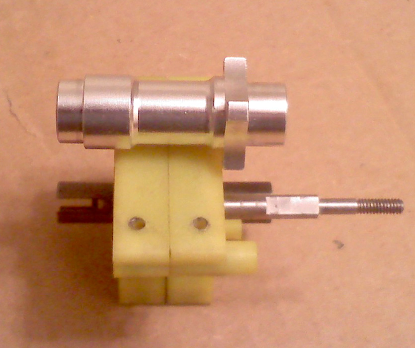

Looks like the one-way I ordered will work out well.Phin wrote:...I have a one-way on order that I'm hoping will work (and was cheap enough to take a shot at)...
It's from a Mugen MTX-4 and as it's sitting in the pic is 21mm from the center line of the MIP Changebox case to each end of the one-way. The pulley on the one-way looks like it should line up well with a pulley mounted on the B4 top shaft. The stock pulley for this pulley is 28t but I believe Mugen has a 27t pulley for the MTX-5 that should fit and with a 12t pulley on the shaft it'll give a 2.25 ratio the same as a standard Stealth trans. I'm still undecided if I'll use the Stealth or use the MIP trans and go for an overdrive set up.
