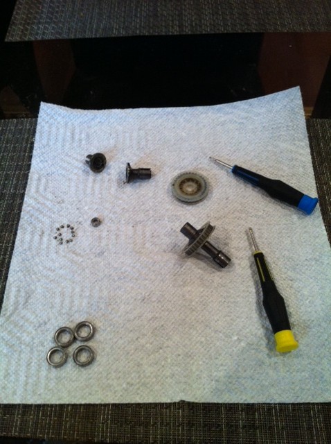

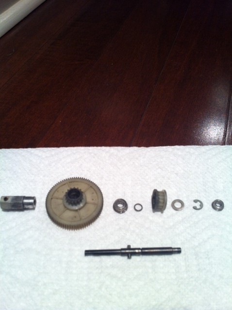

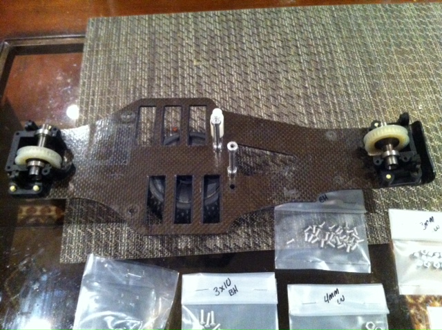

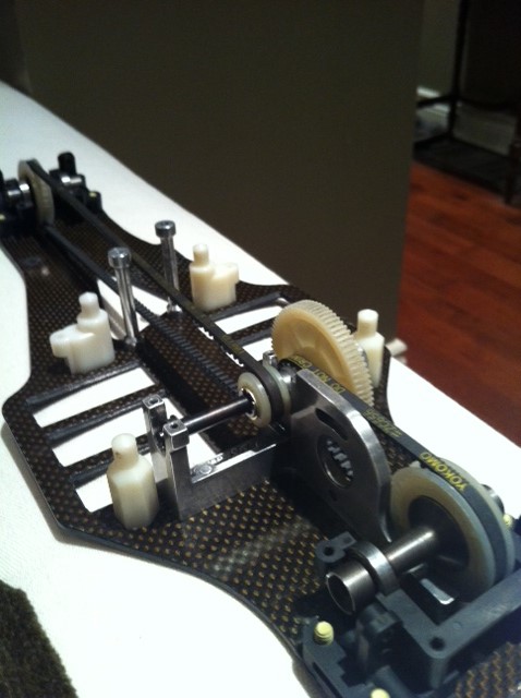

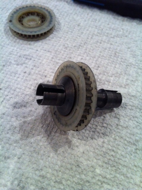

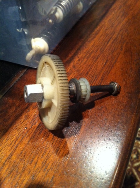

Well with the diffs cleaned up with one rebuilt pulley and one new one it was time to get stuck in to the main drive components...here is some of the progress made thus far...

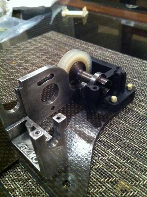

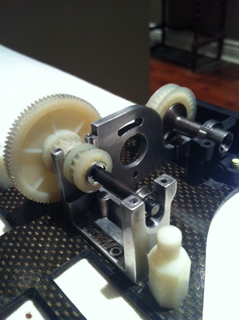

Unfortunately there was some pretty significant wear on the next area so I ended up stripping some parts of an 870c restoration that had stalled (it was my second one so it seemed like it was worth the sacrifice).
Lots of scrubbing and wd-40 later below is what I managed to throw together. Not mint by any means but looks good from a distance

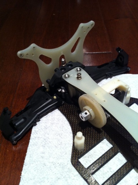

Made a little bit of progress with respect to the rear assembly, threw on the new rear arms, bearings, wishbones etc., all cleaned up, at least to the best I could get them and below are the results.

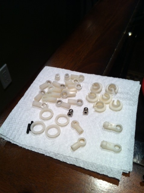

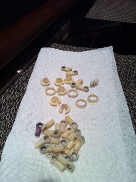

Also started soaking a collection of white bits in a bath of Hydrogen Peroxide, dumped into your standard glass pasta sauce container with a sheet a tinfoil underneither to assist in redirecting light and threw it on the window sill. It has been about four days, i attempt to swirl it around every evening to move the bits around and maximize their exposure and definitely already see a difference. Will post here when I pull them out in another couple of days.

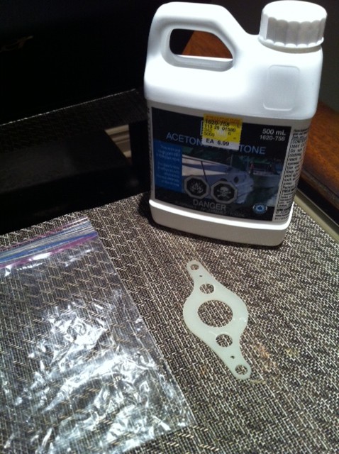

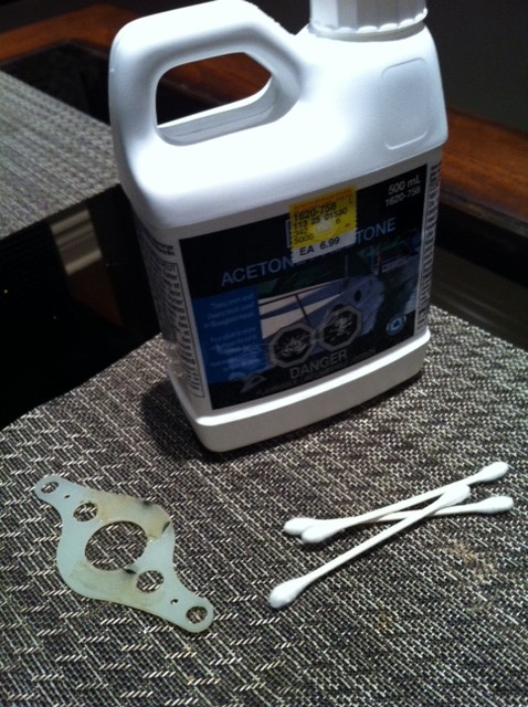

After removing alot of the decayed black foam padding on the white battery hold down's I noticed there was alot of glue residue that remained that a scrub with soap and water was not going to take off. After researching for a bit here on the forum I found multiple mentions of using Acetone and went about picking up a small 500ml jug from my local hardware store (I believe extra strength nail polish remover is also essentially the same thing?) I poured a reasonable amount into a standard ziplock sandwich baggy and dropped in the offending part and waited about 45 minutes? (I left it in a stainless steel sink just in case it ate through the bag, which it didnt but just to be on the safe side). Below you can see that it stripped off the glue residue without issue and appears to have not damaged the part in any way. Phewww

Well the Hydrogen Peroxide definitely had a profound effect on the white bits. Not perfect but definitely not as bad as they use to be and will pick out the best ones of the lot. rinsed them thoroughly and then gave them a quick wash with dishsoap just in case.

Looking neat!!! I've use goo gone to remove stubborn sticky residues and black greasy stains. Works great.
Re: 1994 Yokomo YZ-10 Box Stock Restoration
The yoke is coming along great.. Used the peroxide soak on my parts and a bit of sun and came out great.. I had mine in peroxide for a week.. got 8 hours of sun a day and took them out every night with just a good rinse of clean water.. last day I did the same with a wash in dish soap.. This place is where I got the peroxide info and it came in handy..

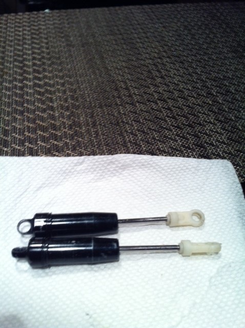

Posting more pictures tonight of where it sits, finally found some used front arms that didn't have holes drilled through them and have started piecing the shocks together.
Quick question, does anyone know the proper length of the front and rear shocks? The heavily used ones I do have for the moment all appear to be sitting at different lengths lol and I don't see any mention of the factory length in the manual. See pic

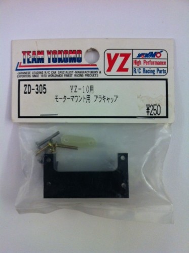

Firstly a Merry Christmas or Happy Holidays to everyone, hope Santa remembered that we all have serious R/C addictions that require sedation every once in awhile lol.
Received an early xmass present with the below coming in the mail, never realized how happy I would be to get a 1/2 inch piece with two small holes in it and a couple of skinny screws
Also found a pair a very lightly worn front arms and am in the process of cleaning them up now, pictures coming shortly.
