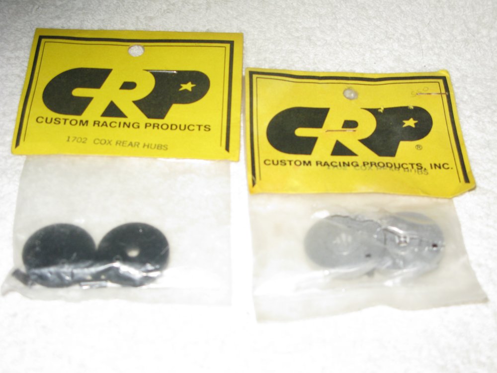

Just went through some parts, looks like crp made them in 2 different sizes.
I have them in black which are small and silver which are large, both have the same header card and part number 1702.
Never noticed this, guess it was for the ss & rr differences in size?

Here's a pic of the CRP 1702's, crappy pic but definitely 2 different sizes.

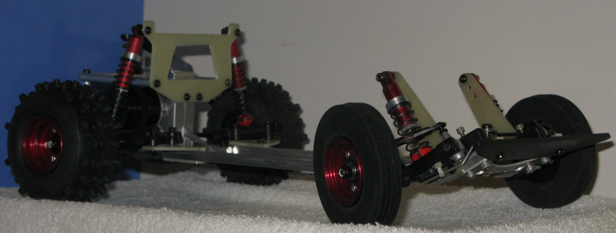

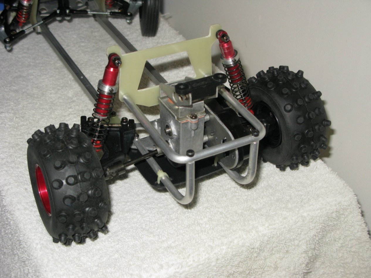

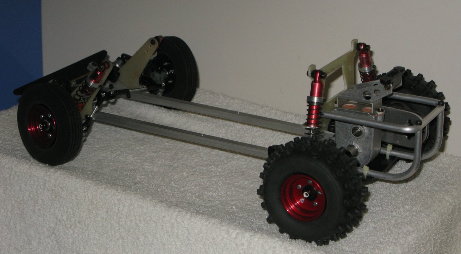

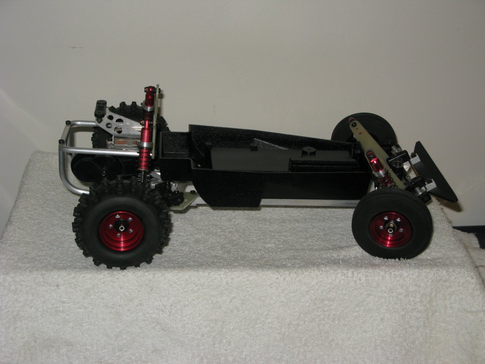

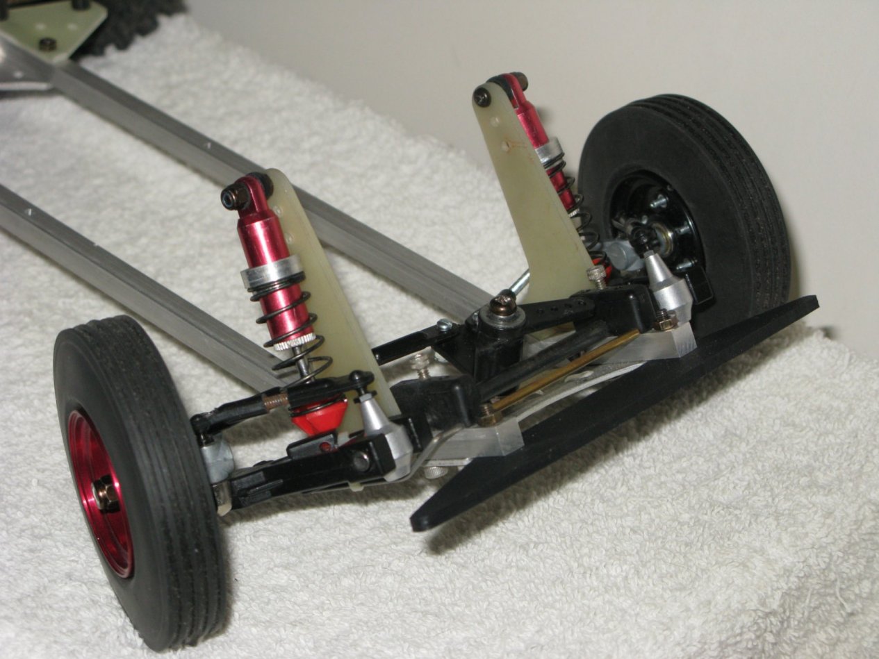

Some updated pics of my buggy!
Still need to soak the radio tub and finish the steering.
Need to edit the original post as to parts used, a lot changed.

Your Scorpion are coming along nicely my friend, I rely like your red wheels!
Cheers
Lars

That looks freakin´COOL!

Very cool looking. That is turning out nicely

Looks great Mike!

scootmike wrote:Here's a pic of the CRP 1702's, crappy pic but definitely 2 different sizes.
Could it be that the black ones didn’t give enough room between the wheel and shock? Or are the natural made for fitting Fox wheels or similar and the black for SRB wheels? Just thinking out loud... :D

scootmike wrote:Just went through some parts, looks like crp made them in 2 different sizes.
I just compared my silver CRP adaptors to some RR and SS wheels and I think that the silver ones are meant to be used with the RR wheels. When placed together I noticed that the roll pin lines up exactly with any one of the five screw holes in the RR wheels. The SS wheels screw holes are a smaller diameter and don't line up with the roll pin in the silver adaptor. CRP didn't supply any instructions, but I think that once you have your wheels assembled you take out one of the screws and drill the hole to the same thickness as the roll pin. With the adaptor on the Scorpion's axle you then put the wheel on making sure that the roll pin fits in the enlarged screw hole thus ensuring that the wheel dosen't spin on the adaptor. Are the roll pins in the black adaptors closer to the centre hole of the adaptor when compared to the silver ones? If so I'm betting that the black ones are meant to be used with the SS wheels. That would explain why there are two different sizes.
Chris.

Thanks for the replies everybody!
I also tried the larger silver adapters with rough rider wheels and they do fit.
Crp wasn't too much for giving instructions :D
I'd agree that the silver's are for the rr and blacks are for the ss.
