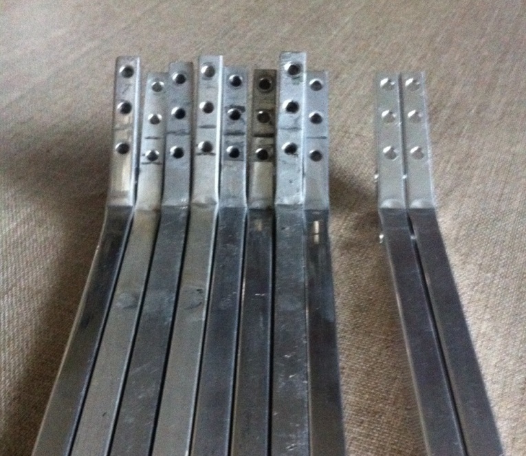

The biggest problem when you start to renovate an old Circuit 1000 car is the aluminum chassis bars. Those are always bent one way or another… So a few months ago I got hold of brand new ones from a guy I Germany almost free. :mrgreen: This will be my blueprint chassis bars for the future! You can bay repro from pargu2000 without ruin yourself, but original is still original!
When you straighten out the chassis bars, take your time so you don’t ruin them for god.
The two on the right is the new ones.

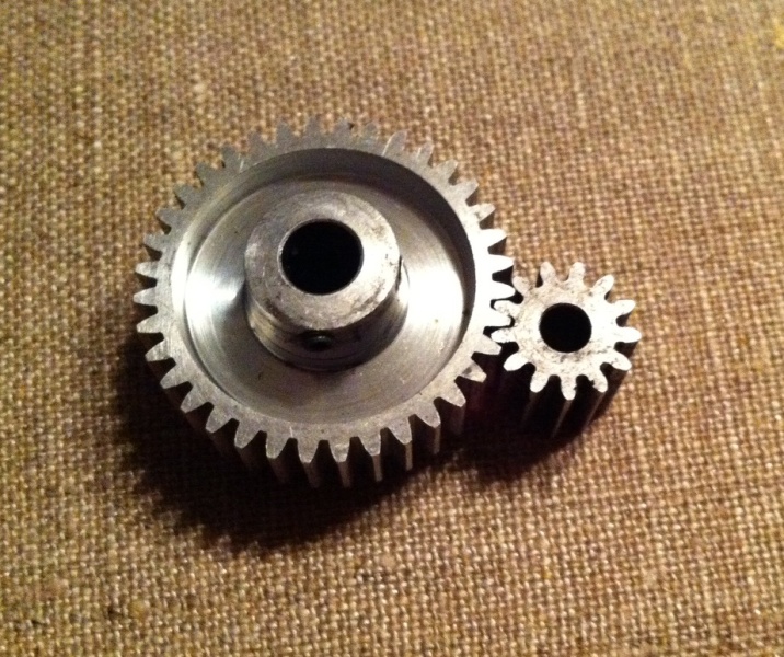

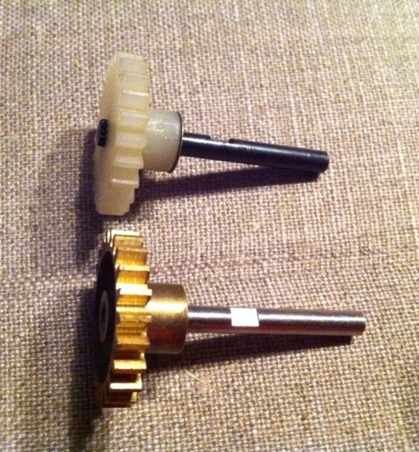

The earlier Scorpions had no differentials, just a plastic gear. I have some prototype metal gears from CRP. But at the same time Dirt Burners realest a ball diff to the Scorpion (if you have one for sale, please send me a PM). When the Turbo Scorpion was realist in 85 it had a gear diff installed, and you filled the gearbox with oil… I will use grease instead this time. I remember my sticky gearbox from way back, oil mixed with dirt… As usual when it comes to install gear diff, do not forget shims it rather tight if you want it to last.
Prototype metal gears from CRP

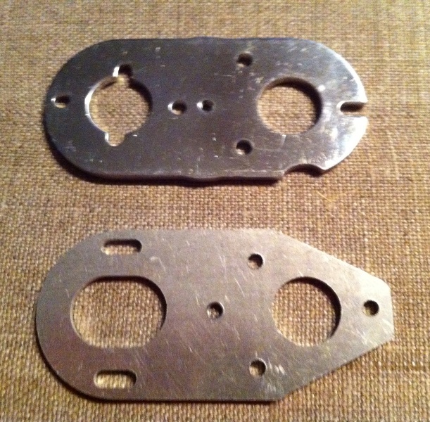

The motor plate on the Scorpion is no good for a racer, you have two alternatives! Low or high gear…
A few racers did their own modification, but CRP made a motor plate #1708 that allowed you to change the pinion. So this will be my choice for this racer…
On top is Kyosho Scorpion original motor plate
CRP has a bras outgoing gear #2108 that they still have for sale. But the Scorpion is made out of plastic, and it’s less mass to get in motion and therefore faster acceleration… my choice for the racer.

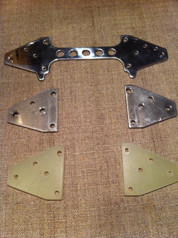

The Kyosho Scorpion have trailing rear arms, they is mounted on two aluminum plates. Do to the problem with lost dog bones, the Turbo Scorpion got one aluminum plate instead of two together with Assault and the Advance buggies. In order to adjust to in and to out I chose CRP’s #1024 in fiberglass (still for sale). And I used CRP’s trailing arm pivot #1701, instead of the original in aluminum. Maybe not the right chose for a racer, but I’m a sucker for aperients sometimes…
To cope with the lost dog bones I have chosen the rare CVD’s from CRP #1706. Another way to prevent the dog bones to fall out is to mount a few mm of silicon tubing on each side of the dog bone too keep it centered.

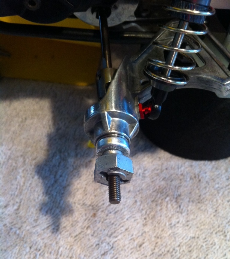

I have used CRP’s front arm shaft #1707 (still for sale) that are 8mm wider than the original shaft. This gives me a change to widen the front if I want to. This shaft is bit sensitive for crashes and big jumps, it tend to twist. To prevent this I drilled two holes in the arm shaft blocks that I thread for set screws in an attempt to keep in place. Live test later on will give me the answer if I have succeeded…

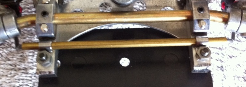

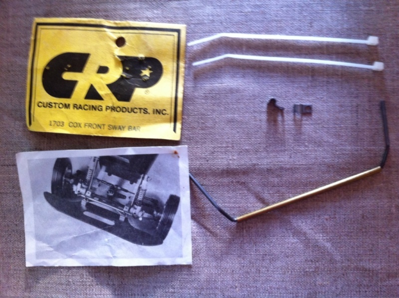

In my look for hop-up I came across a rare CRP part, at least it’s what I think. It’s a sway bar NIP (#1703) to my racer; I had only seen a bad picture of it before. This is a simple construction! The sway bar runs through a bras tube, the ends attaches with straps to the front trailing arms. But I think it will do the job!

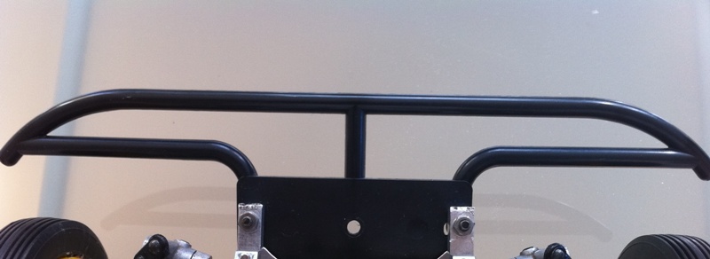

To protect the sensitive Scorpion front I chosen a Pro-Line bumper made for the Scorpion and the RC10 #4504. Pro-Lines bumper cover the whole front and is much more absorbent then the original Kyosho bumper.

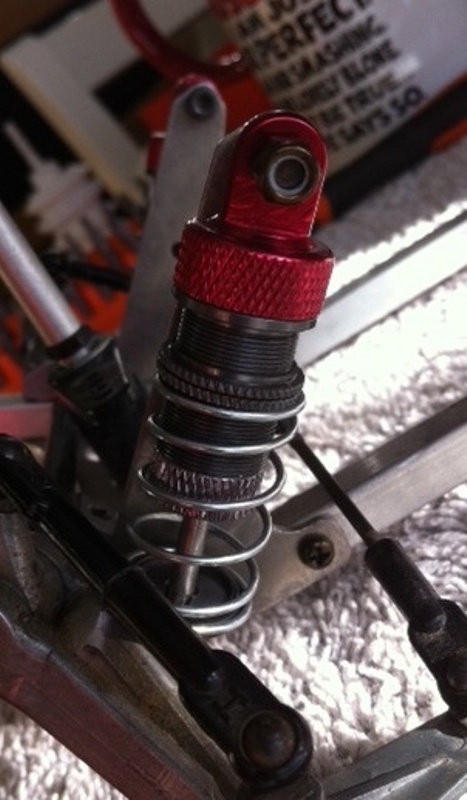

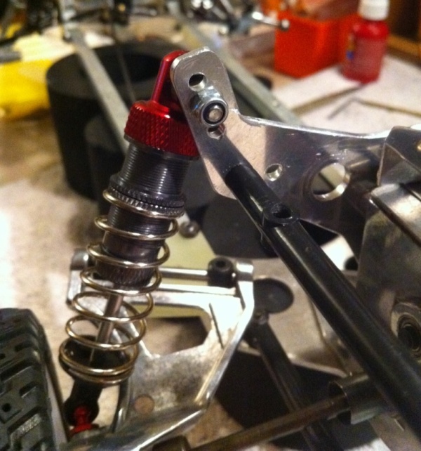

The dampers are relay important; my intention was to find some nice aftermarket ones. But I don’t know what aftermarket dampers there where at that time (-85) except for RC10 shocks. So I would be grateful for any input in this subject!
In the meantime I have (cheated) chosen a modern aftermarket damper from Yeah Racing. They have an 11.8mm damper in various lengths, so I chose 60mm for the front and 70mm to the rear. Scorpion’s damper is 10mm in diameter, so no modification was needed on the shock towers. But I couldn’t help myself; I have to make a new rear tower… I made it about 10mm taller and drilled two extra holes. This will gives me a little to play with… and I might make one for the front later on.

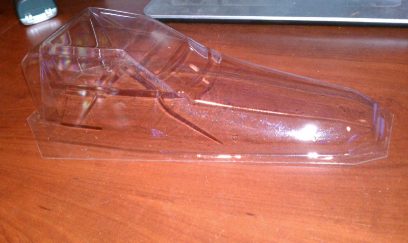

Time for the white Turbo Scorpion tube to be mounted, but this it’s not an original tube. I came across a guy I Germany that was working with laser sintering technique (http://en.wikipedia.org/wiki/Selective_laser_sintering). He had made a few repro tubes and he has made some modifications. The best feature is that you can screw down the steering servo; a thing Kyosho engineers should have done 30 years ago. :lol:

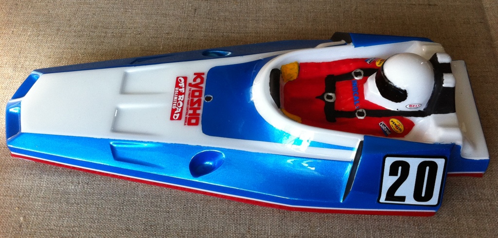

Now I’m at that point that I never got the hang of, painting a lexan body! I can cope with one color, but when its two colors it starts to get complicated, and I was thinking of using three colors… Historically I have always left that part to guys knowing what they are doing! 20 years ago I even purchased an air-brush, but I never get around to opening it. And now I don’t even know where it is…
But what the heck, I will give it a try. I went down to my local hobby store and purchase three rattle-cans! My intention was to paint a box-art body, blue, white and red. White and red no problem, but the blue color I ended up with was Renault Alpina blue. What do you think guys, not bad for a novice?
After market body’s for the Scorpion is wary rare and hard to find. A few months ago I spotted a NIP McAllister body to the Scorpion on the bay. I decided to buy it to any cost; I set my top bid to $260… yes you read it right! I was in the lead with $125 until it was 5 seconds left, and yes I ended up as the first looser… The next day I contacted McAllister asking if they still have that mould, but no… :?
The reasoned I wanted that body is to get rid of the cage and aluminum roof. I think I will make my own mould and design next winter! :wink:

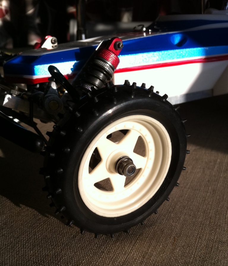

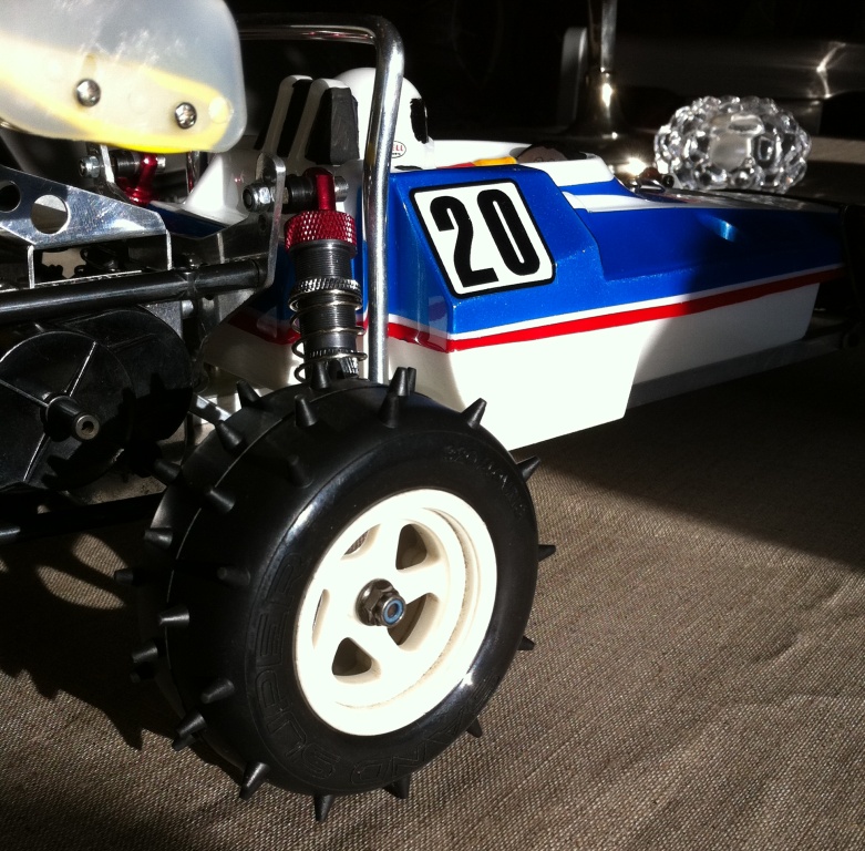

Now I get to a difficult part for a 26 year old runner/racer, the tires! The Scorpion rims are 1.5” at the rear and 1.9” at the front. To find new tires could cost you a fortune and some time to find. And if you find some tires, they hard as “hockey pucks” (Swedish expression) and no god on the track!
A solution is 2.2” rims and modern tires, problems … some yes! Around 95 manufactures went from having bearings in the rims to have the bearings in the wheel axels at the front. But the old stile front rims are still produced, so this isn’t a problem. The rear rims are a different story, you have to do some modification on the Scorpion first before you can mount modern 2.2” rims.
The Scorpion drive washer is round and not a 12mm hex, and that’s what you need. I purchase ”HPI’s Racing Locking Hex Hub 12mm” and the some from AXIAL. The deferens between this two are the color. This is not the perfect solution, but still a solution that works. HPI has another type (more expensive and purple) that I will test later on ”HPI Aluminum Hex Hub Clamp Type 12mm” (Ordered).
My attention is a 26 year old racer, so I didn’t chose 2.2” rims at this time. For the rear rims I have chosen Optima 1.6” and newly produced OT-30 tires from Jose in Spain. I even tried to mount on the Scorpion 1.5”, to my surprise it actually works fin on that rim to. The different between Scorpion’s SC-84 Sand Super and Optima’s OT-30 Sand Super is that the SC-84 is slightly wider than OT-30.
At the front I have original 1.9 Scorpion rims and Amark tires still sold by CRP for $10.
