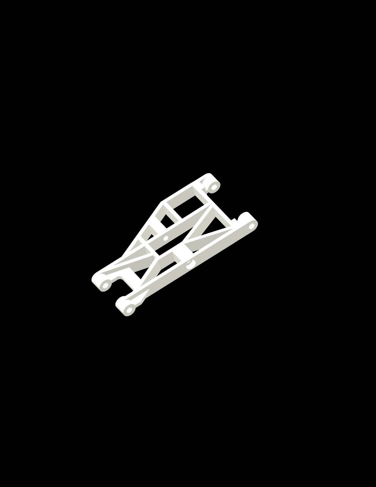

I just thought I'd throw this out there as a teaser.

Pretty interesting stuff going on in here. Looks great!!!

After modeling it up and working on the front bulkhead, I can in fact confirm that the arm length, shock mounting location, and even inner hinge pin to inner hinge pin distance on the bulkhead are in fact identical to the current car. The inner hinge pin from the RC10T and the outer RC10 rear hinge pin are used on the Stealth car front arms. Very cool!

How do you know the dimensions of the stealth car?

You look at pictures of different views of the car. Certain things like hinge pins and e-clips and screws are known to be a certain size so you've got some scale reference. A big help was a Cliff Lett interview where he mentioned that the modern AE suspension geometry and shock mount points were first used on that car. This allows you to verify your measurements and in turn verify his statement. The odds of getting everything absolutely identical is extremely slim but it should be close enough and be accurate where it really counts. There will be a couple of very small details that I'm going to change from the original but they'll be improvements. Remember, those cars were hand built so some things were a bit improvised.

Very interesting stuff :) Nice work fredswain :)

duuuudeeee.... that's just mean! 8)

I wonder how close your arm is to the injection mold that Jake was making...
