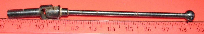

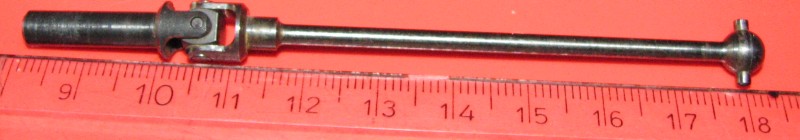

The ball on the dogbone end of the evader driveshaft is to large to fit in the outdrive of an associated gearbox.
I once tried installing my spare B3 gearbox into my evader BX pro. The stealth copy gearbox of the evader runs larger diameter outdrives compared to associated.

Hey Doug, thanks for that info.
If it won't fit the asso outdrives, then there's no way it will fit kyosho or yok outdrives: they are a tad smaller even.
I won't need other dimensions anymore.

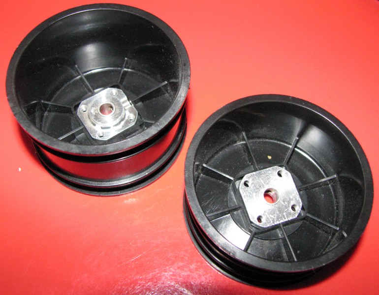

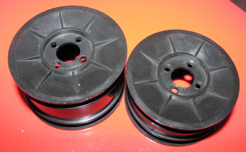

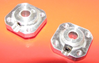

is this enough?
note that the offset is far different from the older YZ10 wheels.
If anyone has/knows of universals or CVD's that can replace these, but have a 5mm axle with pin hole and 4mm tread on the side below 10 cm... Please make a similar pic for me.
