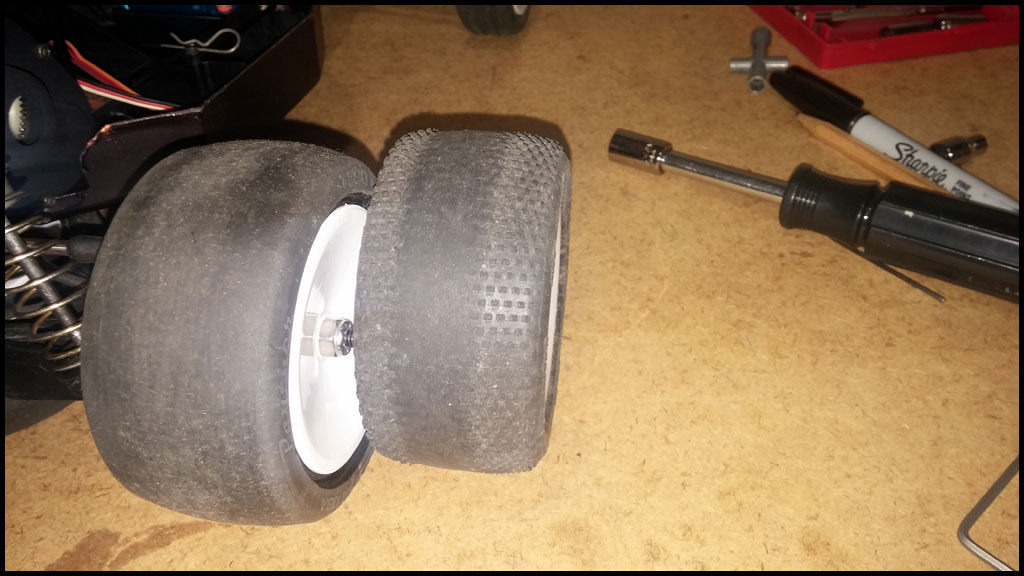

Other than crashing and breaking arms and stuff I haven't ran into any mechanical issues yet...I'm running a 8.5T 4000KV motor with a 3S but I'm only geared 81/30. I do have a 5.5T motor sitting on the shelf but I need to sort out the tire issues first...
The Panther slicks I got work well. They still grow but not nearly as much as standard pin style rear off road tires. Stupid weather here so I'll have to do more testing first before officially deciding if these will be the tires I use...The foam tires on the other car are awesome. I love foam it's what I'm used to so that's no surprise. That's all we used to run back in the day...
Still trying to stay with a 2.2" rubber tire for the speed run car but we'll see what happens...Also trying to stay away from modifying the inside of the tires as I don't want to add rotational weight...but if that's what it comes to then so be it...will be tuning in here to see how you make out...
Pics attached. Slick VS pin style rear - you can see how much they were growing and wearing...lol

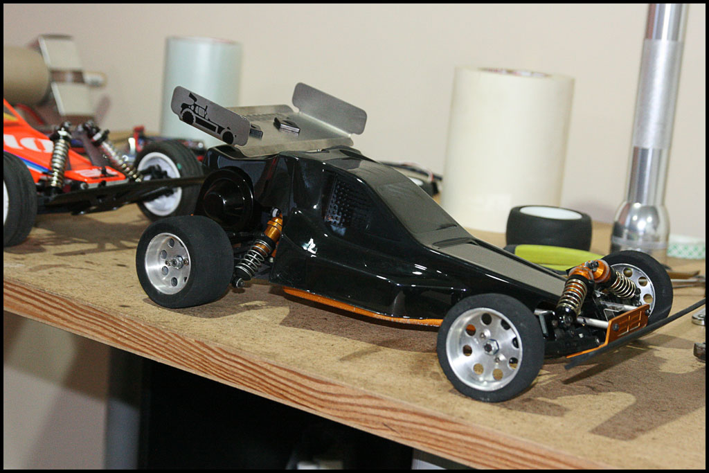

Other pic is the new foams on vintage Mini Mags...(Orange car in background is actually the speed run car)
